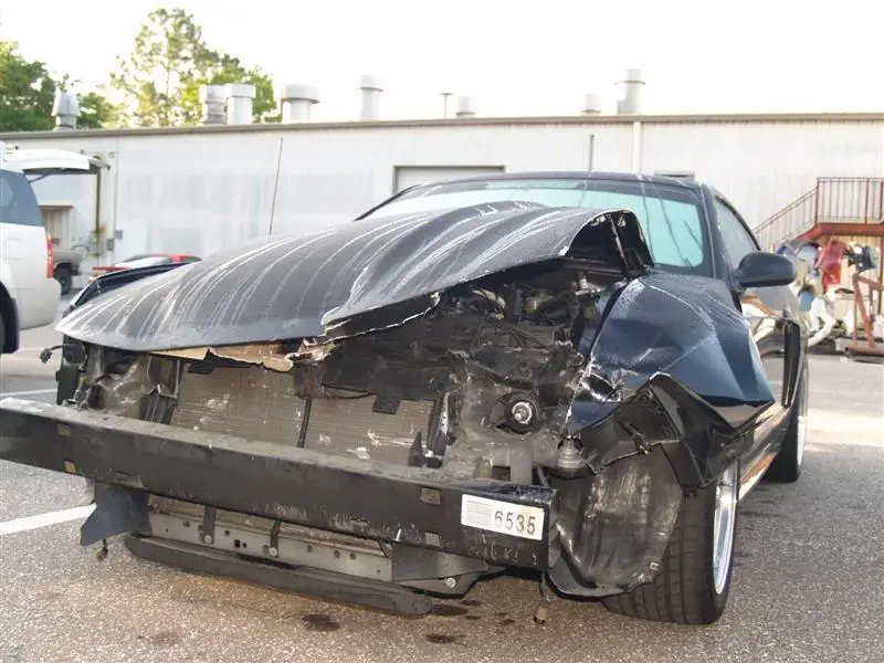

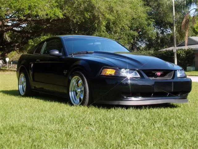

I painted mine (2 weeks before it was totalled). :mad:
It came out well, only a couple minor imperfections that only I could notice. Mine was a color change though, so there was a lot of prep work as the previous owner had thick stripes on it with even thicker pin striping. I spent about 4 weeks, a couple hours each night, doing the prep work. (Painting is really 90% prep)
I used my lil 15 gallon compressor and a HVLP gun. I did all the primer will rattle cans, but laid down the color and clear with the gun.
I built an 10X10X8 spray booth with PVC, plastic drop cloth, duct tape (of course!) and a couple of (HVAC) air filters - totalled about $40 bucks. I used a couple fans I have in the garage, one on each end of the spray booth, one pushing air in (thru the filter) and the other fan at the other end pulling air out thru the air filter. It worked very well.

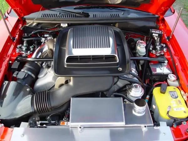

Somehow those Redline Tuning hood struts were undamaged - gotta give props to those folks and their product. I sold those and now have the bling-bling stainless ones on my new ride, a Mach 1.
OoOoO... shiny. are you telling me those struts were perfectly okay? wow thats amazing! WHere you okay.
