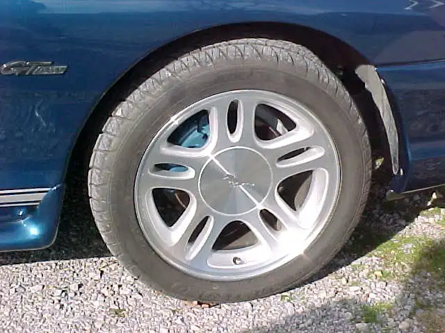

I love the painted caliper look. But I would worry about using spray paint because you can never really control all the overspray, and if there happens to be a gust of wind at the wrong time it would really suck. I cleaned the calipers with alcohol and made sure they were dry. Then I brushed it on carefully with a small brush. It took about 15 minutes total for each caliper.
First I tried automobile touch up paint, but that stuff was so thin it would have taken 100 coats to get enought paint on it. Then I used regular gloss enamel from the hardware store and it has been fine for almost a year now.
Here is a pic of what it looks like now, about 8 months after doing it:
Also, they weren't clean when the picture was taken so it actually looks better than this normally.

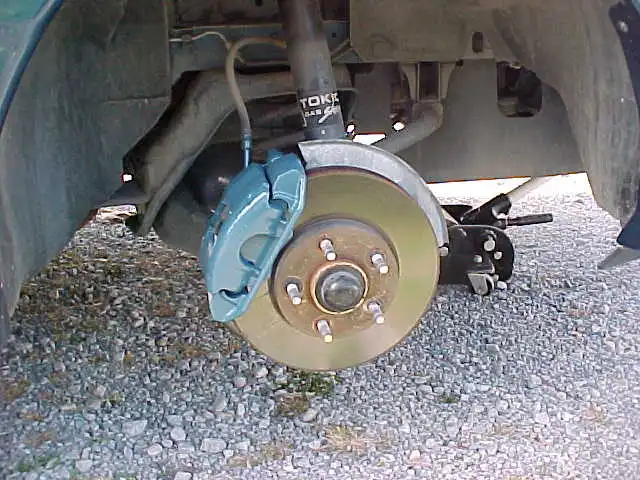

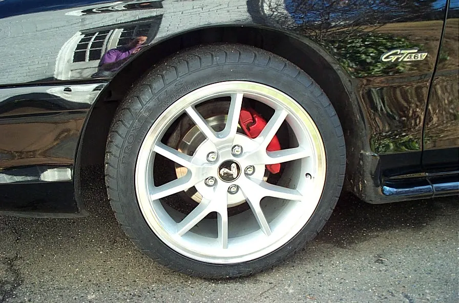

Plastikote high temp enamel with ceramic. :nice: Painted them last Fall, and they have endured the salty roads like a champ! Sorry, the fender wells were a little nasty.
