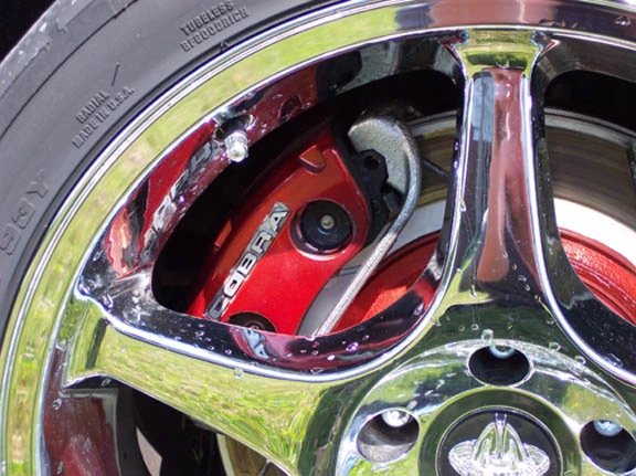

You simply paint the whole caliper, then use some fine sandpaper and carefully take the paint off the raised "Cobra" letters...takes 2 minutes and looks better than new. I also used the High Temp engine paint, 3-coats red, 2 coats clear. I had the calipers off the car at the time which made it a snap.
Here's a pic. Hope it works!
