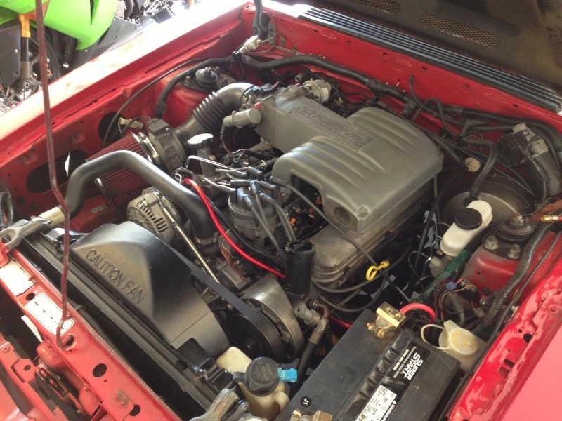

I have a explorer intake I'm installing this week. When I got it, it was nasty and covered in grime. I cleaned the crap out of it with chemicals and a wire brush on a drill. Painted it aluminum with VHT spray paint from autozone. Gonna do valve covers as well. The lower is painted already, just don't have a pic with me.
Before:
Engine bay:
Upper painted:
Check out my build thread as well, I just painted my upper, lower and valve covers. I did them all in Duplicolor Aluminum to get a fairly factory looking appearance. I agree that powder coating is one of the best when it come to durability, I just didn't have a local source and didn't want to spend the coin to get it done.

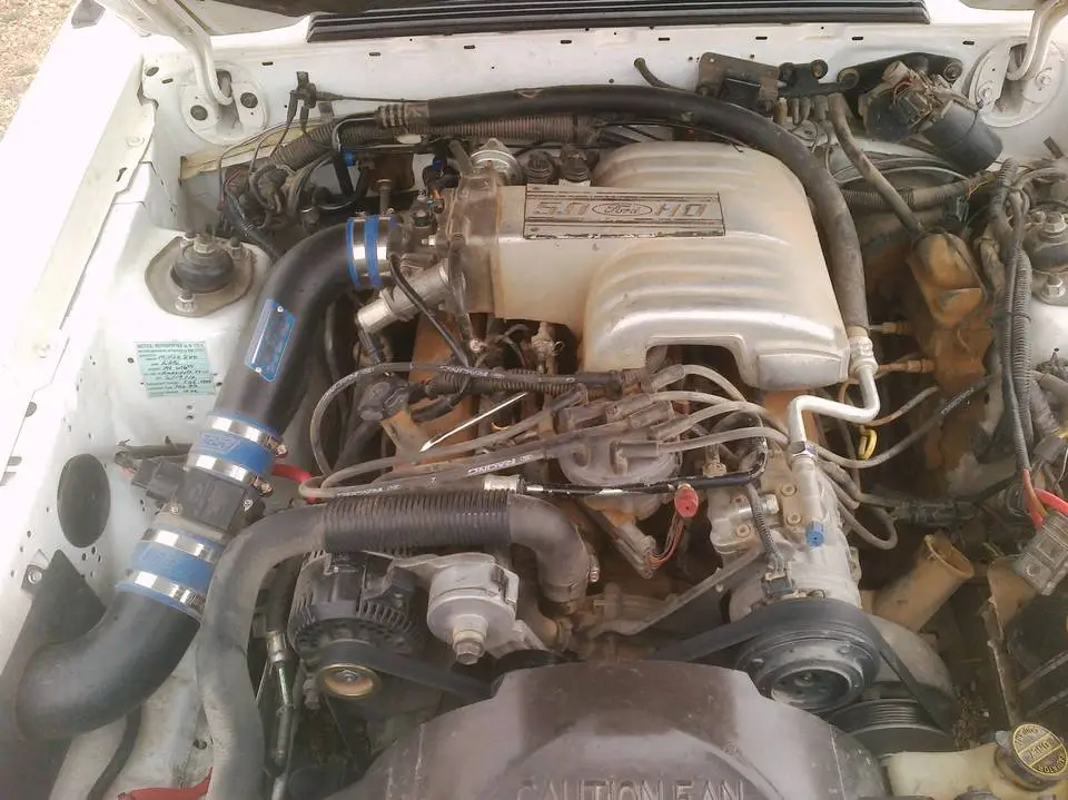

Here is how she currently looks:

Also, notice my brake fluid holder, why does it look like that? All the engine bays I have seen have a clear one with a cap?
I was gonna ask when the last time you went mudding in southern Oklahoma was till I saw your location, CLEAN that engine bay too man, not just painting those parts. That said, given all the red dirt and dust storms in Lubbock, I'd go with silver instead of black as you will NEVER keep them clean longer than 10 minutes.
Yeah, those plug wires have only been in the car one full day. Speaking of, what is the proper way of cleaning those? Yeah but silver is too shiny, lol.
