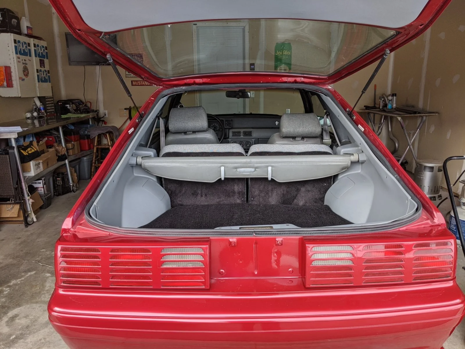

The LMR paint works good but make sure the prep is done well. No primer, just paint directly on clean panels. $600 for rear interior plastic is crazy in my opinion.

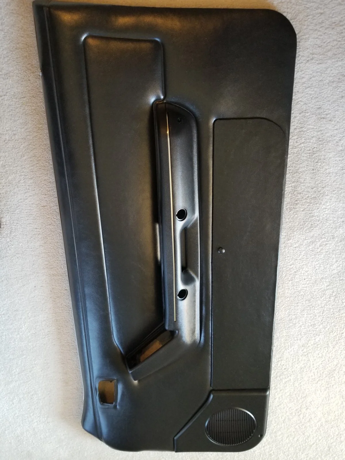

In this picture my arm rest assembly is painted. No way you can tell.

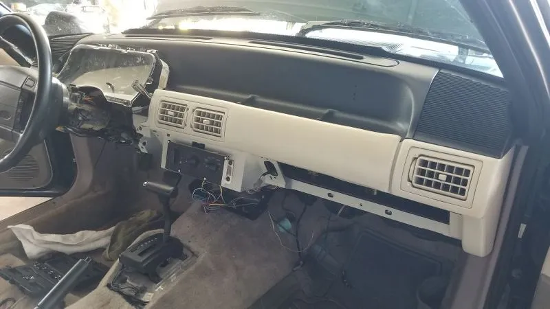

This picture of my 7up Convertible I replaced the dash. It was gray, I painted it and again, don't think you can tell.
Chris
Wow that looks really good, nice work! Should I just use a soft Scotch Brite pad with Dawn dish soap to clean it?

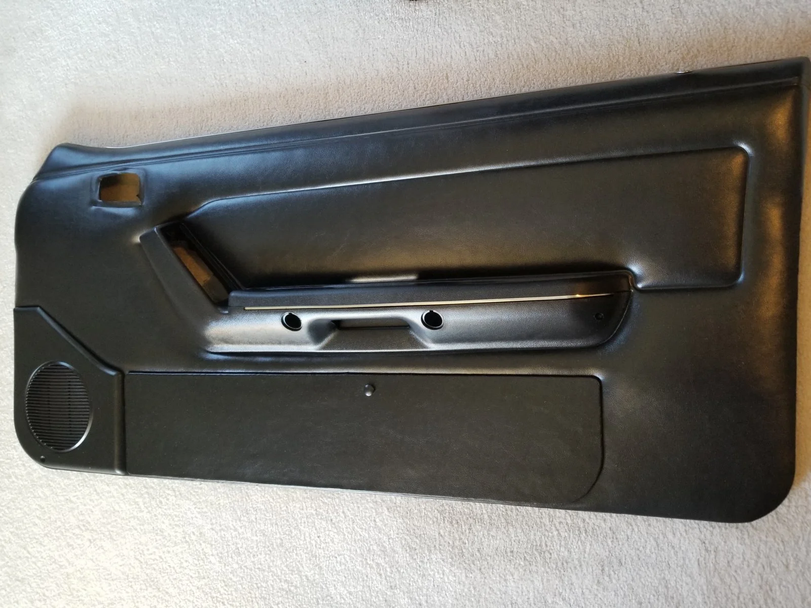

I redid my interior when I got my car. I ended up using a SEM paint color that I liked better than what LMR offered. I believe that the LMR stuff is just SEM anyway. You can buy it cheaper than what LMR sells it for. The only problem I have had is the paint rubbing off of the arm pad. Not sure if I just didnt get a good coat on or if my prep was bad. I cleaned it with dawn and a scotch bright pad. You can look at pics of my car shortly after I finished it I'm my thread Therapy Car. Looks great. There is a promoter that SEM offers that might help with adhesion.

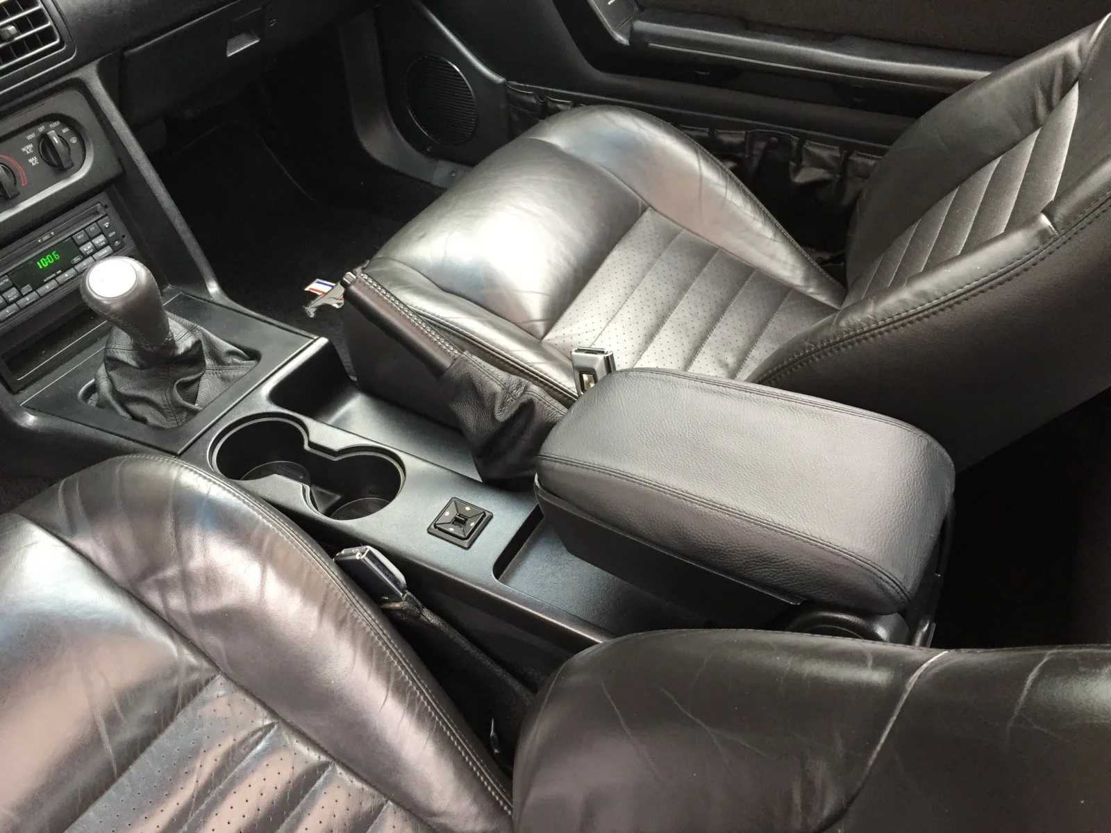

SEM Landau Black 15013 is probably the closest you'll get to OEM black. It does have gloss. The black interiors suffer from the same issue as the grays in terms of 30 years of fade. SOme panels dull up, some get an almost blue shade, and some still have some factory luster. Doing a major panel like the rear quarters prob will be OK because such a large area will be the same shade, but when you do small trim work like a console top lid on a factory black console body, you might get some slight mismatch issues.
For example, I painted the cupholder console, but the body of the console is OE black. You can see the contract between the two. It's not obvious, but it's there. If it bothered me at all, i'd spray the console body as well. Spraying OE black parts black again is waaaay easier than spraying a different color.
However, the adhesion quality of the paint has been excellent. It's been 2 years and i don't have a scratch or wear. I put my phone in the console and drive with a cup in there and there have been no chips or scratches. Of course, this was maybe 1K miles of driving. I'm sure after 50k miles it would show some signs of wear.

Looks great, thanks for the color name and part number, I'll be ordering up a few cans. Currently, my interior black doesn't all match. I have the cup holder center console and its black. I never painted it to match the rest.
The worst parts are my door arm rests and the quarter panels.
You can paint the armrests, but I would order new armrest pads. That soft pliable material may not hold the dye long nd it's a very high wear area

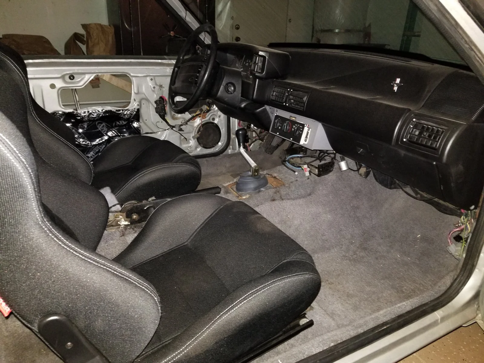

I like those seats, did you have to make a custom bracket for them?, also what seats did you end up buying and putting in, also any clearance issues?
They are Cipher Auto racing seats made in China. They came in the car when I bought it 6 years ago. I had them reupholstered in OEM style fabric. No clearance issues and I'm over 6' tall. The following YouTube video, 50 second mark, will give you a good glance at the interior and seats.
