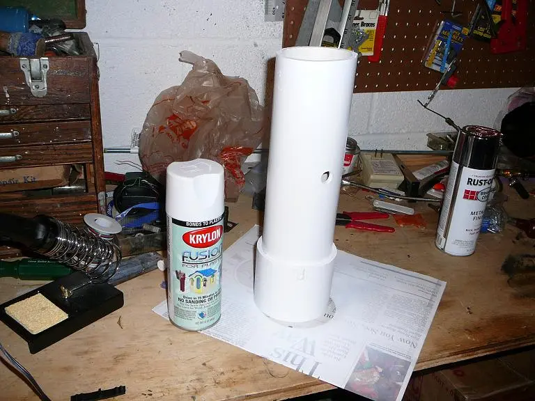

with the "primer"

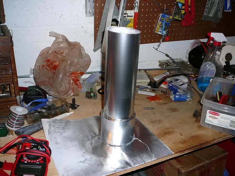

with the silver
i think it needs a couple of coats of clear coat ...
