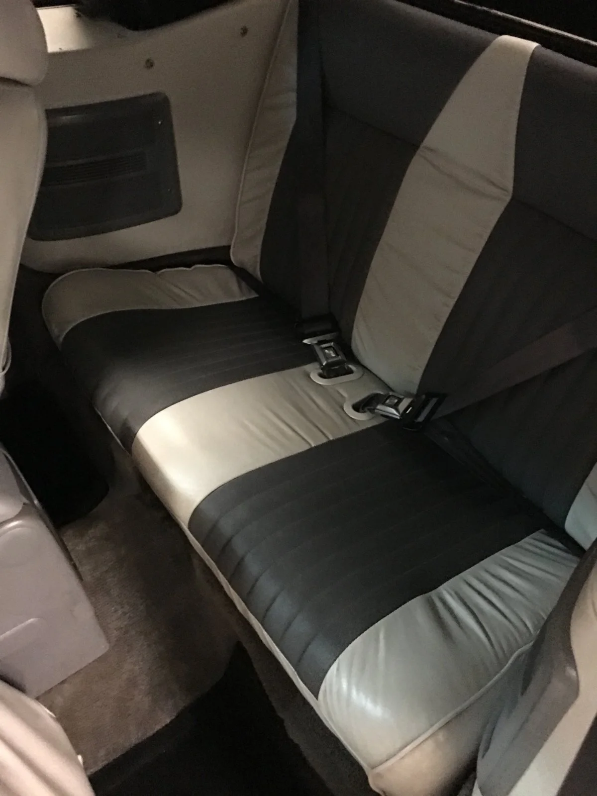

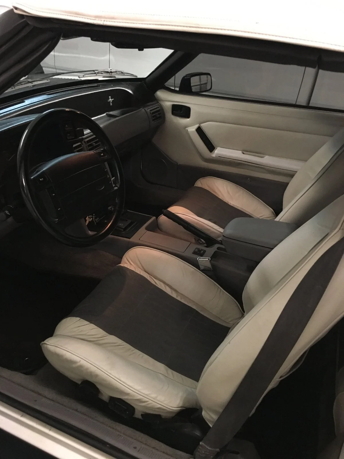

Have a 93 LX 5.0 convertible, has the white (non-feature car) interior, which is now pretty dingy. Thinking of getting new grey door panels, and changing out the white interior one step at a time. The rear panels (where the rear speakers are housed) are in pretty good shape, but I'm a little worried about rattle canning them grey. The OEM finish seems to be some type of real thin vinyl, different than any of the other interior panels. If anyone has ever changed the color of these, has the paint/dye laid down and held up ok? What type of paint did you use? Anything to watch out for before I dig in? Any input appreciated.

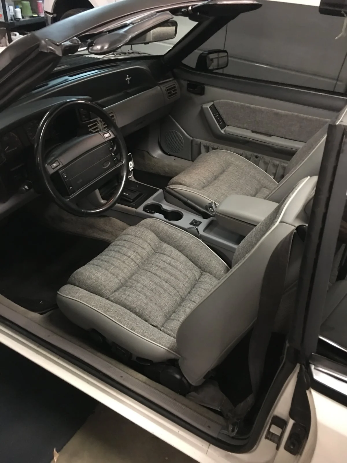

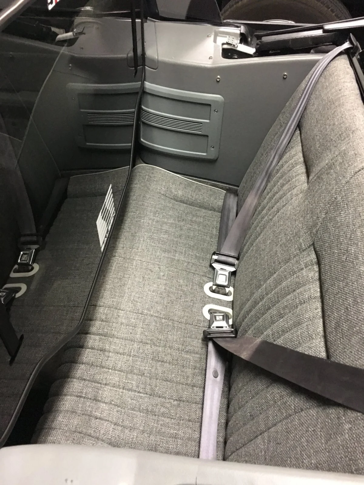

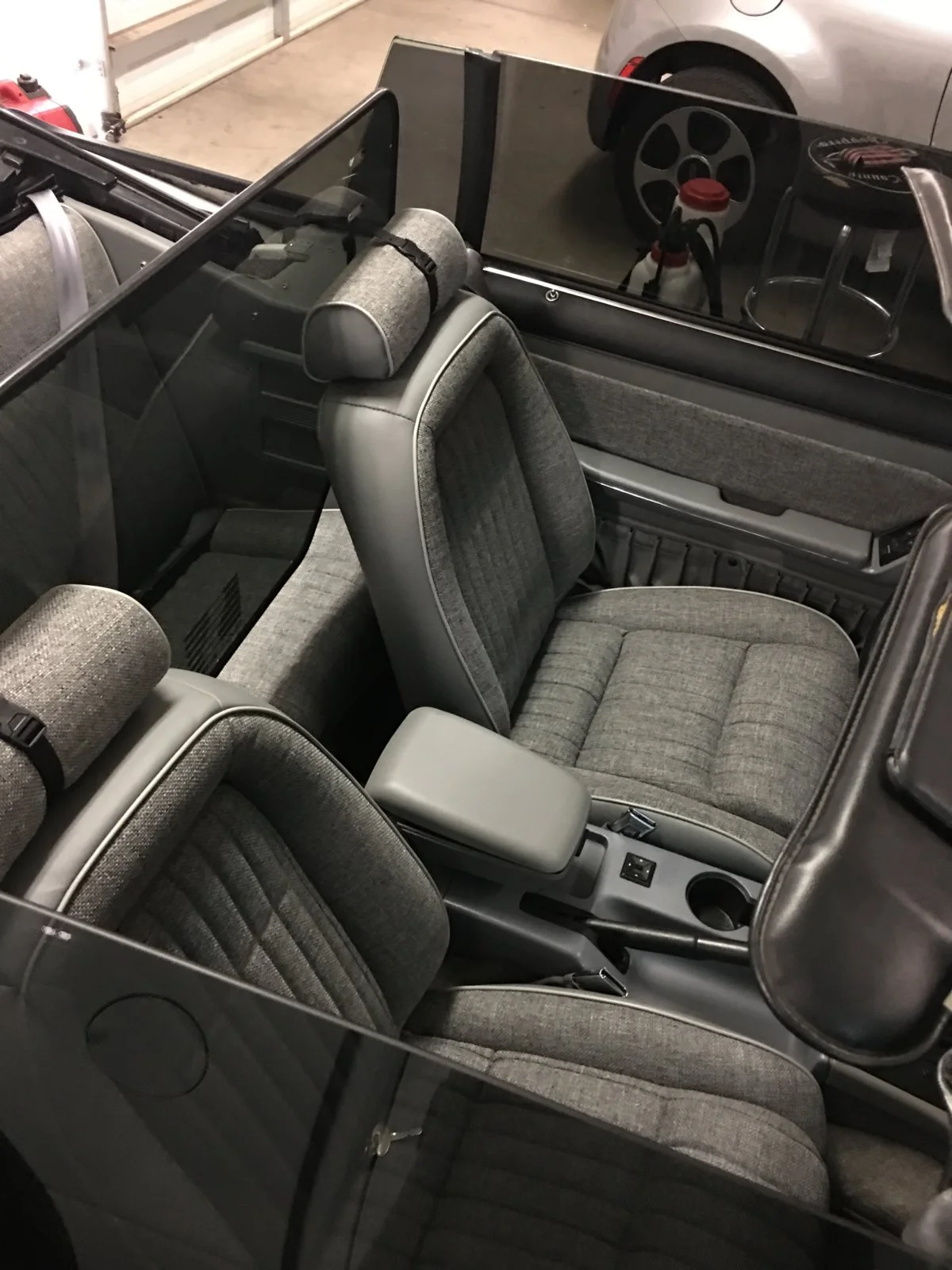

Finished my interior de-whiting/re-do, at least until I have an appetite to take something apart again. Re-dyed my rear panels with SEM Presidio, dead on for Opal Grey as suggested above. Also did the door panel arm rests with that product. Pulling the rear panels out and reinstalling is pretty stressful knowing how fragile and almost irreplaceable they are. Also, I would like to have a talk with the guy who designed how the rear seat back attaches, what a PITA that is. Found a smokin deal at LMR on the Acme door panels, and got the matching Acme seat covers through Rock Auto (were much cheaper than LMR for those). Had an upholstery shop install the seat covers. Will dye my center console and arm rest eventually, but I’ve had enough for a while. Thanks for all the advice I got here.
