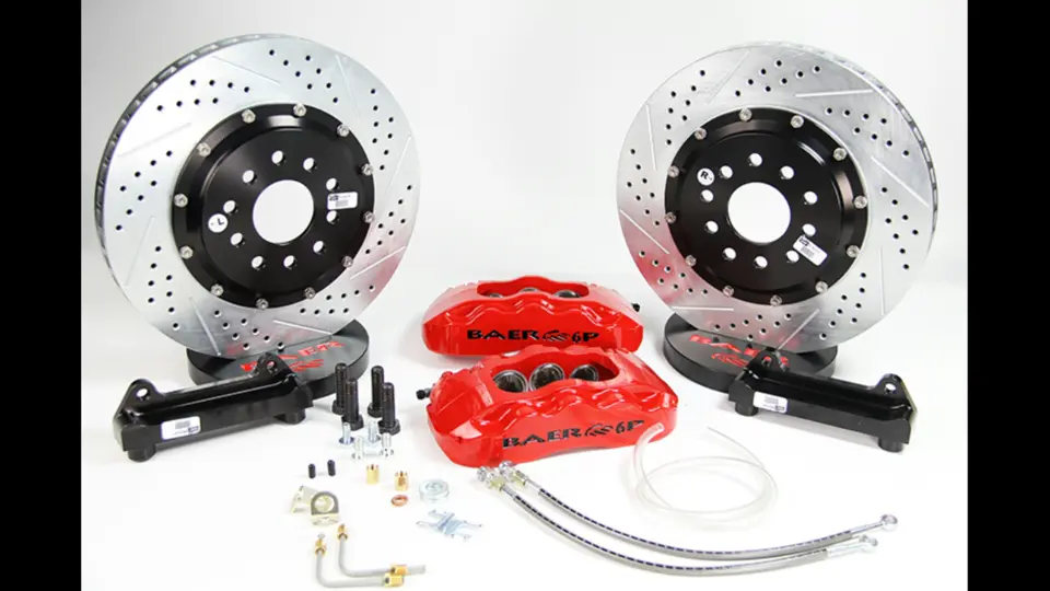

I get the idea of not using cheap ebay stuff, but does this statement mean don't buy drilled rotors period? Because every high end brake company out there sells them. Baer, Wilwood, Aerospace.. does this mean these are all snake oil.... or are you just saying don't buy ebay rotors? You mention Lambo and exotic race type equipment.. would these fall into that category?
Those would fall in that category as well being an engineered system. If I wasn't on a cell phone is explain why. I'll update when back on a PC.
I was more or less talking about going out and buying a Nissan Maxima and tossing on a set of oem style cross drilled rotors and expecting an improvement.
