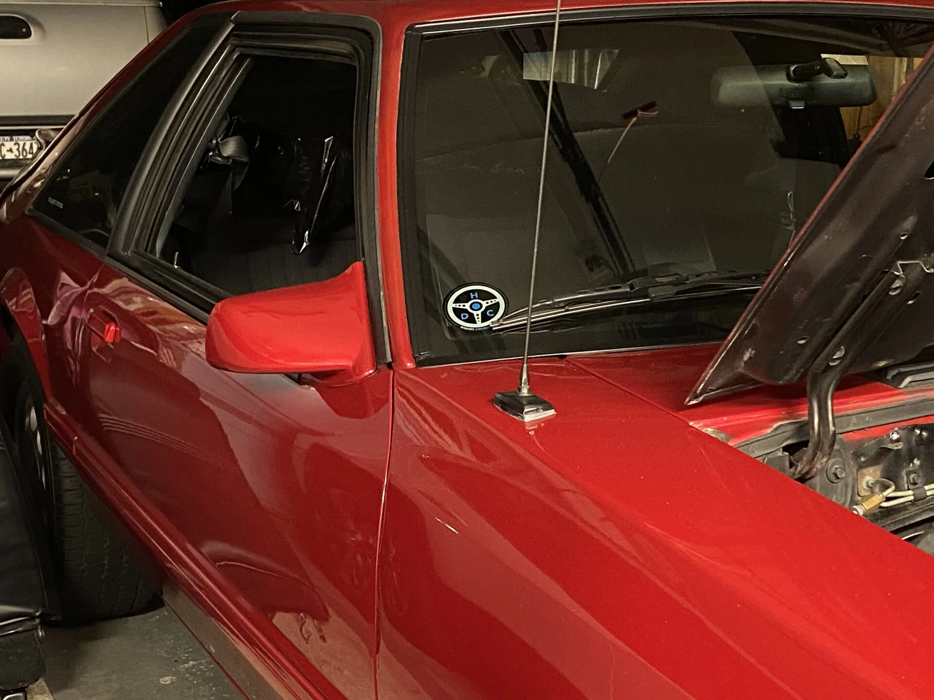

I’ve been back and forth on this for a while, but I really think I want my mirrors black instead of body color. Would you guys recommend taking the mirrors off, or scuffing them in place and then spraying with the trim black? I’ll be doing the door handles too.... but may just buy new black ones.
Can I just scuff up the red paint and shoot the black, or do I need to strip the whole thing down?
I want to do it right, and not do it again a year from now. @Davedacarpainter what do you suggest?
If the red is in good condition, not peeling etc. then you could sand, prime, paint.
Before starting the process wash mirrors with blue Dawn and water, let dry then use a wax & grease remover.
Allow the W & G remover to flash off (dry) 30min or so before sanding.
Reactions: Rdub6

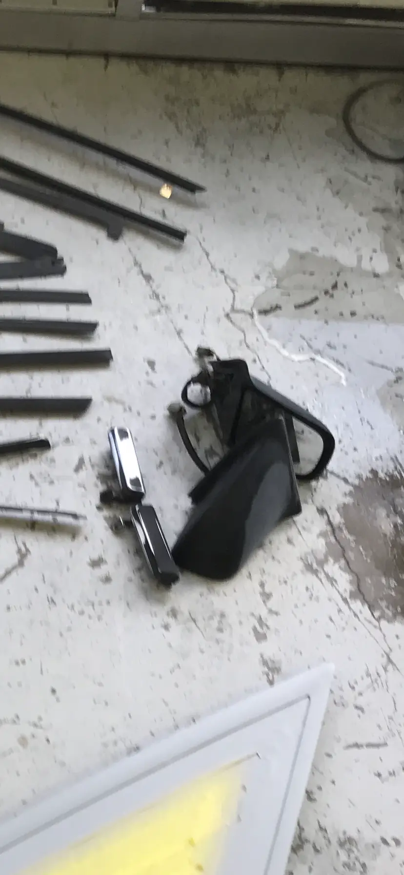

I do what's mentioned above. LMR sells new reproduction black ones. Store the red ones.
I personally like my painted side mirrors.
Yeah, they look pretty good on your coupe, but I’m just not loving it on the red.
And I’m eventually going with black wheels, so the mirrors and door handles need to be black too IMO.

Yeah, once you have them black you won't want to go back to red. Just take them off and paint them, it's not hard. At all.

I agree with the majority of the guys saying the mirrors and handles should be black. When I did mine, I sanded all the chips out of them with 600 grit (I believe) wet, and refinished them black again. I used a base/semi gloss clear coat on them, but I think SEM trim black would work fine. Same with my door handles. They all come off the car easy.
