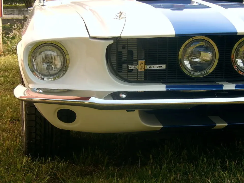

It's tough to see in this photo, but if you look closely, you might notice no ridge at all between stripe and main color. That's from clear and wet-sanding over the stripes.
