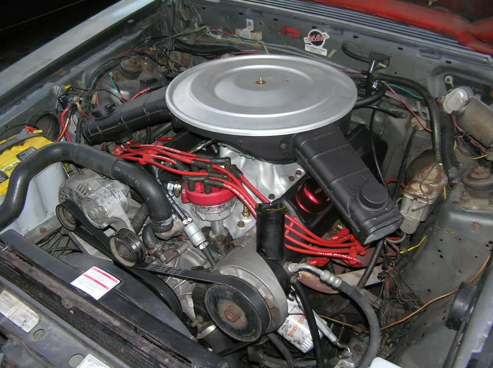

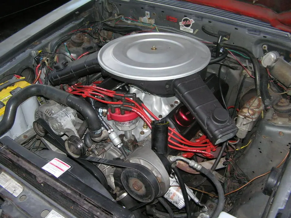

If you want a nice graphite color, then def check out of the Duplicolor wheel coating, it's tough stuff and you don't have to clear it. Here's a old picture of mine, people really liked how they looked.

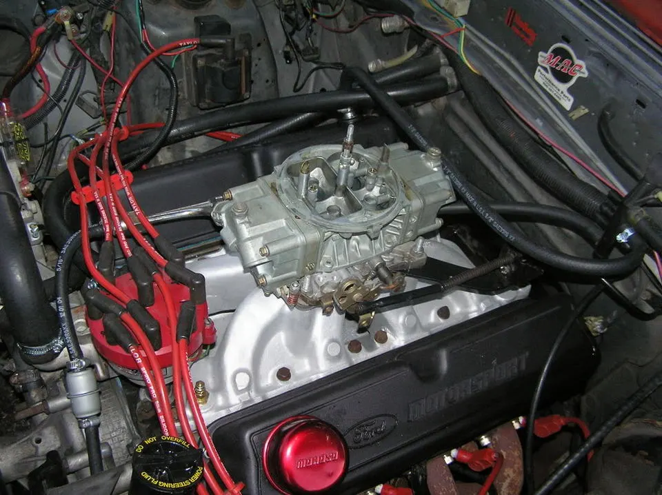

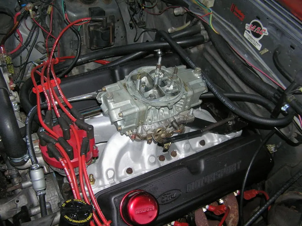

I used VHT high heat on my Motorsport tall covers because i got sick of polishing them. I also used the same paint on my breather...both as a kind of test of this paint to see how well it holds up to heat. I actually baked the valve covers in my home oven and didn't have any problems whatsoever. So far it's holding up awesome even with my leaky PCV valve getting oil on everything...oil wipes right off. If it holds up well enough i may do my intake in it too.
I don't recall if i used primer or not...i'm pretty sure i used some self etching primer...just a few light coats. Then spray a "good enough" layer...you don't wanna paint it too thick or it'll be prone to chipping. Just spray a few coats so there's addequate coverage and bake it. I had to do some reassuring to the Mrs. about baking in our oven, but aside from a slight smell, there wasn't any problem with it and the smell didn't linger or anything like that.
Here's pics....as you can see my tensioner and brackets are due to be painted again too. The paint that's on them is Duplicolor high heat...which didn't hold up very well. I love their paint but the high heat stuff wasn't too great.
I like the satin black for a clean OEM look. I'll probably use their paint on my block whenever i rebuild it.
Oh, the intake isn't painted though...that's just raw aluminum after being glass bead blasted. However, i'd recommend the VHT high heat paint in silver since i haven't had any issues with the black so far.
