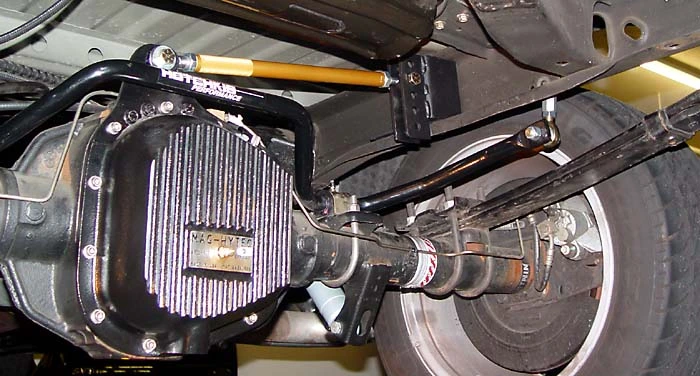

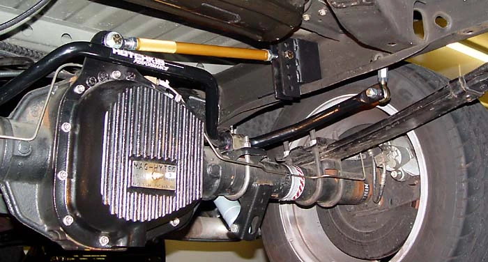

Here is also an example I found online:
The Maier bar is superior to the bar in the OP's example. The longer the bar the less the arc in the travel of the oposing wheel. I run a bar similar to the Maier bar and it made the rear end much more predictable.

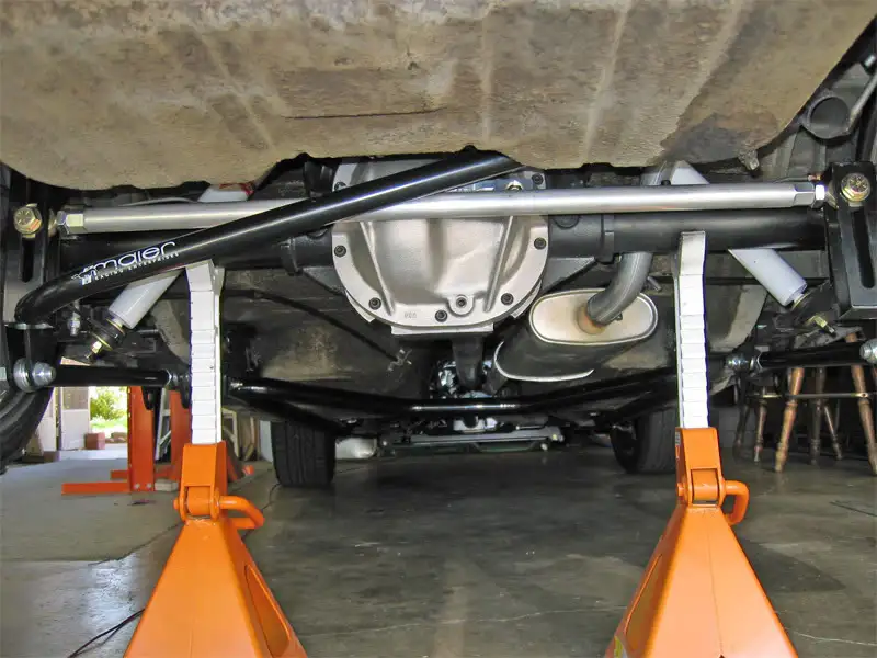

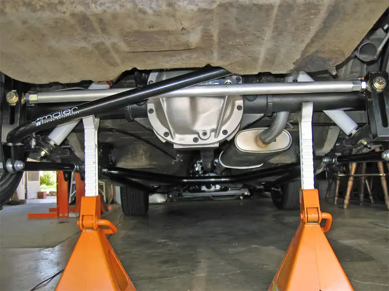

I'm running Maier's adjustable Panhard bar with an 8.8" from a 90 Fox on the '66. Very tight clearances with a girdle but works awesome! Huge difference in handling, and adjustments of the bar makes noticable changes in handling.
There is somewhat of a write up and pictures on the web site in my sig for the '66. Should be very similar for a '67-'68. I agree with 65 Fastback. I have about 1/16" lateral movement of the rear axle through the whole range with the bar adjusted level (please excuse the ugly undercarriage in the below picture :rolleyes: ). If you have to run a short bar, might as well install a Watt's link. Exhaust is a *very* tight fit, but can be done up to about 2.5" Not sure if bigger pipe would fit.
