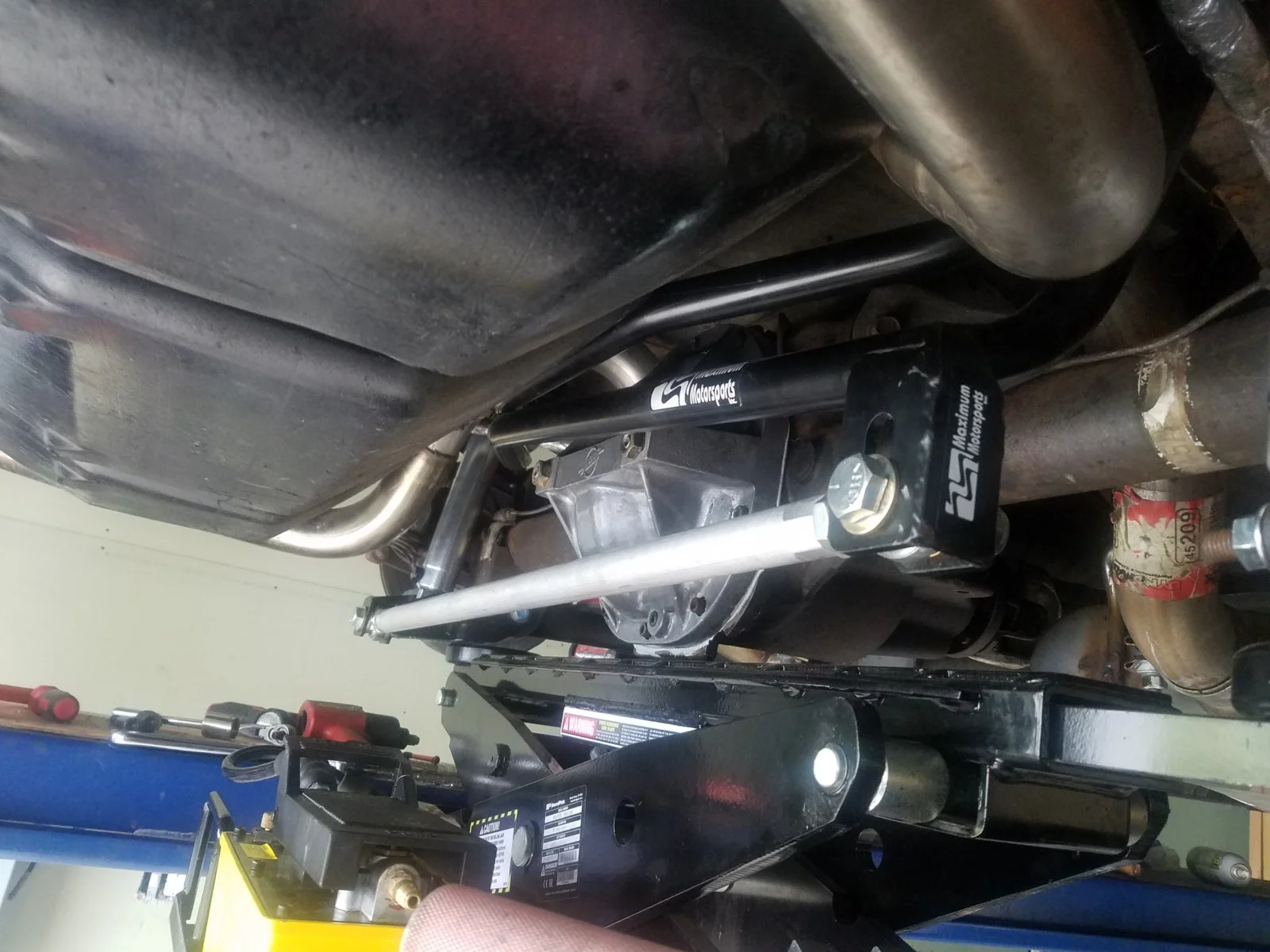

Maximum motorsports extreme lower control arms
New/reinstalled quad shocks
H&R rear springs
MM panhard bar

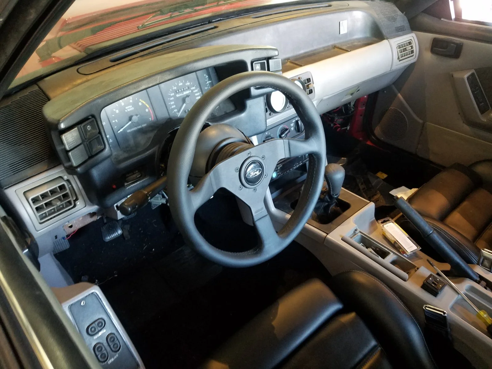

Tilt column with momo wheel and ford horn button

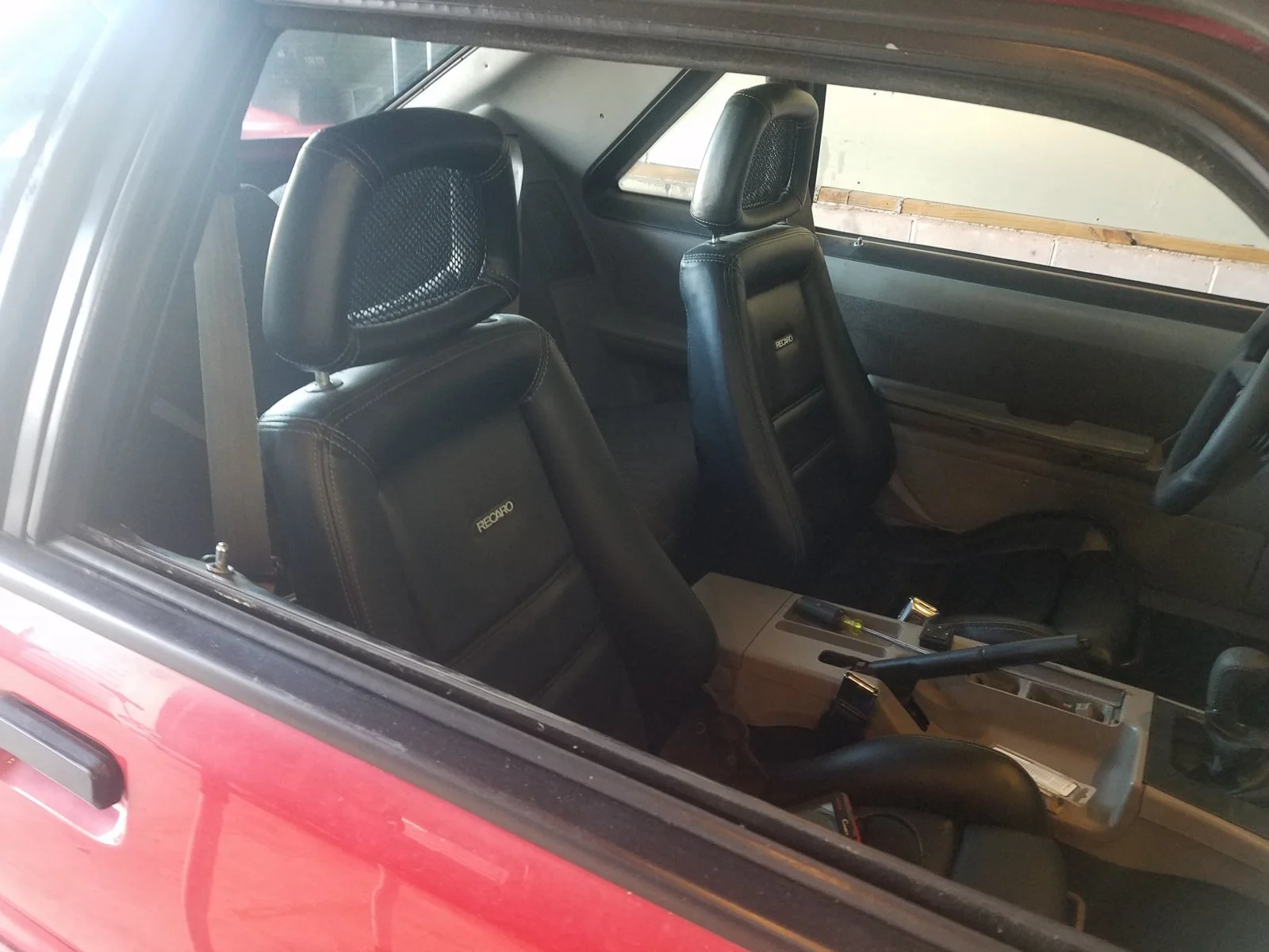

Finally got to try out my recaro seats too

The panhard was a bit of a pain to install.
It's one of those tasks that until you get into it, you may not understand what the hell the directions are talking about.
Probably took me 3 hours. If I had to do it again, likely half that.
My dynomax ultraflo catback clears it, pretty easily (which is why I bought that catback).

Ordered all new connector pigtails for the column, since some pins don't stay in. Hopefully that will happen on Monday.
Also went to junkyard and got a new center vent section. Next up i'm removing the gauges.

Today I received all 4 multifunction column pigtails from LMR, about $50 worth.
Unpinned the originals, unpinned the pigtails and they all went right in. Probably 20 30 wires.
It was as simple as using a tiny hobby flathead and pulling out the wires.
Depinned the new ones all at once, then did the ones on the car one at time.

I love your seats. If only I could find a set like them.
Not looking forward to the MM PHB install on my car. I'm doing it solo, so the part that i'm worried about is holding it in place while I measure, and then remeasure before drilling.
The seats are one of those things you may have to be persistent about. I know I go through my phases where I search for something, then forget about it for a while, then repeat. Mine were beat to death and for sure out in the weather at some point, not sure if $250 for a set with netted headrests is going to be duplicated that easy. So there may be some luck involved.
The phb isn't nearly as hard as the directions make it seem.
The way I see it, the main concern is getting the passenger side to match the drivers side since the drivers side measurement doesn't change.
I used a self tapper to hold the drivers side up.
I stood under the car, managed to hold passenger side in place (after a few tries) and mark the passenger side. I don't know if that task is going to be possible by yourself laying under the car.
I could have and should have asked for a hand, but I tend to work on things randomly on top of lacking patience for someone to come over.
My worry is Swiss-cheering the rails. I just want to make sure 4 holes is all I drill.
Notice any difference with the PHB?
I used a small sheet metal screw where I was to eventually drill the real hole. It was a calculated risk that worked out.
I'd say yes I could feel the panhard bar, but the car in general felt really tight and I didn't really push it too hard.
But Quads, lower control arms, h&r springs, steering shaft, the phb and a front sway bar is a really lot of parts at one time. I would say it would have been more odd if I wasn't impressed.
I'd bet the phb was responsible for the NHV. There is basically nothing that separates the rear from the chassis anymore.
By no means am I complaining about the feel, it's just I could tell it was different.

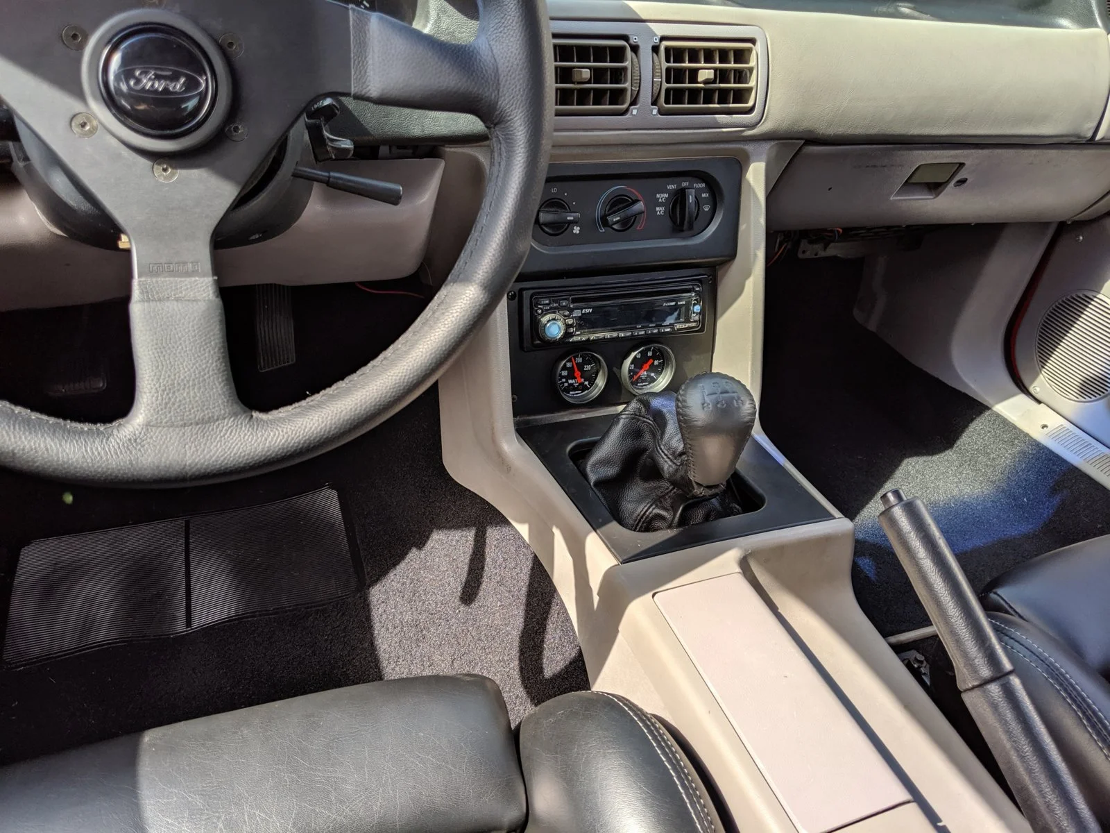

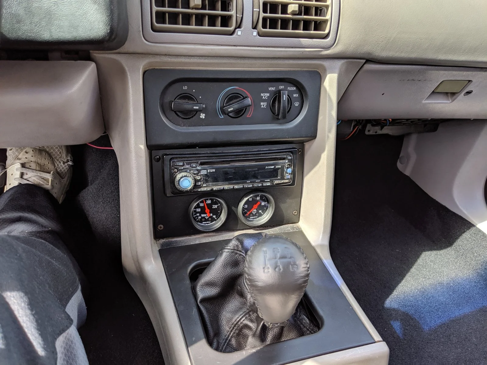

Ordered one of these today. Going to take my spare shifter bezel and see if powdercoat guy will match is it as close as possible.
I wanted a double and not a triple and found it on ebay.
Just have to pick out new gauges that fit (the ones in the heating vent are 2 5/8 so they can't be reused).
Considering autometer Z series.
I figured the z series should look as close to the factory gauges as possible, feel free suggest others but i'd like the green to match the stock cluster and blend in as much as possible. I really hate when gauges are a focal point.
I was going to maybe try out a multi gauge from a couple different companies, the problem is they all wack you pretty hard by the time you have all the pieces. I can't see the multigauge being acquired for less than $500 from any company. Most hit you around $200 just for the oil pressure sender.

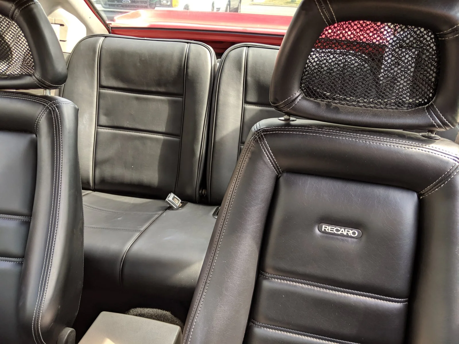

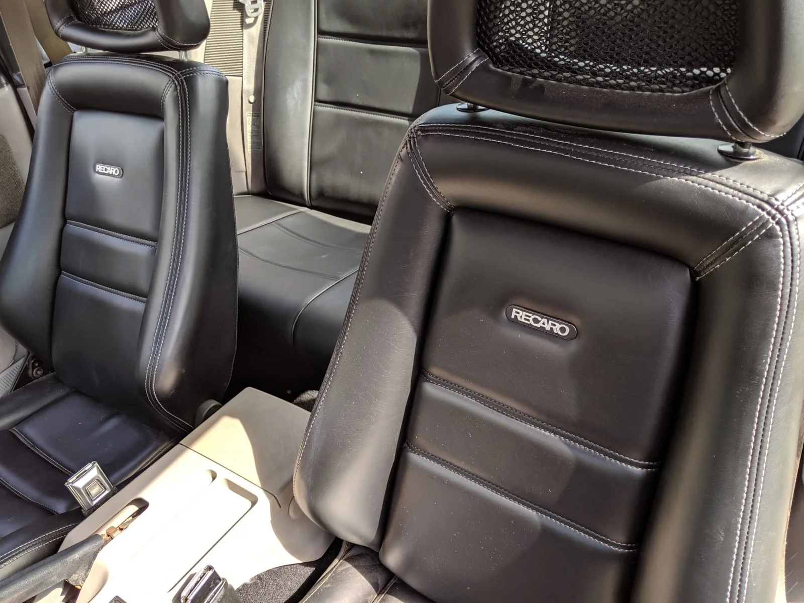

Had rear seats done to match fronts and moved gauges from dash vents to under the radio.
They are smaller and harder to see but they work better with my less it more or born this way interior theory.
They are Z series and i used 12v green led's to match dash (as if i've driven this car at night in the last 15 years).
I give up on taking pics of the back seats in the sun, they do match the fronts completely, but without tinted windows, seems i'm a horrible photographer.
Edit: Sometimes it takes a picture to figure something out.
While i'm pretty happy with the rear seats, something has always seemed slightly off to me.
Well, I found it, they put the piping back on the edges of the upper seat. Looks like they are going back this winter...
