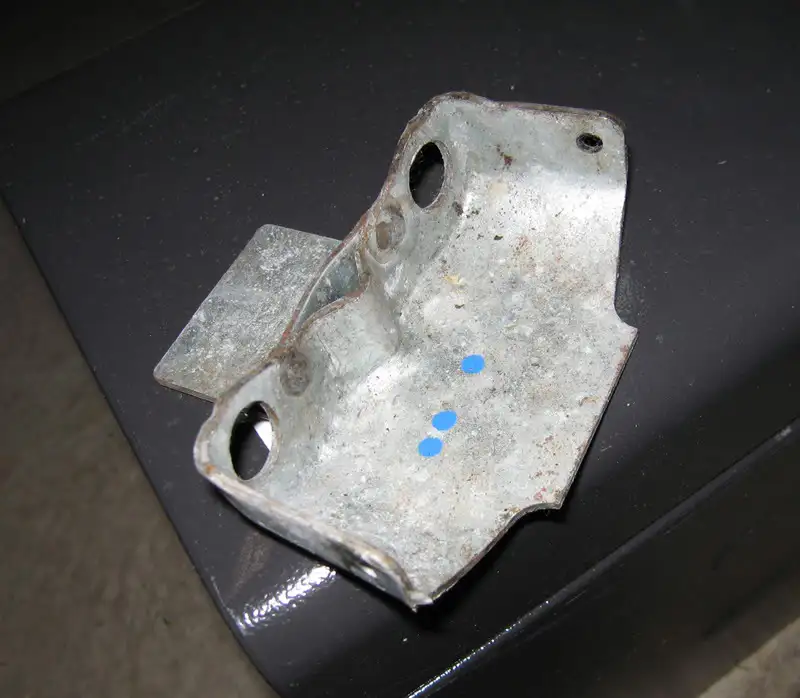

There is a bracket that needs to be rivetted o the underside of the car just behind the parking brake handle.
Matt90GT at one point posted a picture and the dimensions of where this bracket is to be placed. However, I can't search that far back into the threads anymore. Does anyone know where the bracket needs to be rivetted so that I can finally put the cables into the car?

This bracket is mounted to the underbody, the cable sheaths go through the holes and the cables are then connected to the handle.
I just don't know where the bracket is supposed to be mounted.

I just converted a '89 using a 95 GT rear and I just purchased the 3 cables from Summit which is about $25 cheaper than anyone else and converted the emergency brake handle and done. I am not sure what that is you have pictured.

There is nothing hard about this. I just have to rivet that bracket to the car.
I know its been discussed before about where to mount this piece.
This should be the exact same set up that the SN95 cars have.
Email Matt90GT - he's still around, his web site, http://www.svo73mm.cjb.net/ is still up. I haven't seen him here on Stangnet for a long time.
You are probably going to have to drop the driveshaft to drill the holes for the bracket for the cables.

Yeah I noticed that Matt hadn't been around. I've been searching through his website looking for the instructions. I guess I will email him.

I believe that bracket also came on 93 Mustangs.
