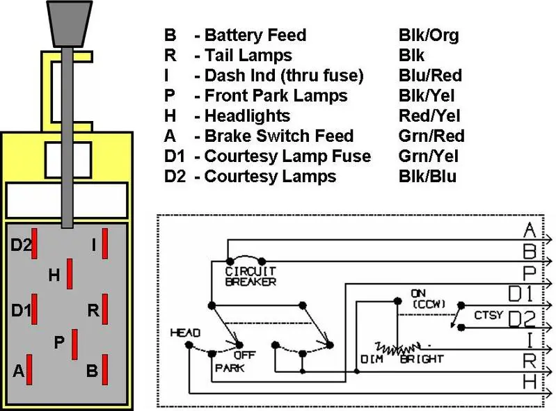

There are places that one can follow the voltage on its route from the fuse box to the rear lights.
Do you know someone with a volt/ohm meter and knows how to use it? A few minutes of looking at a schematic and taking a few measurements by a knowledgeable person would have saved you a lot of time replacing parts that didn't need replacement. Not meant as a criticism, only an observation after the fact.
Just a simple test light is all you need. Check the black wire/terminal coming out of the light switch. It carries the voltage to the rear taillamps/lic plate lamp.
