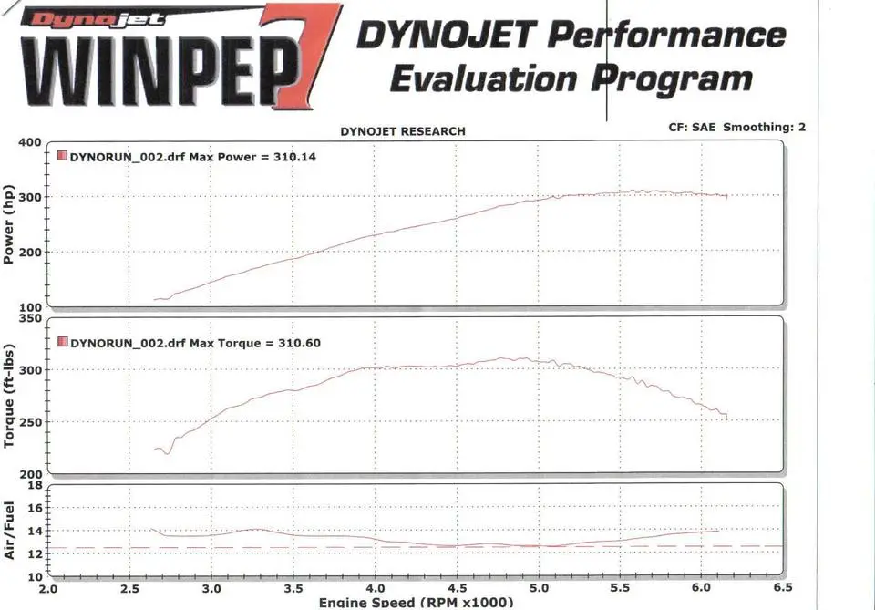

Green&GoldGT said:
Do you have a dyno graph to post up? Not that I deny it, but to compare power bands to ported PIs.
here you go, this was the base tune, thats why the AFR is a little wacky, but its fixed now, and put down the same power.....

We need to see rwhp #'s with the TF heads.
Here is my graph from 04 with patriot II heads and comp 270 cams with a stock PI intake. It was still climbing when the pull was stopped due to pegging the maf.
http://i160.photobucket.com/albums/t165/y2k2gt/100_3644.jpg
