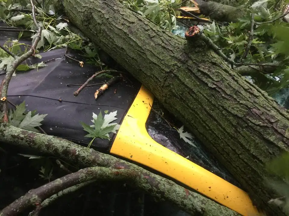

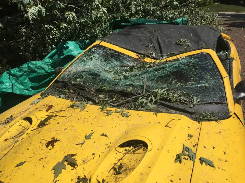

No, this is a different problem. Don't know if you remember the derecho (incredible wind storm) that came through the Midwest last year. But this is what happened to her:
Well, after 10 months and a lot of money she has been restored perfectly. I got her back last week. Locked her. Next morning, put my key in the lock (no keyless entry), open the door and the panic horn goes off. Can't turn it off. Inserting the key doesn't do anything. Have to disconnect battery. Both keys do the same thing. Had an appointment with the Ford dealership today to fix it. Guess what? Lock it. Unlock it. No problem. Take her home. Lock it. Come back out and unlock and it's PANIC horn again!. There is some point where the PATS loses its mind. 10 minutes? 30 minutes? I will have to do an experiment to determine how long after locking the PATS stops recognizing the keys.
