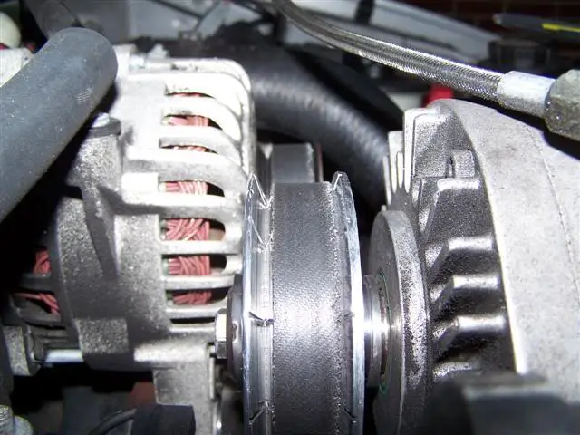

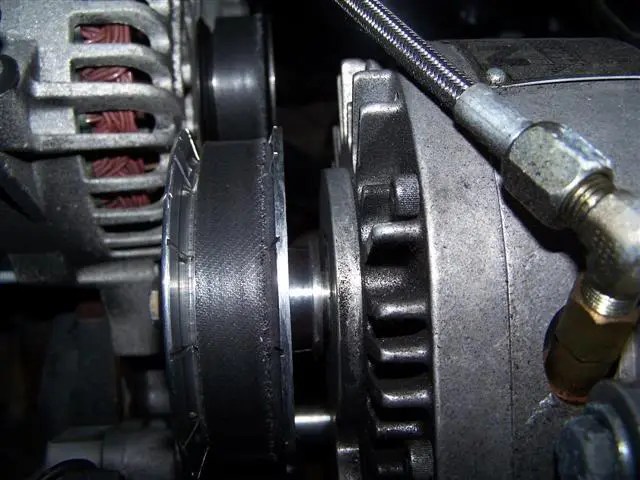

is this spacer suppose to be behind the blower pulley? it was on there with the paxton pulley and did fine but with the RR pulley it is shredding belts about every 500 miles.
it is kinda hard to see but there is a washer that is about 1/8" thick behind the pulley.
i was also wondering what size pulley i need to order to get my boost back up from the IC drop. i have a 3.4 RR with a power pipe and i'm seeing 8-9 psi. i want to be between 11-12psi. i was at 11 psi with no IC and the stock 3.5 pulley. would a 3.1 be too much? how do you know what size pulley will give the pressure i want?

Dan_Soprano said:
umm, it's not the tensioner. Look at the history. it was fine with the stock pulley, but when you switched to the RR unit, it started shredding. pulley is not aligned correctly.
correct, i skimmed over it & thought he was wanting a new pulley.
having said that, my 2nd bet is that the pulley is on backwards. paxton put mine on backwards directly from them & we'd like to never found the problem. it did exactly that, it jumped 1 rib, on that side, almost immediately. can you line it up & it look perfect, but when you start the car it starts to jump ribs? if it's not that, definately the spacer - assuming everything was put back on correctly after the pulley swap.

Iv heard of RR pulleys shreding belts...people switch to a GI jo 8 rib or back to stock/vortec/procharger ect and solve the problem. I think the RRs are just too agressive, or some are not machined properly. But hey what do I know LOL...im a turbo guy. Just my guess :)
