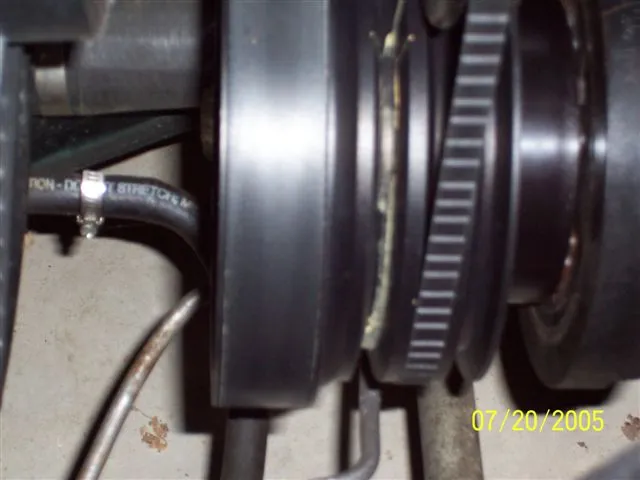

The crank pulley has one serp to run the sc and 3 v belts on the inside. I'm currently trying to find a solution for the same problem. The late model one doesn't line up. Maybe you can use a spacer with the late model one, I haven't looked into this far enough.
this is the pully that came with mine, I used the middle v-grove and there is one on the inside of it as well as the outside of the one used, hope this helps you out a bit

I'm watching this thread... I'm trying to run all v belts with ps, a/c, alternator and a vintage Paxton SN60. I thought I had it figured out when I was going to use only one belt for the a/c and ps, but it just slipped too much once the compressor clicked on. Now it looks like I'll need to add an extra accessory pully at the crank, but I'm not sure there's going to be room with the electric fan and all... sigh... :(
The problem I ended up with is running the pass side sc. I used a krc pump and and aftermarket mount for the ac compressor. This left the inside belt on the crank pulley un-usable. To run the ac, I would have to run it with the krc pump which I think will slip and maybe slap due to high rpms. The alt I have is high output and requires more than the average vbelt can deliver. So if it isn't brand new and snug as a bug, it will slip.
I'm having paxton send over a late model crank pulley to see how I might be able to use a spacer and run a serp set-up. We'll see how it goes.
