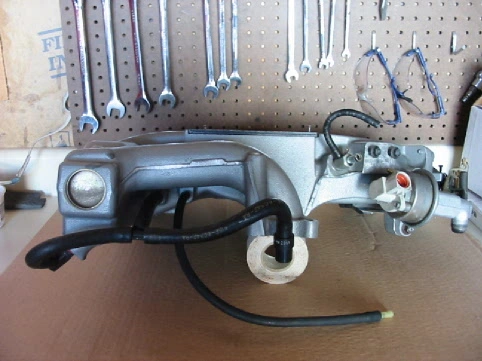

I am pretty sure there are three vacuum connections on the underside of the intake.
There is a small nipple that connects to the purge regulator valve in the EVAP system over on the passenger side up by the firewall.
There is a large nipple that should be connected to a "T" fitting. The PCV hooks to this "T" fitting.
Finally, there is a port / opening on the corner of the upper intake that connects into the same conglomeration that the PCV hooks into. Kind of makes a big circle.

A stock intake has a port next to the EGR valve that has a big hose running to the brak booster and two small hoses, one going to fuel pressure regulator the other going to EGR valve.
Under the center of the intake is 2 ports. Like said above, one goes to the EVAP solenoid and the other goes to the PCV, but is T'd into a hose that comes off the bottom drivers side back corner over the valve cover.

A visual
