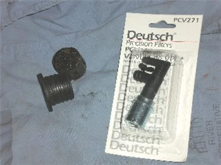

Switching out my intake manifold, figured I'd replace my pcv valve. That metal mesh thing was caked with crud. So I got the deutsch pcv271 from the parts store. Is this the correct one, even though it looks nothing like the original mesh filter? Do I throw away the mesh filter and just plug the new valve into the rubber grommet and the rubber end plugs into the hose? I noticed on my stock intake there was a metal lip to hold the mesh filter in place, that is lacking on my new intake. Whats up with that? I included a pic also.

You have one complete set of items there. You need a screen (parts stores often call it a breather), grommet and PCV valve (the Deutsch part). DO NOT toss that screen. I'd get a new one.
Additionally, for best results, get Ford parts. Some aftermarket PCV valves dont fit very well into the grommet, and this results in a vac leak.
At a min, I personally would use a Ford PCV valve, along with a new parts store grommet and screen.
Replace them all and forget about them for a year or two.
Good luck.

all that PCV does it let crankcase pressure get out, like say if u bust a hole in the piston, you wouldnt blow all your gaskets out with all the incoming pressure. I dont see what the screen if for?
I prefer to run the motorcraft PVC. Reason being the motorcraft peice has the port pointed straight up while the Douche peice has it 90 degrees.
It's a tough enough spot to get to, but to bend the factory hose over can be a little trickier.
Oh my. If a piston comes apart, there are bigger worries than the PCV valve venting shrapnel. :rlaugh:
The screen knocks down oil so you dont coat your intake with tons of oily, nasty vapor. Do a search for guys who dont run baffles or a screen and see what they think about it (they dont generally like it).
So the screen knocks down some oil-laden vapor and the PCV valve acts as a check valve. The hose from the oil filler to the TB is what allows air back into the crankcase.
Good luck.
EDIT: Mike posted while I pecked. To add to this thoughts, the plastic fitting can be broken off to reveal a nipple pointing straight up.
