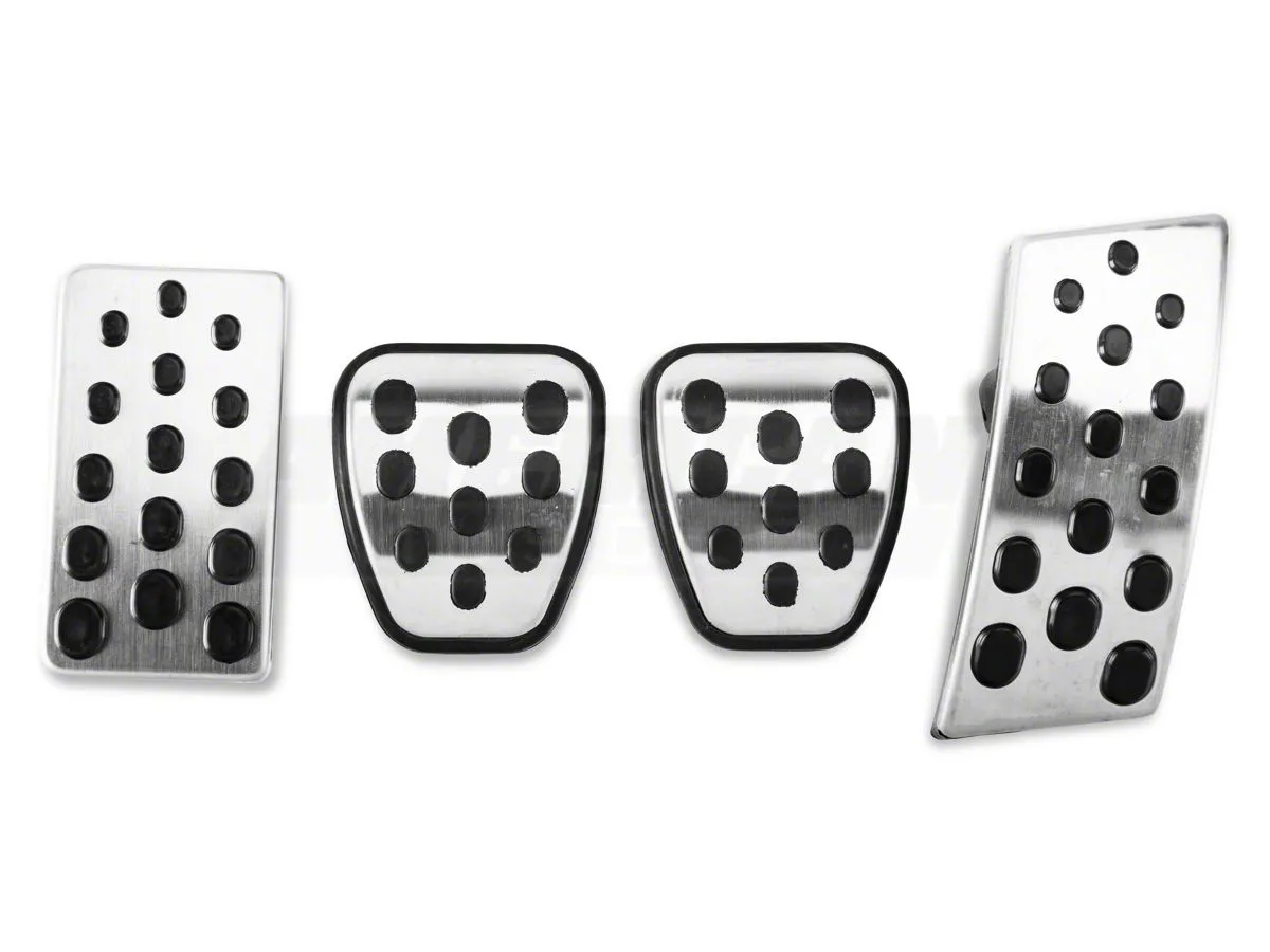

i own a 90 5.0 foxbody i would like to know if i can install the modern bullitt style pedal covers on to my foxbody cuz according it will only fit 94-04 i want to install them but without removing the pedal assembly
Not those. Those are sn95 style pedal covers. They came standard on the 03-04 Mach 1. They slip on however the sn pedals and the fox pedals are shaped different. I doubt you get them to fit o a fox pedal and at the least if you did get them on they would probably fall off.

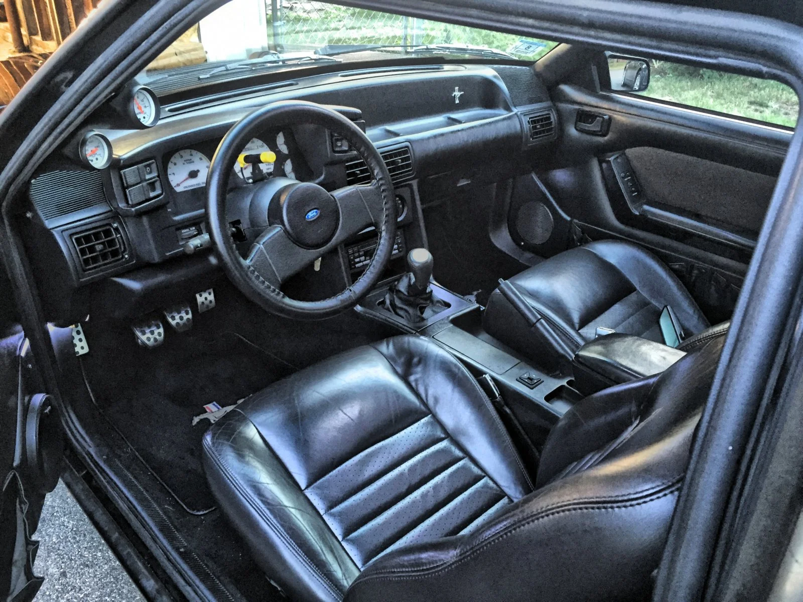

Dead pedal and gas are easy swap. I have them in my car.
The brake and clutch are different story. You can finagle the brake pedal on and use some epoxy to secure it, but clutch pedal will require a grinder to reshape it.
I haven't explored hanging a sn95 pedal on the fox pedal box yet
Clutch is not installed in this pic. Just sitting there for the photo op. That's the difficult one to install
