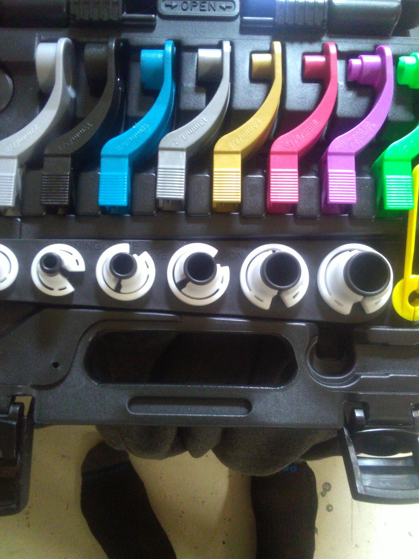

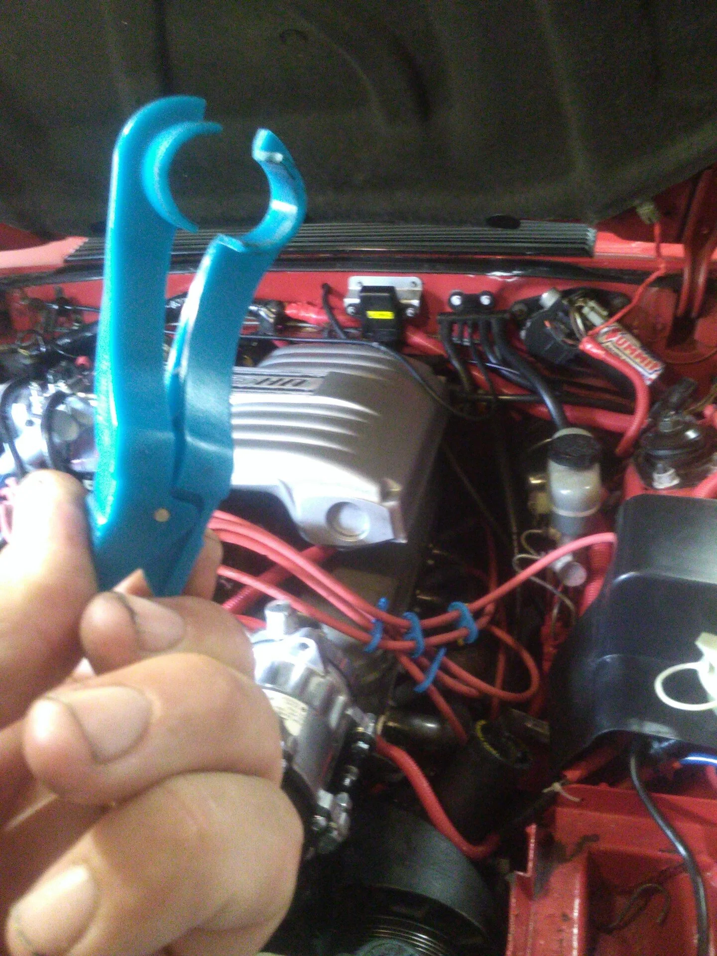

Here it is. And buy the way Harbor Freight plastic disk tool to take off the spring locks didnt work on all of them I got to buy the Listle brand

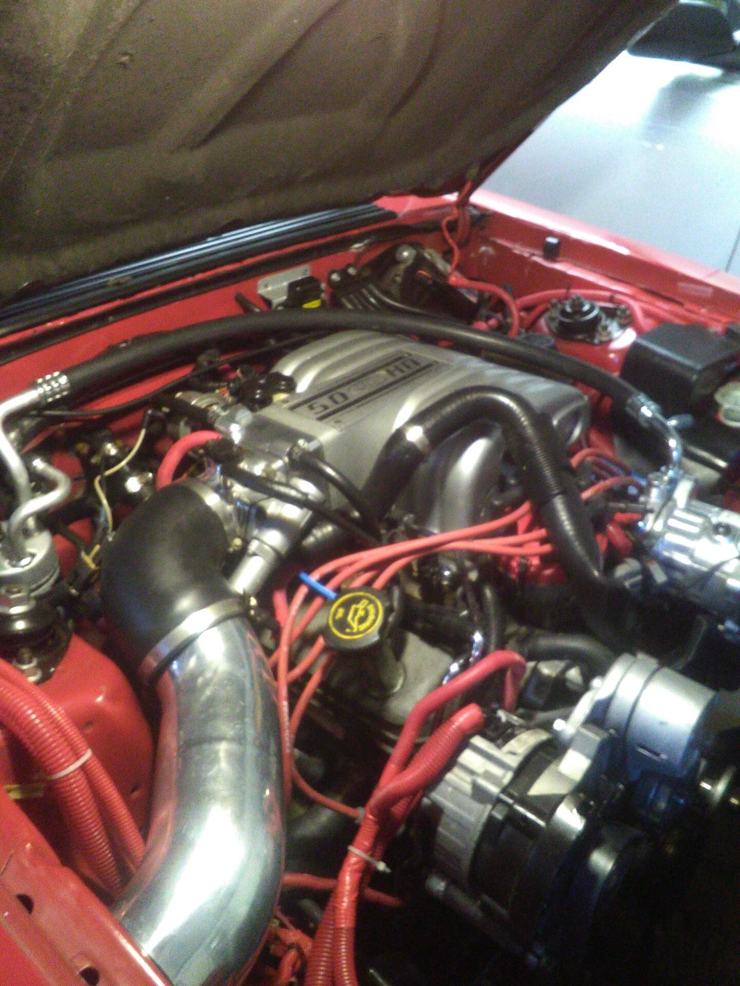

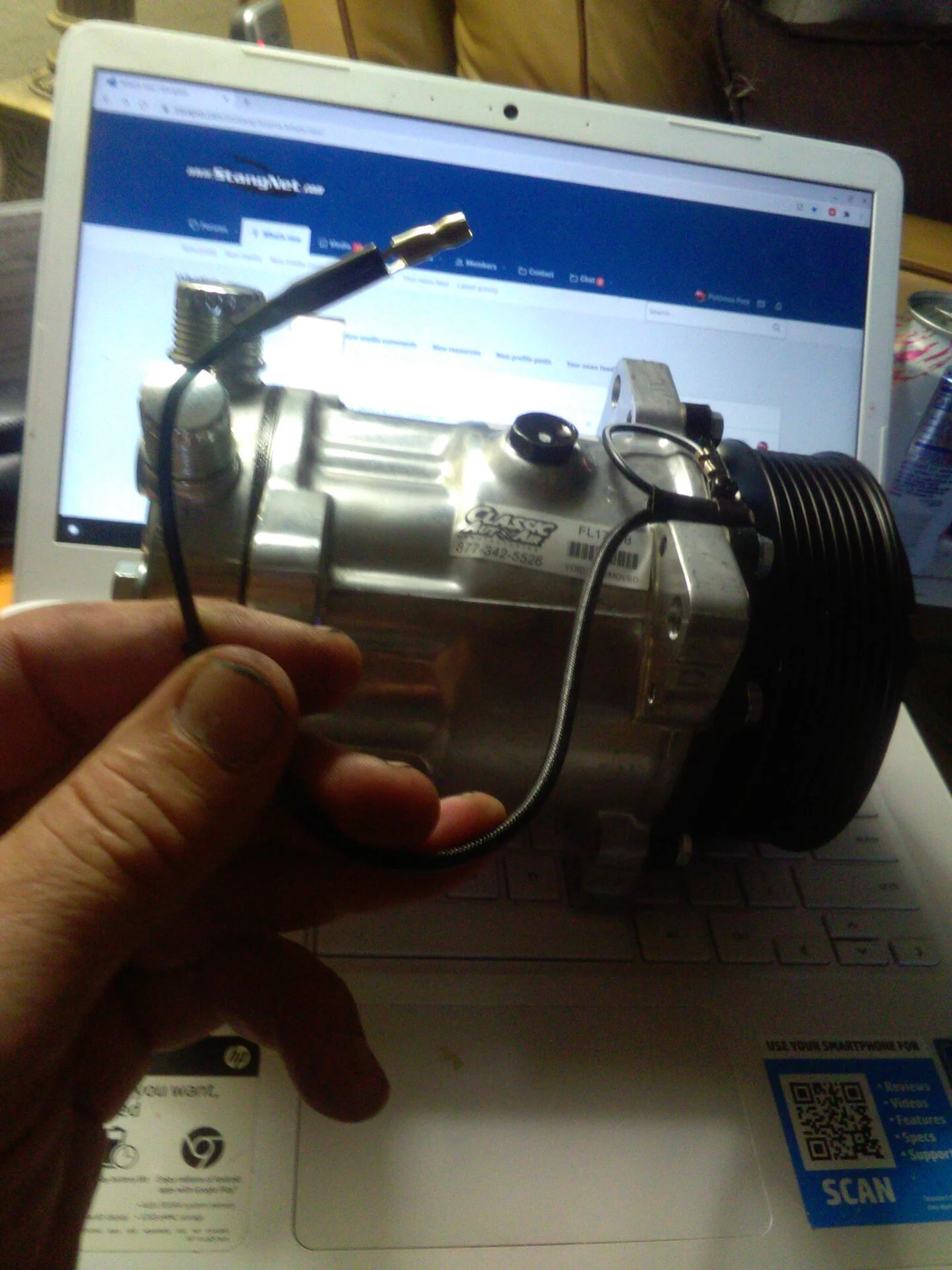

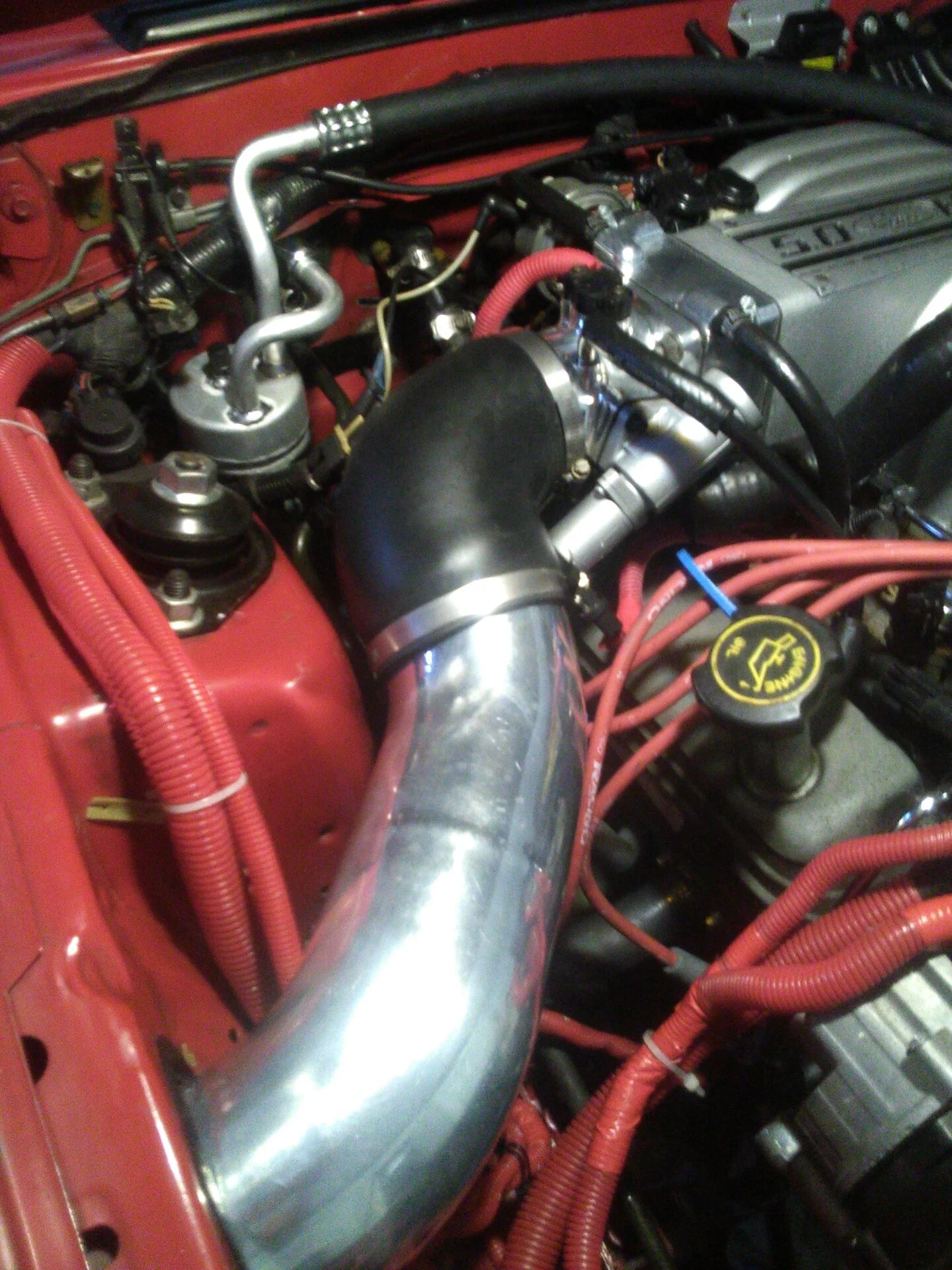

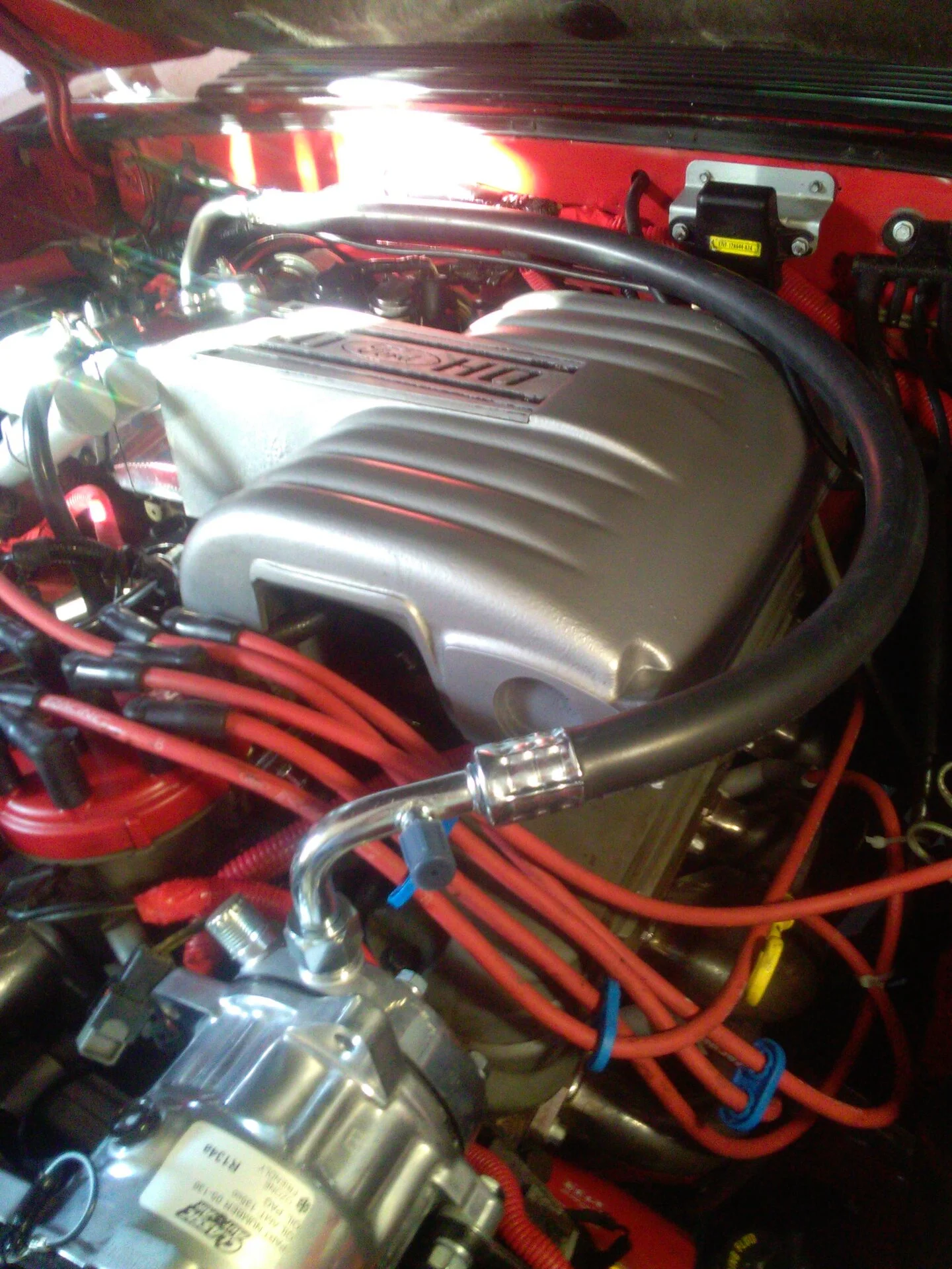

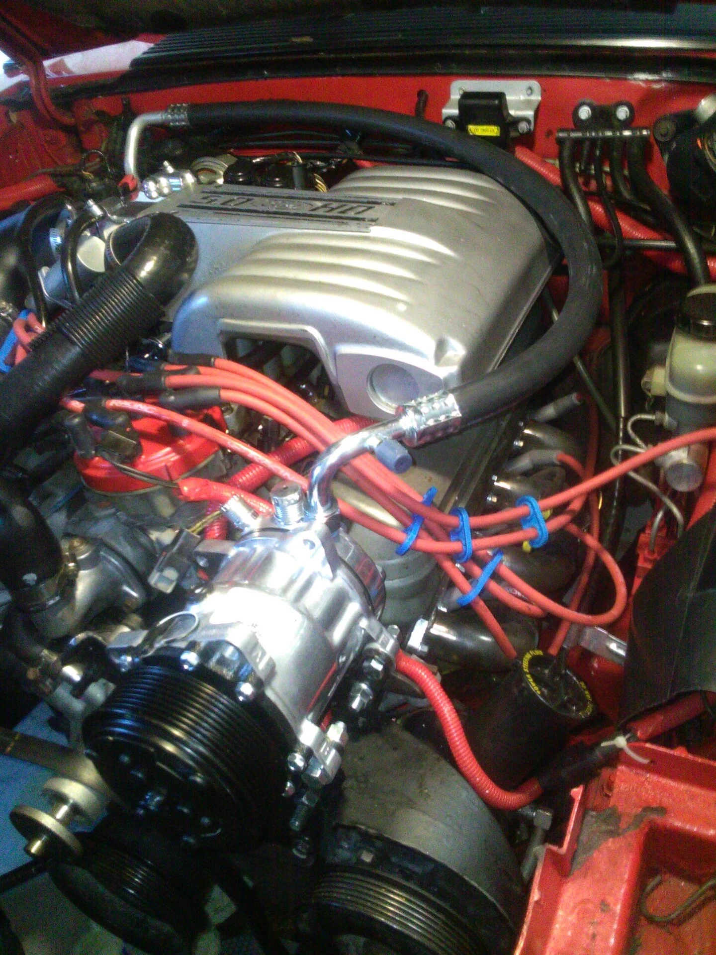

Got the compressor in after one hour of changing the spacers , and reversing the back bracket ten times. It does not go in the way the instructions say it is supposed to. I temporarily set the high side hose to see how it would fit , and its better than the stock one. I love the way it is a little longer. Thats a four inch Anderson Power pipe with an Accufab 90 mm throttle body with spacer. I bought it before I had a clue about foxbodys I read a few times that its too big for my set up. It would be nice if somebody chimes in on the one wire going in to the compressor.

I've fought those things for fuel lines a couple times, and I have the cheapest, plastic pos tool I could get, I even got the expensive ones from the shop and still had a hard time. Spray a little lube in there and keep working it.
There was a point I wanted to wade the line up in a ball and toss it into my neighbors yard!!
Stupid me was fighting the one on the firewall for one nasty hot hour. Then I realize you have to fight it from the back. Who would think. Had to spend fourty two bucks for a tool I may never use again. I hate that. Luckily I have a neighbor that has gauges and vacuum pump so I can save there. All and all its going very well. I am really not all that mechanically inclined. Its my non functioning brain. To do this you need to understand physics to a point and have patience.

That one wire is for power. The clutch grounds itself through the body. You need to unplug the pressure switch and jump it with a piece of wire. Turn the AC knob to on and check the factory compressor connector for 12v. That wire connects to that black wire. Should be black / yellow stripe. The factory connector has a wire that goes to ground instead of grounding at the compressor body.
Looks like its a standard round push in connector. They sell those at all the parts stores in the electrical aisle in all the red, blue, yellow sizes.

On the ironically named quick disconnects, it’s worth buying the Lisle tools to start with. If you have not used them on the fuel lines yet, you will probably prefer them. At least I found them much easier to use than a couple of other types of tools. Of course, knowing how the dang connection was built was also handy.

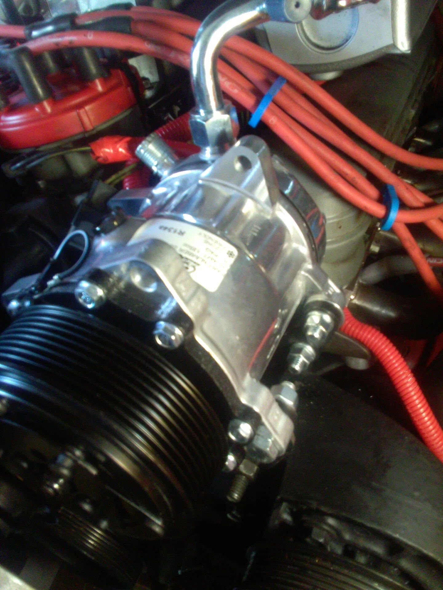

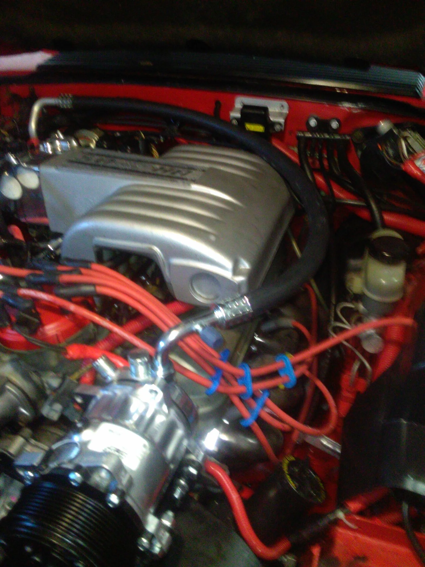

This kit a HF is good and snapped it right off but $43. Thats a lot from HF I will put it in my stack of crap from Harbor Freight. I gotta say though I have used my wheel puller seversl times

I like that AC hose not running over the intake manifold. Some DEI heat shield might still be a good idea on the line and look better than the decaying foam pipe insulation most of us are likely to still have.
How well do the wire separators work and what brand are they? I realized yesterday my nice wires are laid out like spaghetti and I am lucky to not have misfire issues.
That nasty accumulator hose on my non working AC is what prompted me to rip it out. I know that’s taboo on here for a lot of people, but hopefully one day, AC will be back on top of priority list, and I’ll be going through what Pete’s going through.
I had some good luck with two sets of the Ford Racing wire dividers. They got everything set up nicely..... one set was not enough IMO, but still relatively cheap.
