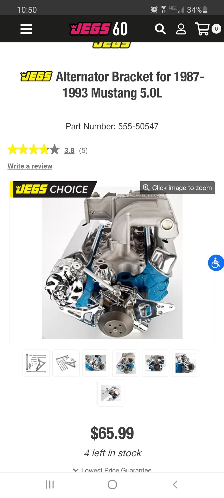

This is real similar to mine....this one is about 30 bucks cheaper.

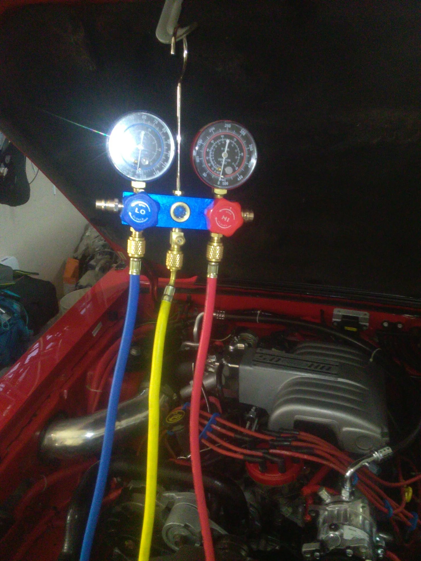

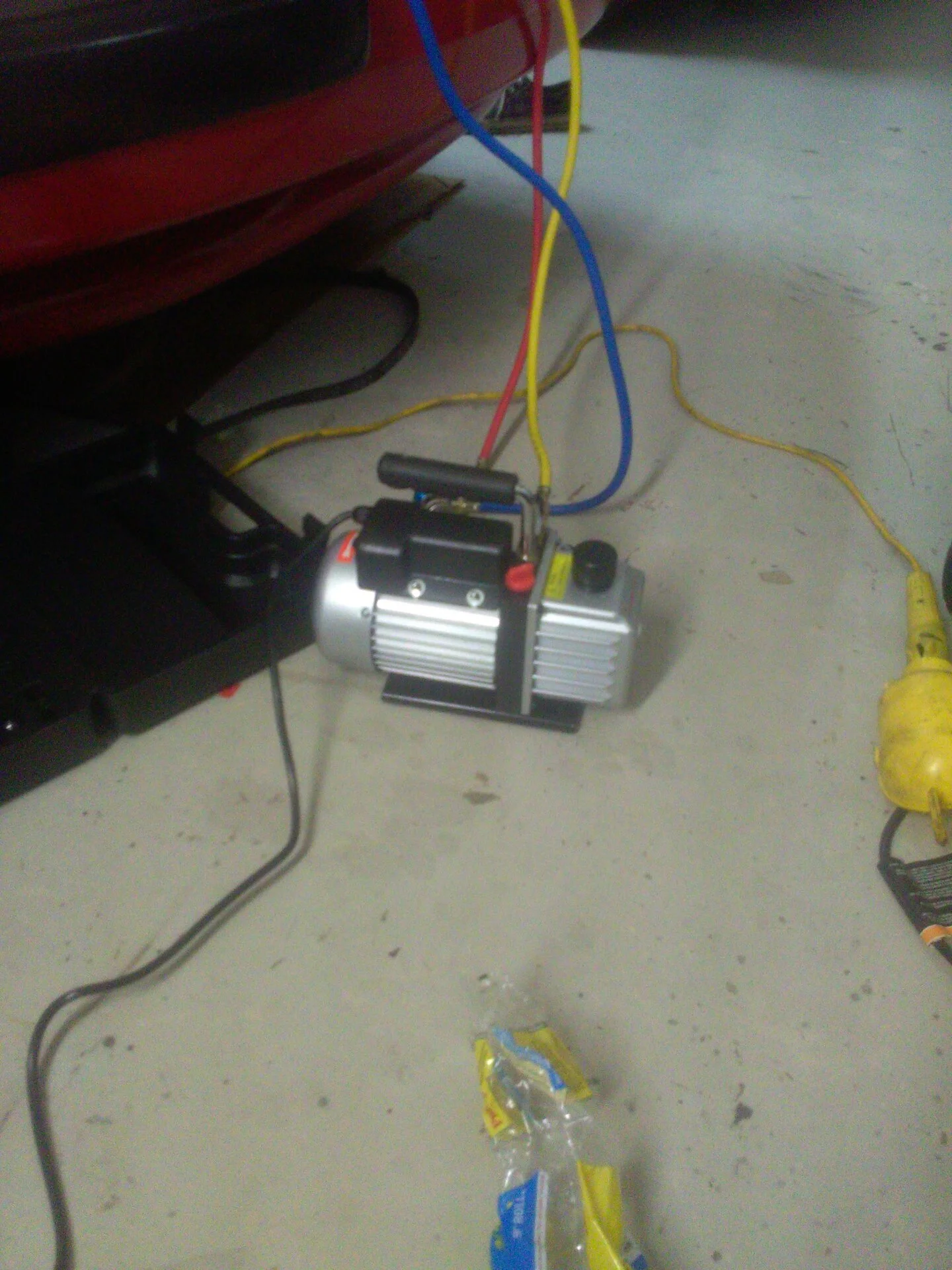

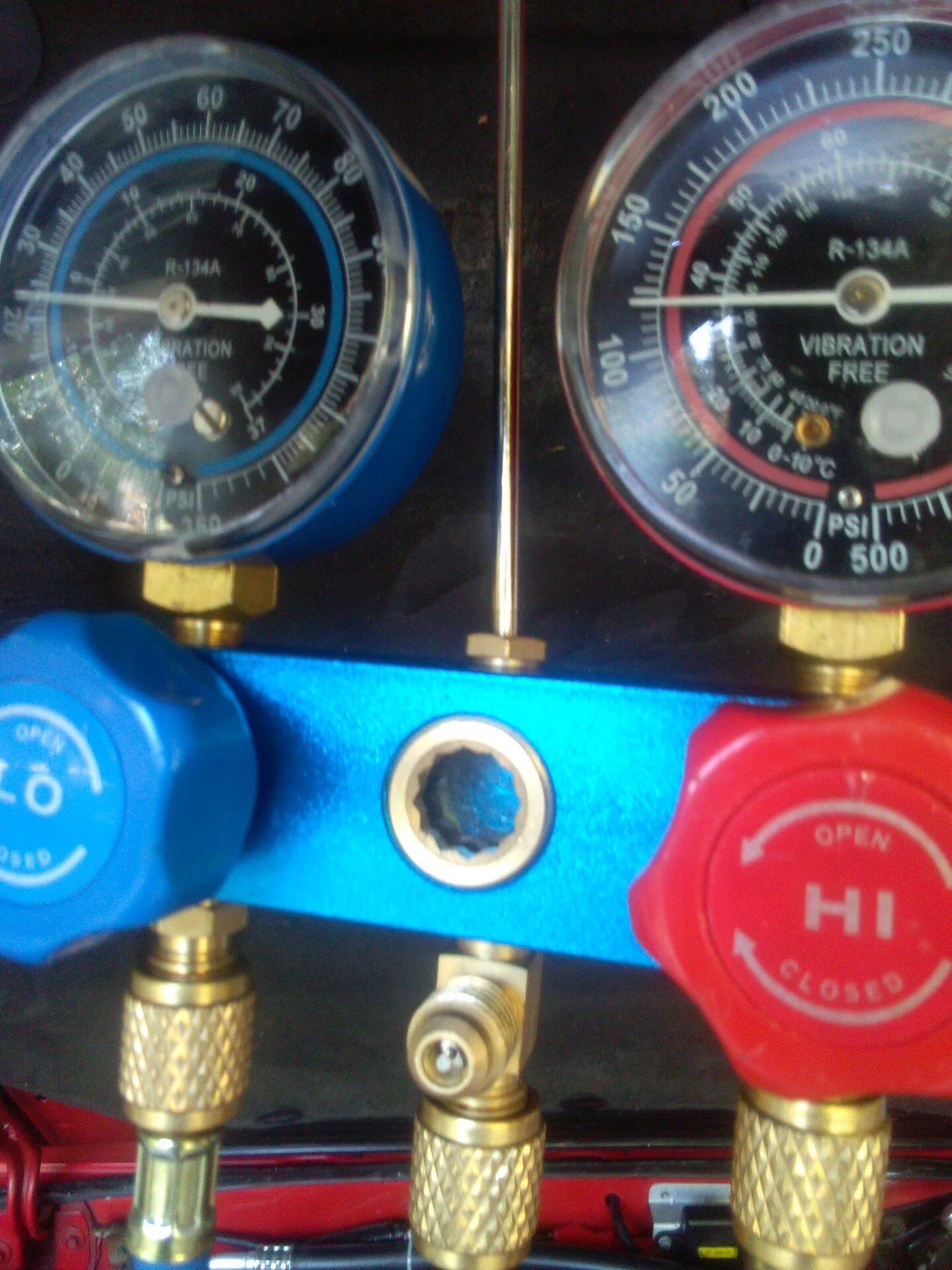

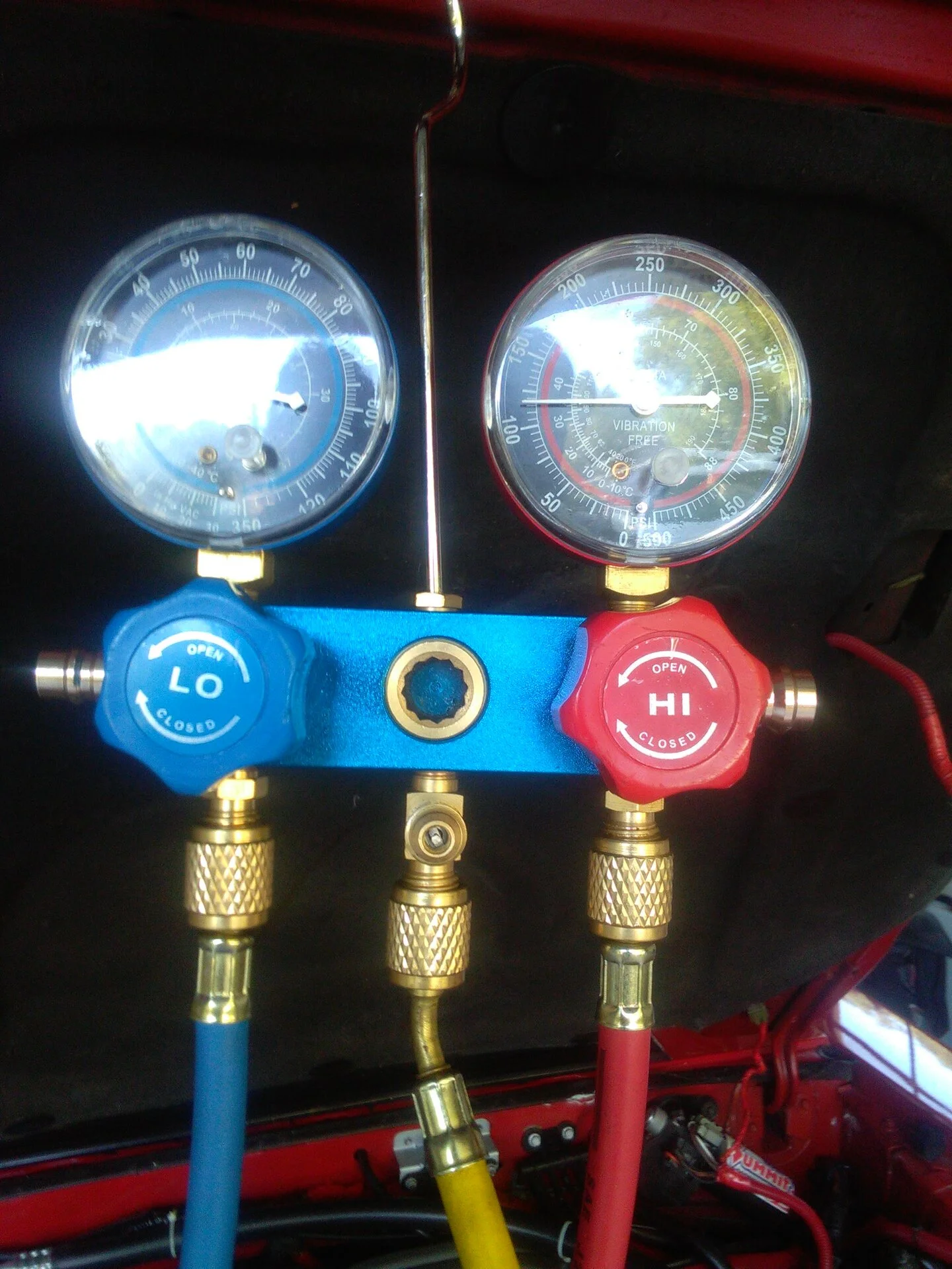

SOMETHING IS WRONG......Not getting cold air I think I screwed up and the pressure went out the vacuum pump....Re vacuuming because I was stupid and left the yellow hose hooked up to the vacuum. The good thing I hope is that its getting flushed again. Also the compressor is not exactly in line and needs to be moved with spacers. I thought this was going to be easy , but nothing has been.
Going to start again sunday morn. Orafice is clogged making the line freeze up at the orafice. Bought a new line with the orafice filter in it. I flushed this good so I dont know. Hope it works will see how clogged is clogged
I give up for a while debating on flushing the system again. Very cold going into the firewall. 35-40 low side 85-105 high side. Everything seems to be ok, but warm air at vents...Flapper door in dash works well. is there anything in the dash I could be missing any relay. If my new freon was contaminated at all would it just not work .
Your high side numbers should be higher,it's like your low on freon.low side 35-40 is good high side should be closer to 250.
