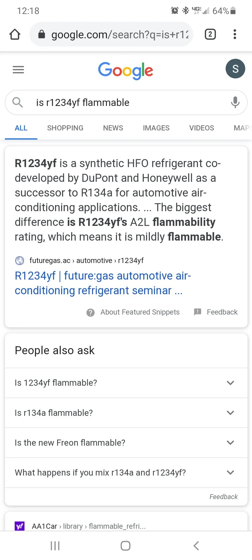

At work I use the normal AC machine...the new R1234yf thats in everything new is a PITA...and flammable. R134 doesn't get as cold as R12...and R1234yf cuts out at highway speeds under some conditions causing customers to panic. Nowhere near as cold as R134.

And flammable? I remember not that ago people in the old Mustang community used to point to how people in Mexico would use propane in their AC systems. Of course, the first argument was that it was flammable.
Yup...it catches fire but the flash point is higher than propane. Takes some heat but it will flare up.

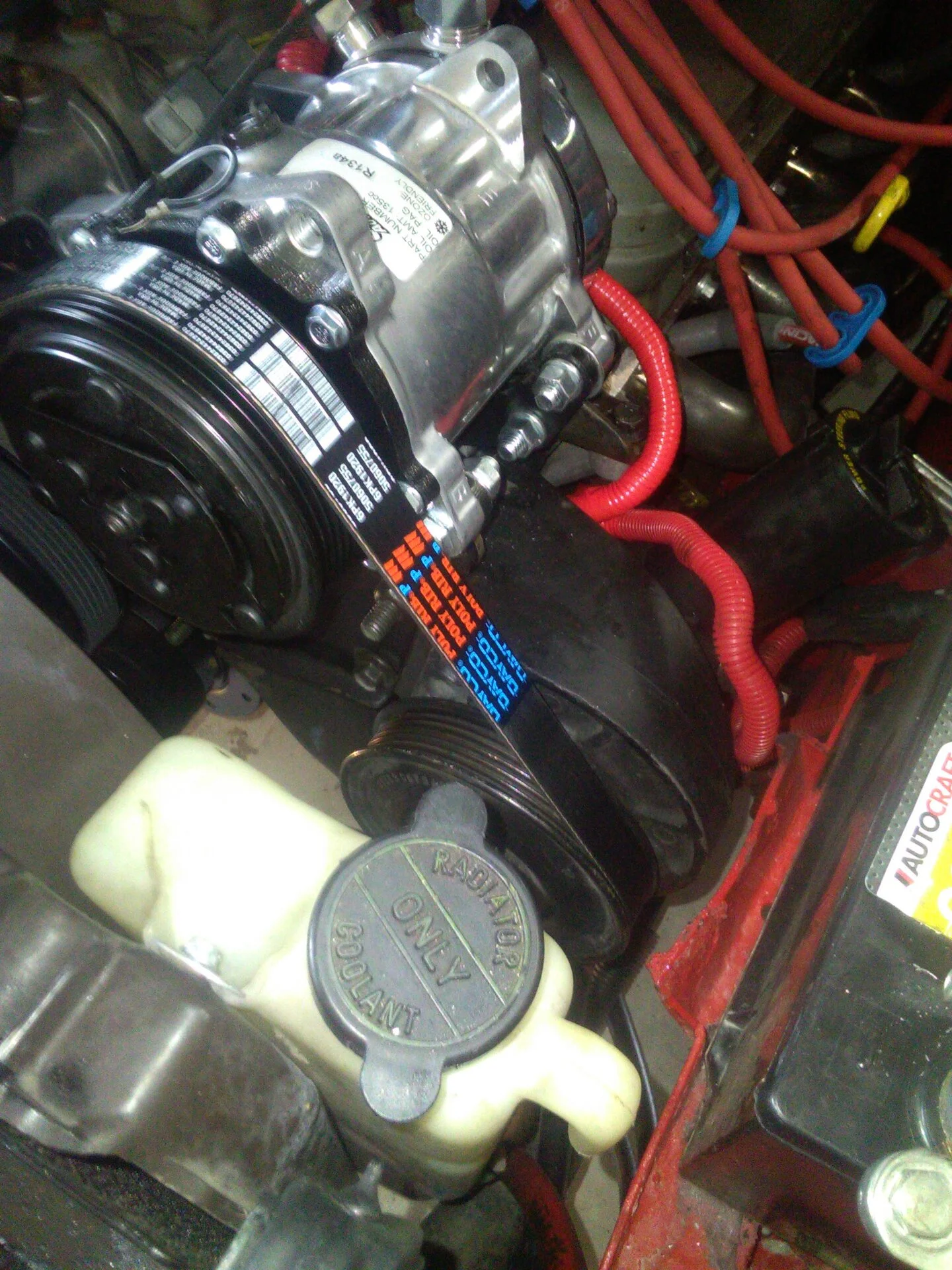

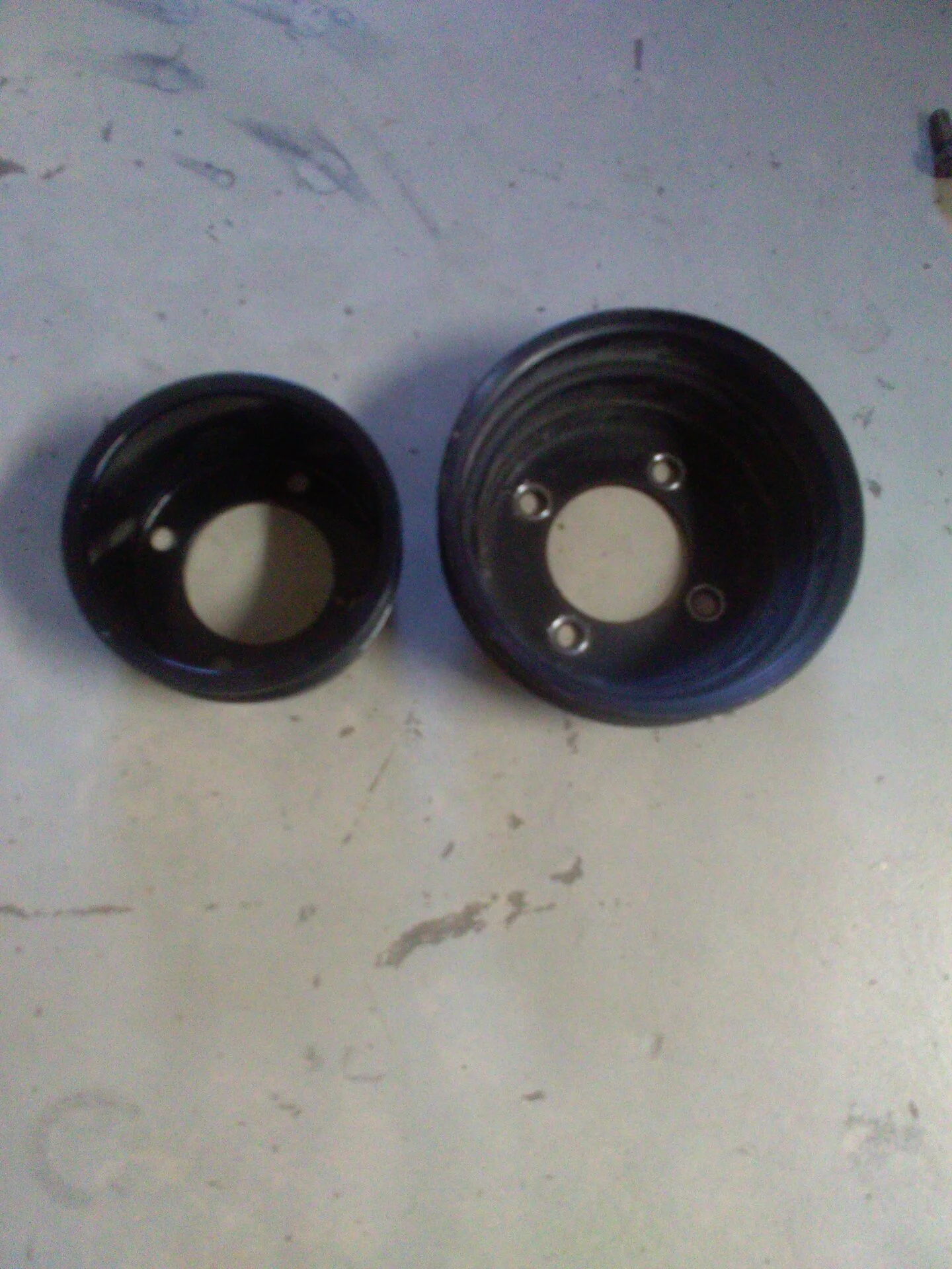

After having my belt start to fall apart I had to put on some under drive pulleys on that I had laying around. I could not find a belt to fit after going to three different auto parts stores. I have yet to take it for a drive yet. Finally my belt fits right. My new ac set up does not work because I think its contaminated .So I am going to buy a new condensor that did not come with the kit, and re clean everything. Very upsetting, but the car does run nice.

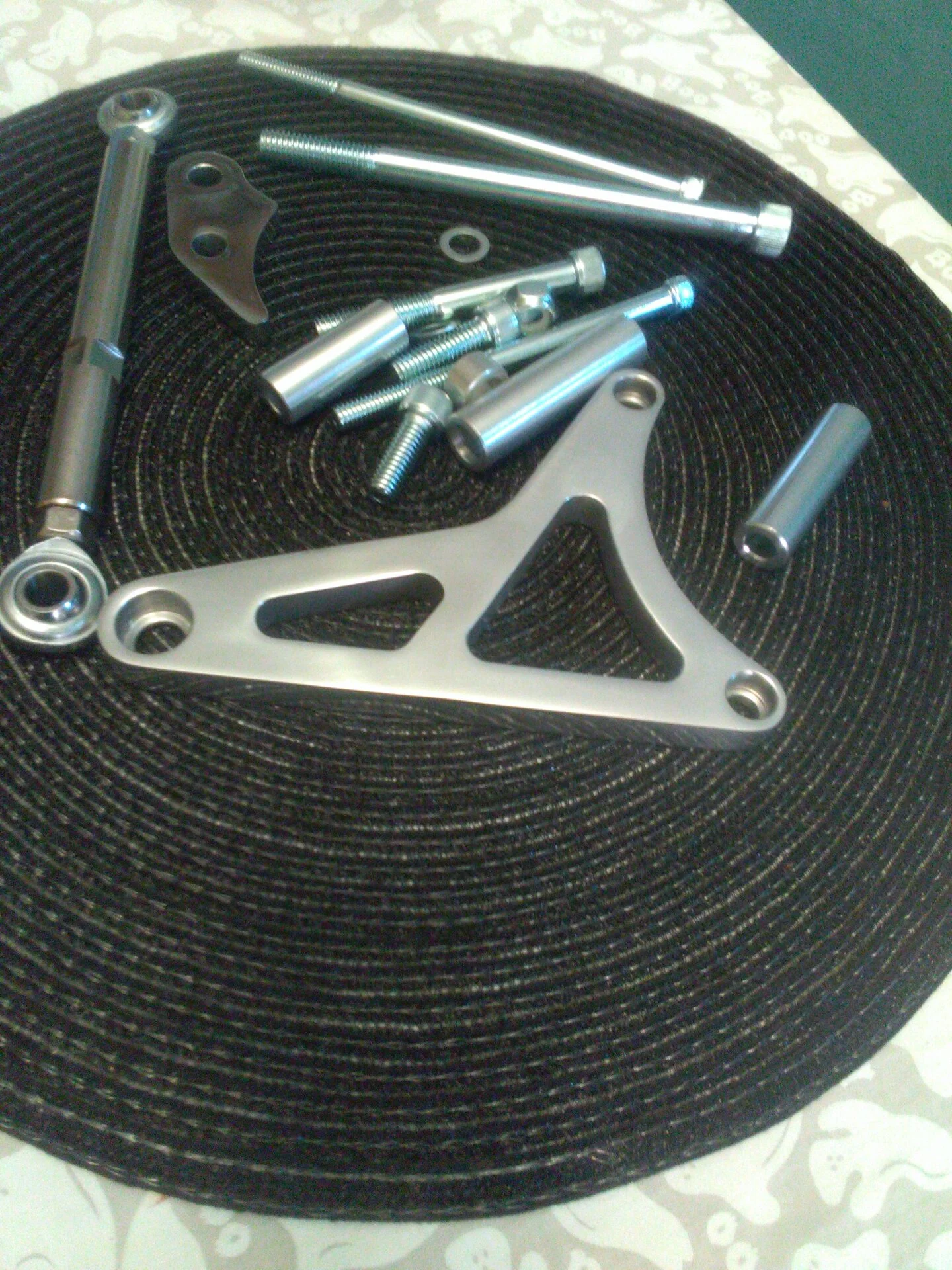

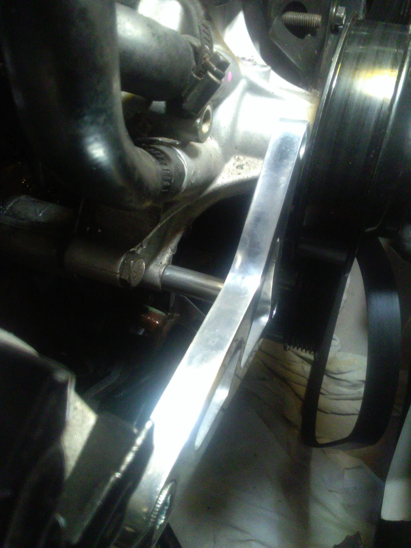

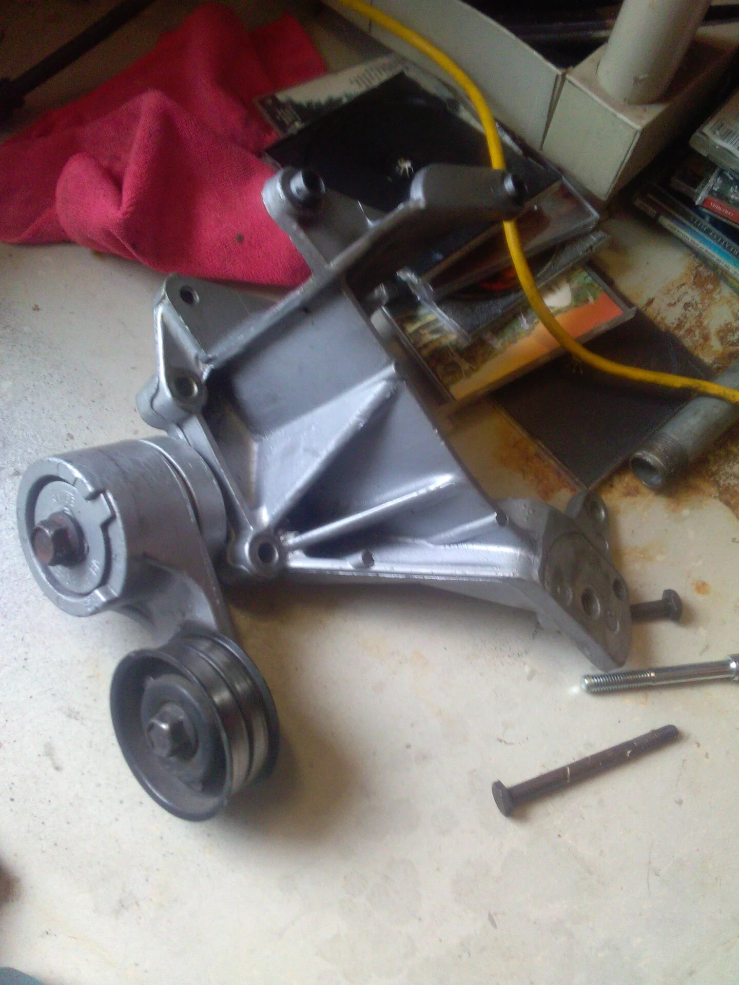

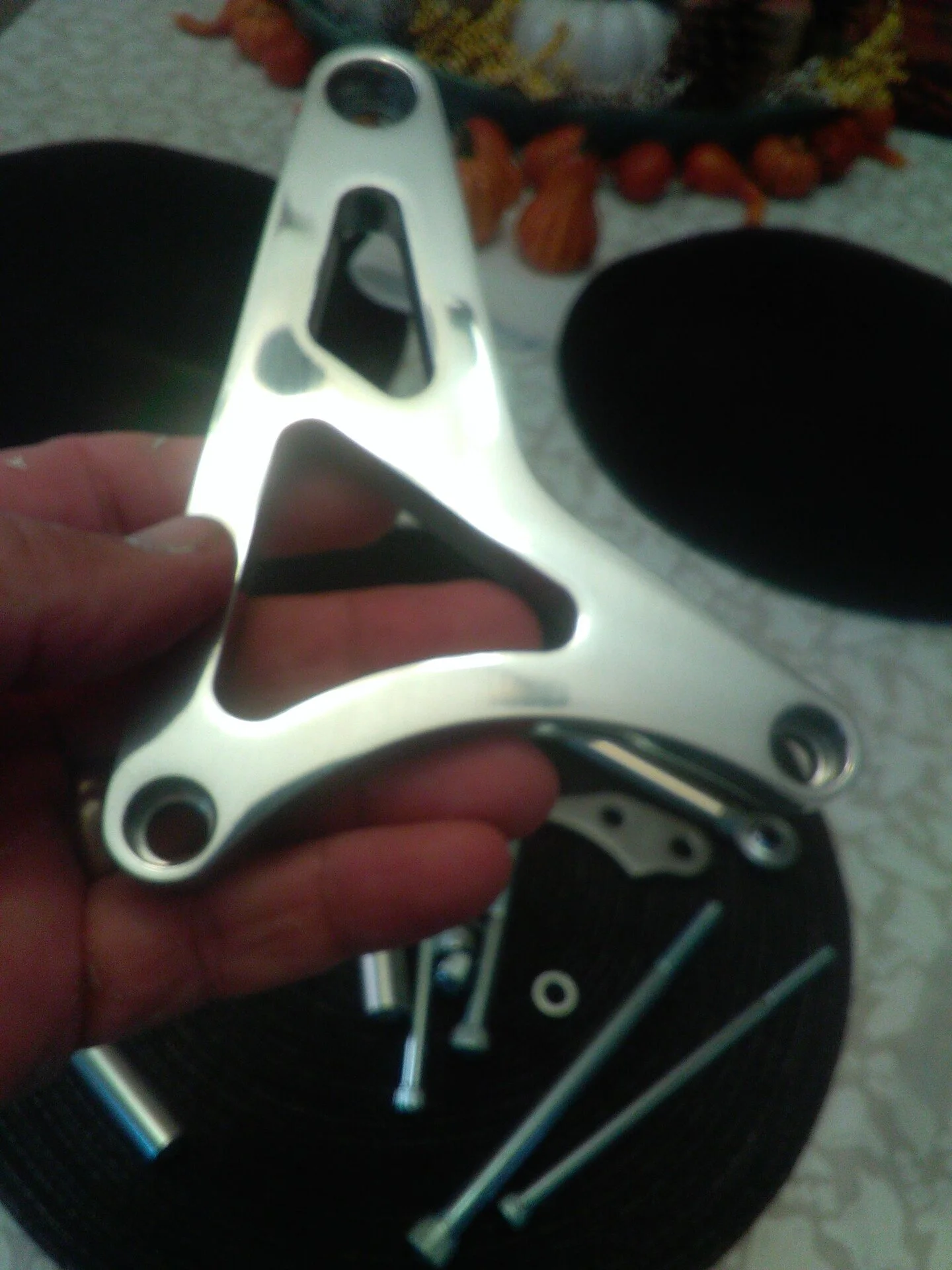

Alternator Bracket...........Ready to do one of these. I had the belt fitting nice. Then the thing stretched and is touching. I have fought this problem for three years. Unreal what a half an inch does on these things. Putting this on Saturday morning. I was trying to avoid this because I like the stock look and now I have a pile of stock crap in bags that you need to save. This is a nice piece . Very smooth and nicely chromed. I will do a step by step.

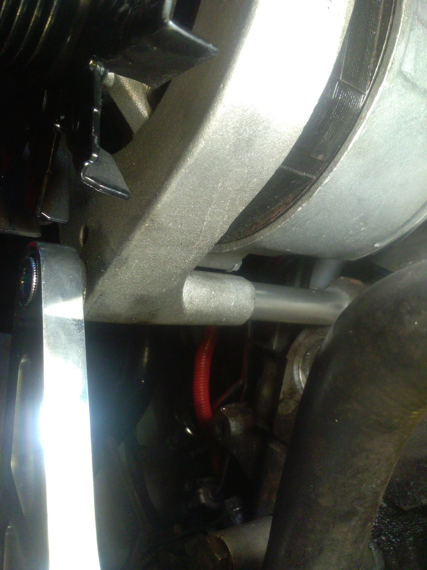

Do you guys ever wonder how come foxes have so many different size bolts. Some standard , some metric. This bracket has three different sizes. It also has the tricky half inch one that is hidden. I am working on getting rid of the tensioner for the adjustable bar.

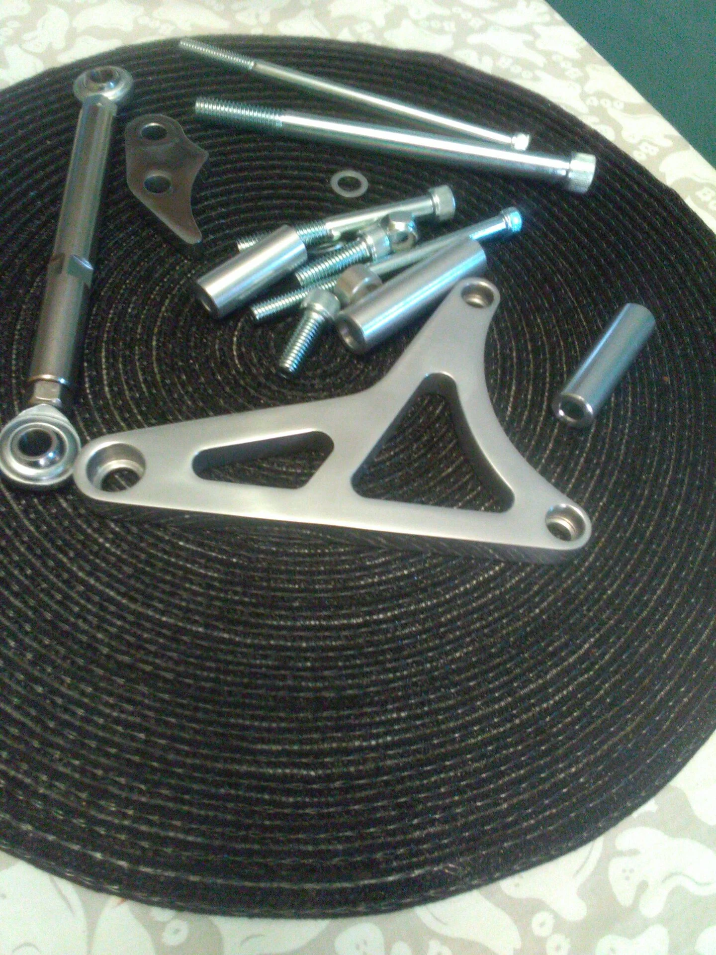

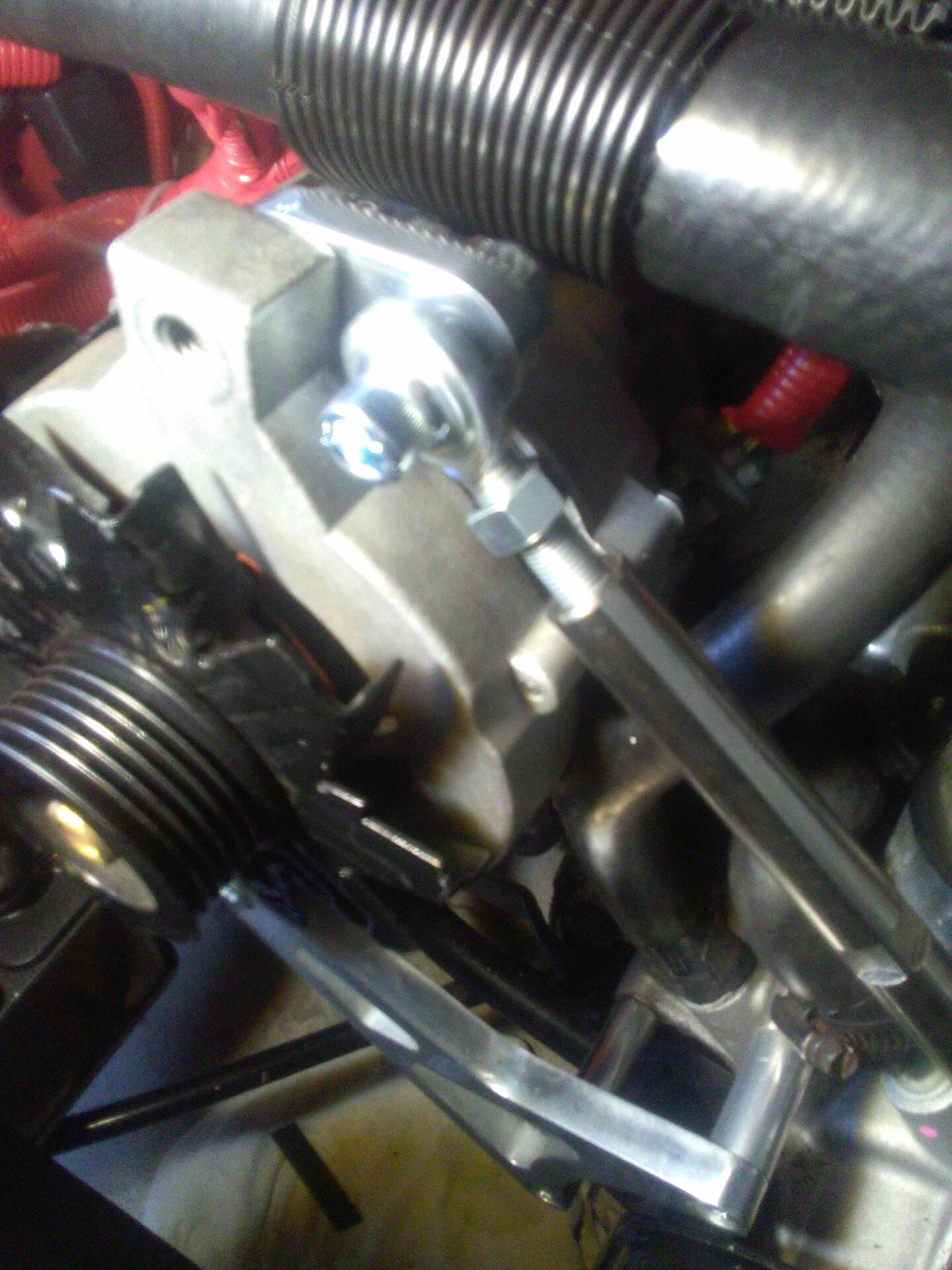

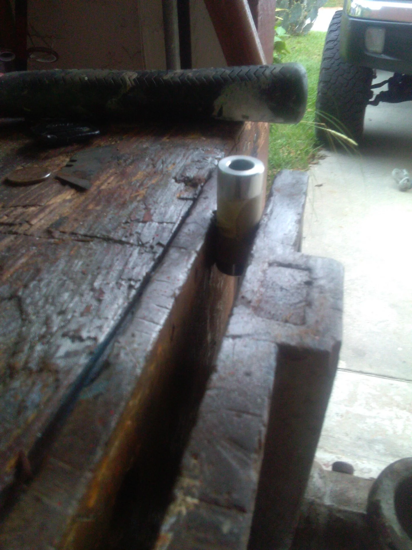

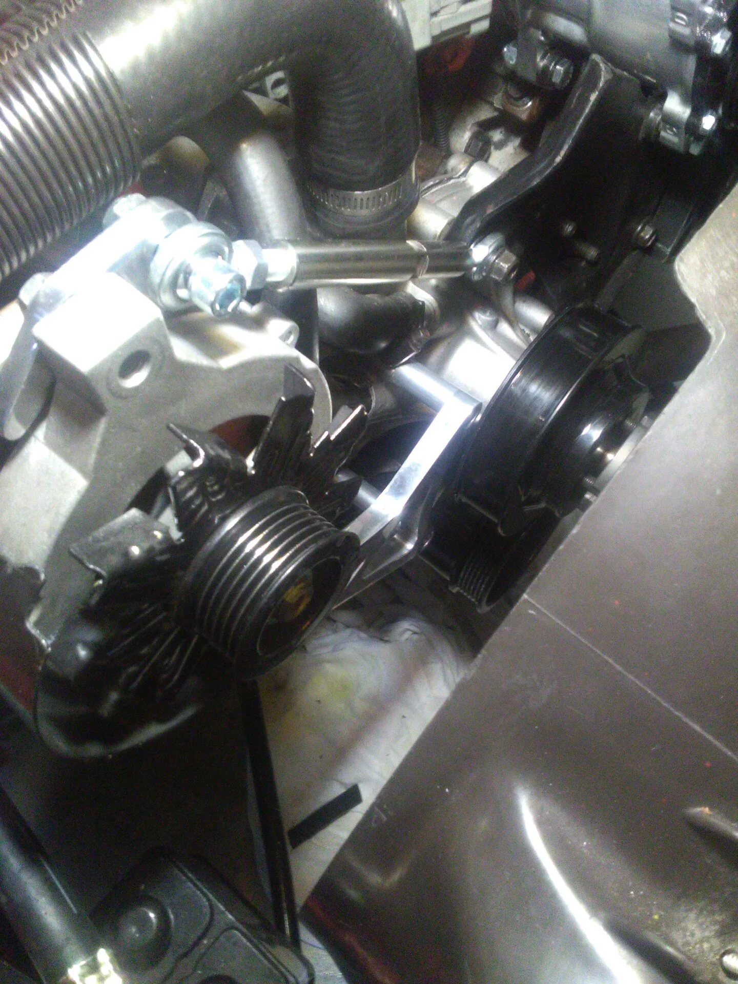

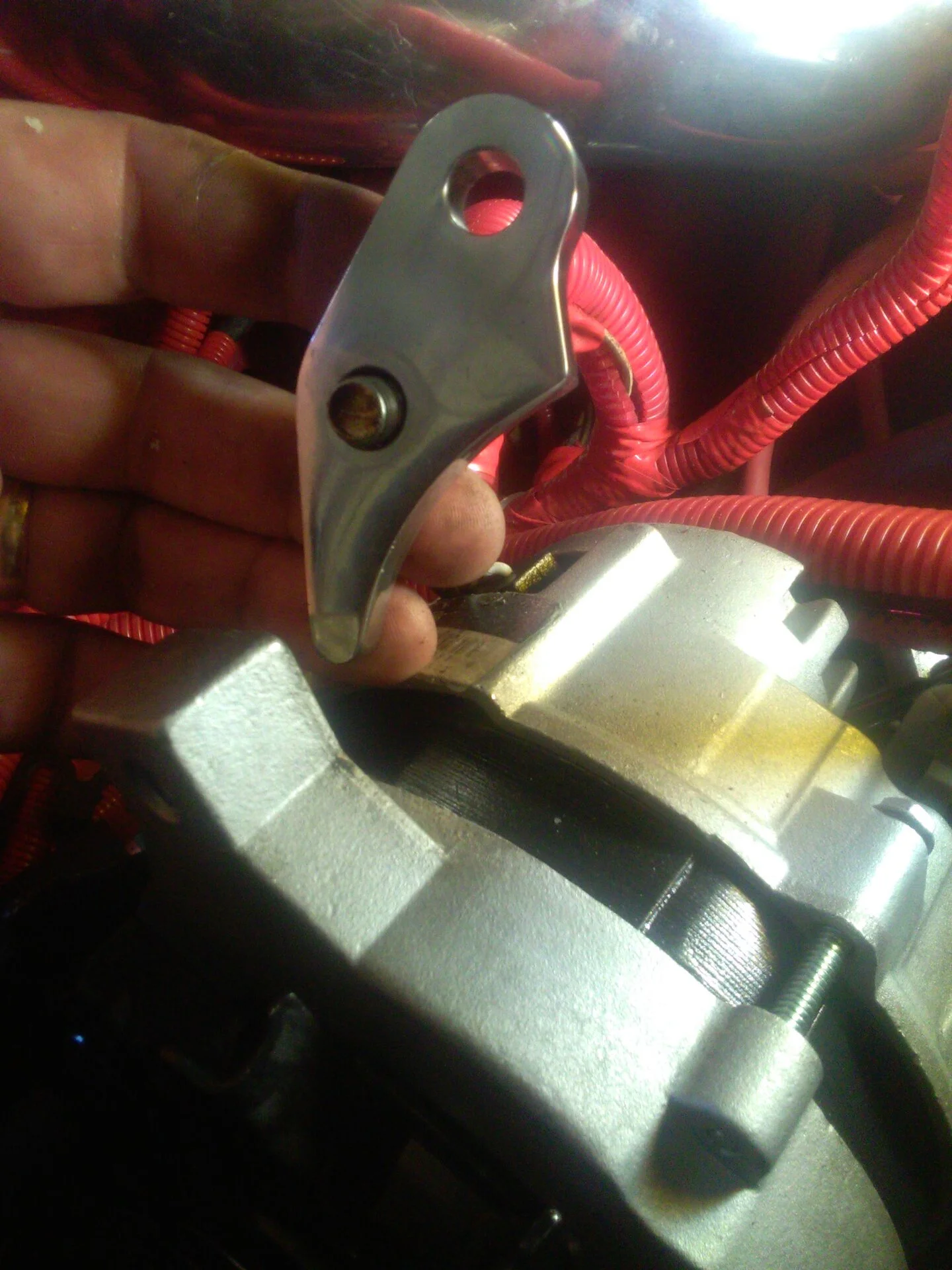

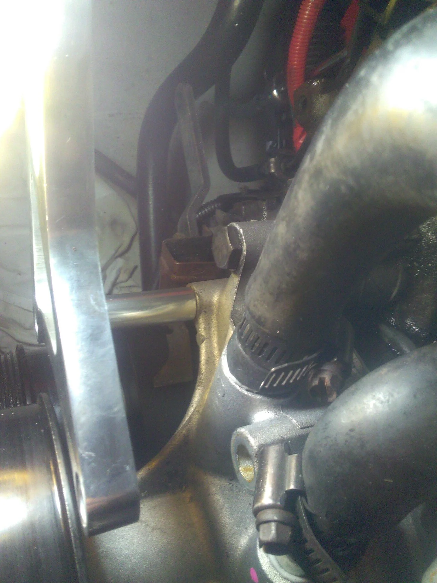

Just a quick set of pictures with spacers. No instructions come with this kit. Only one U Tube video on whats up. Just some spacers and bolts go on the water pump bolts. In the video a spacer has to be cut, and mine also needed it. It would totally confuse a person that did not watch the video. The reviews on this thing had several people who sent it back because they could not figure it out. I had to get another belt. I have been through at least six belts on this whole quest. The bar has much less adjustability than I thought.
