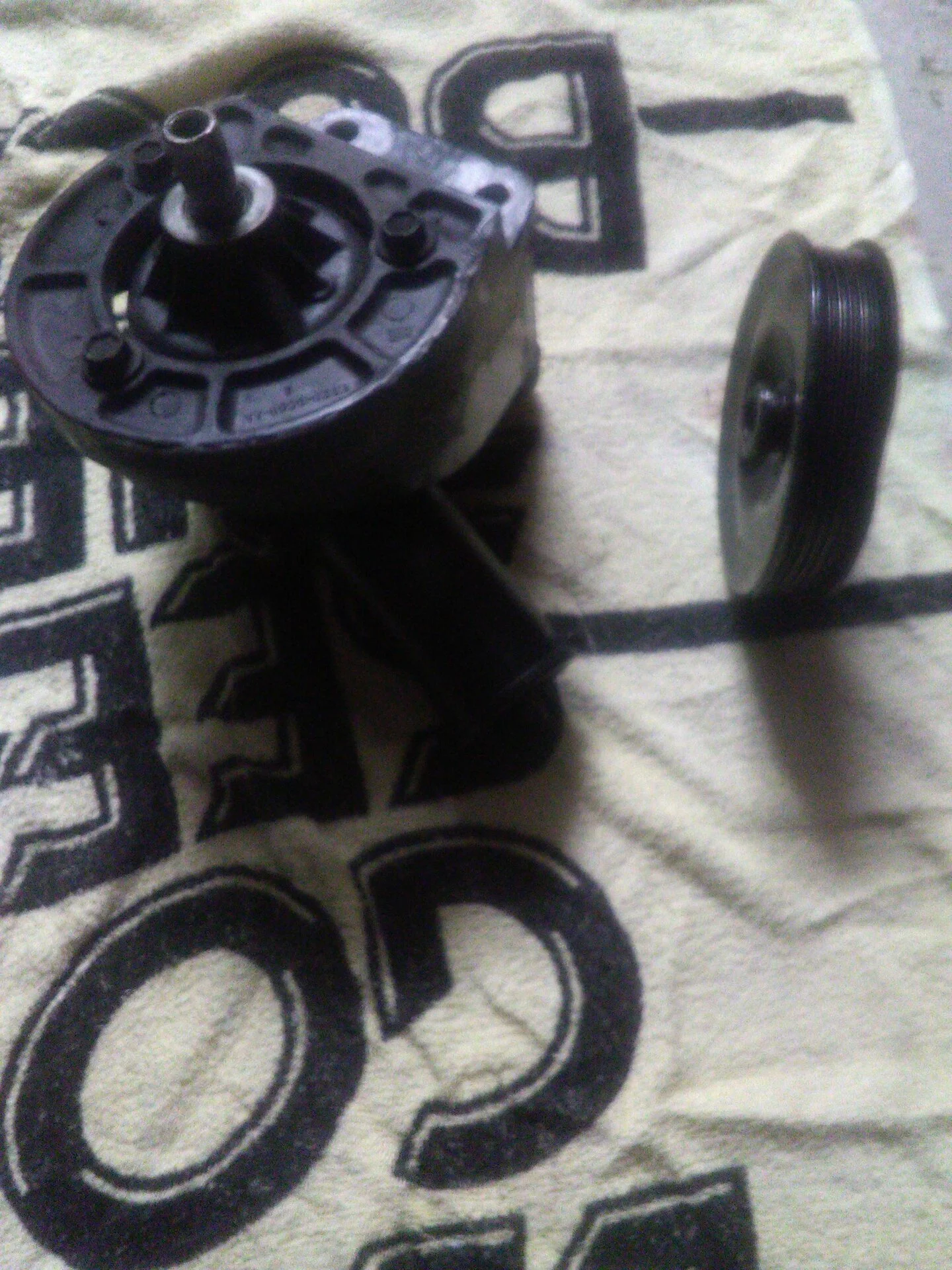

Just went to start the fox and I hear the sound of two clinking metal rods clinking together. Its my Cardone power steering pump thats three years old. I call Advanced Auto and if its covered under warranty. Says lifetime on the computer. He says bring it in and we will replace it. Luckily I order all parts online and have pages of parts listed. Taking it off and bringing it in.

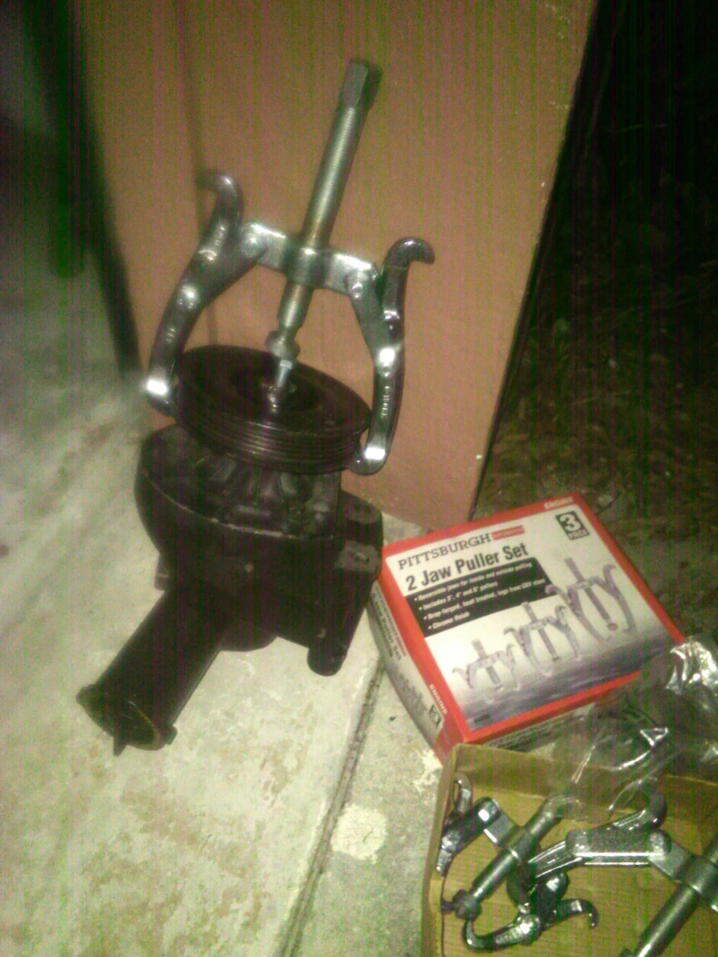

Never thought I would use the Three Jaw Puller more than one time. I thought there was a bolt on this pump , but the pulley pulls off.

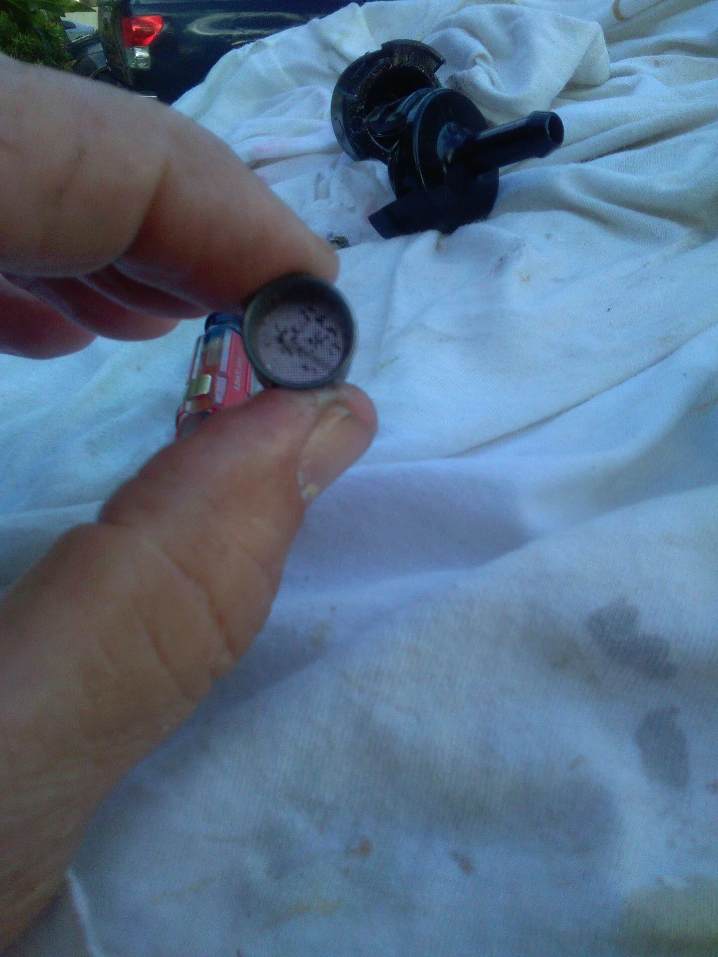

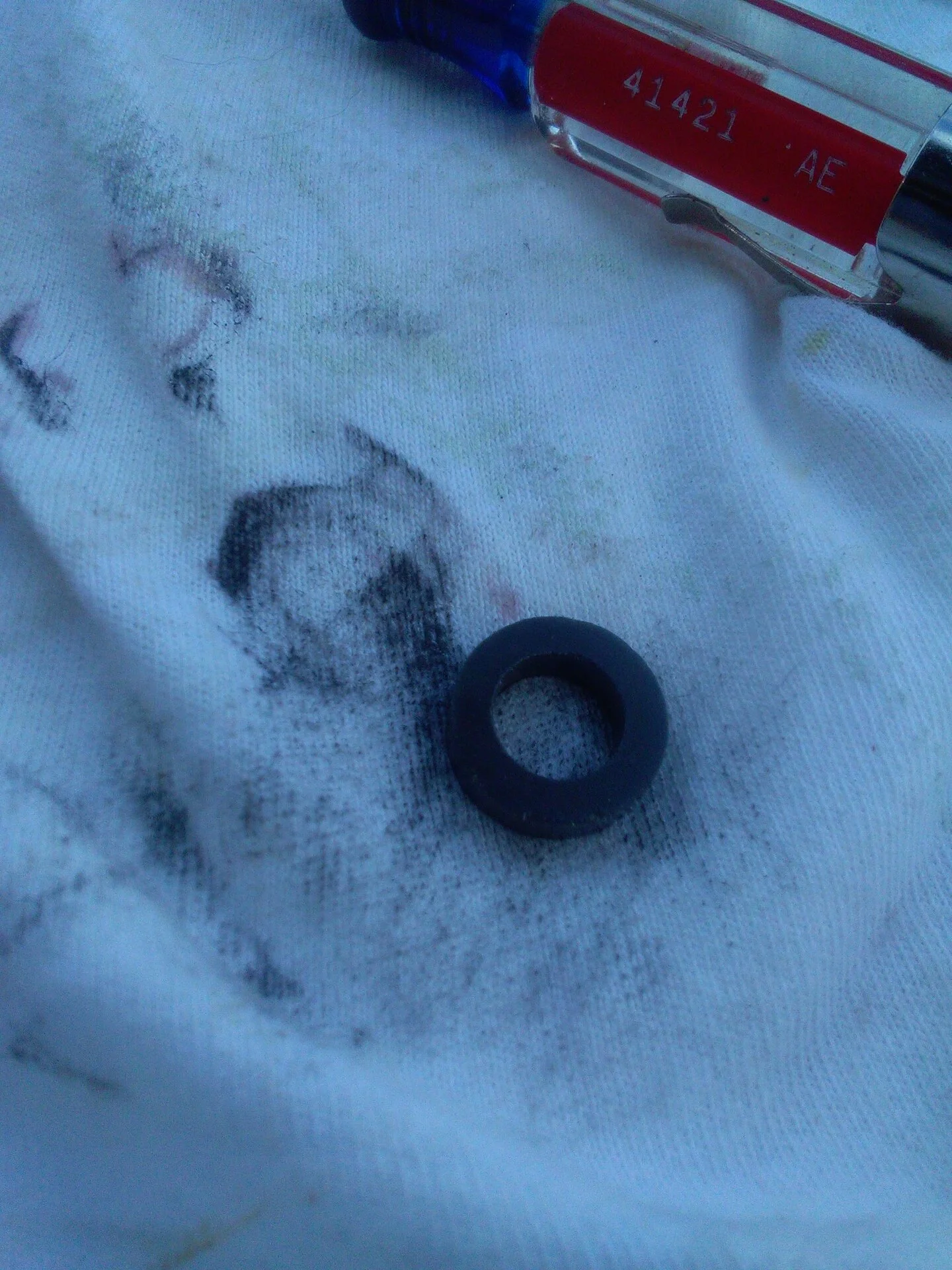

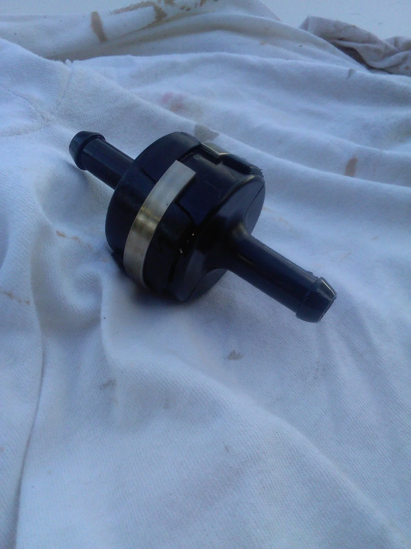

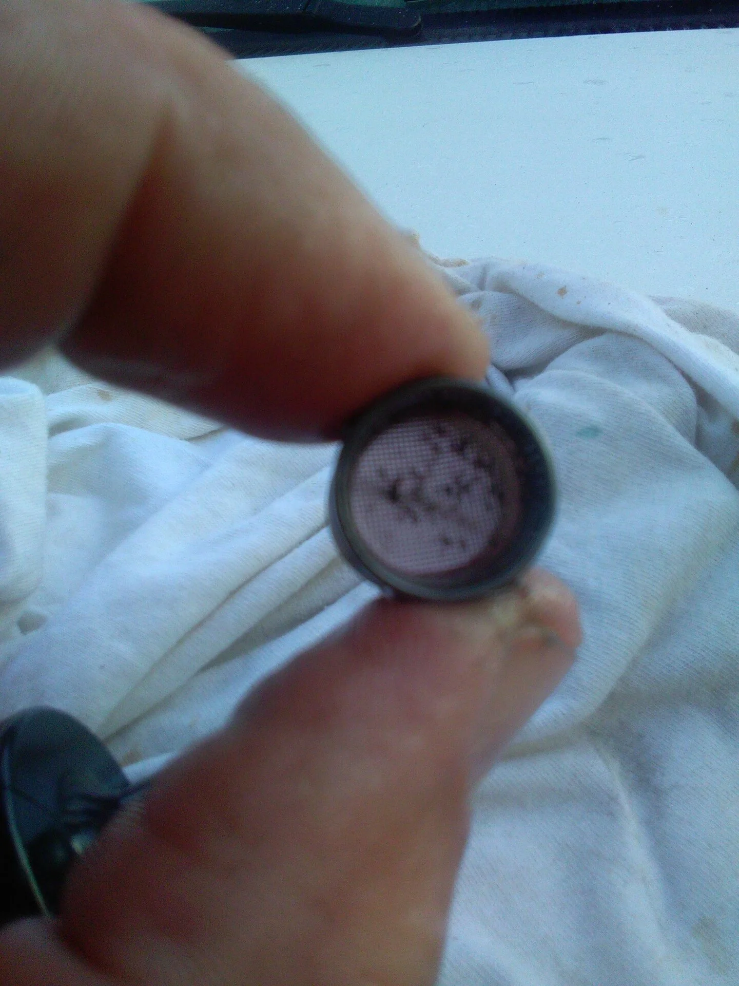

Now for the fun part. Lets see whats in the power steering filter. I got this because there is no guarantee on my rack without it. The washer-magnet had a layer of very fine dirt. Look at the screen . Good or bad who knows but I like this filter. Now to go get my new pump under warranty....I hope. I have taken this car apart so many times I had it out in an hour. A lot of crap has to come off to get it out

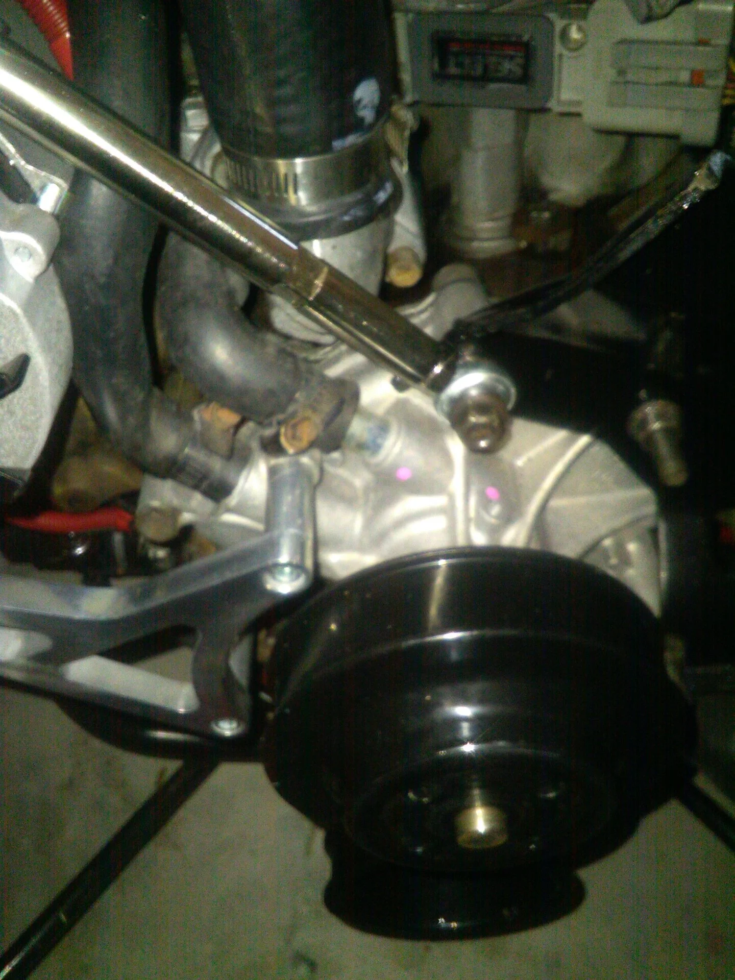

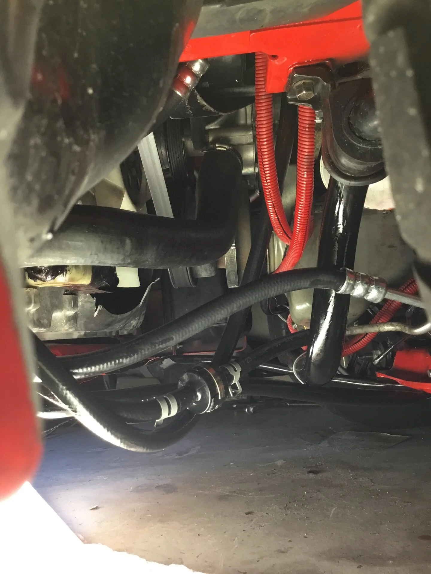

For anybody that is going to get one of these brackets . I had it on poorly before and this gave me a chance to grind the accessory bracket down so the pivot end would fit it right. I had it jammed in before. This is really cool now. Plus I found lots of my bolts were not tight enough. On my way to driving again. Hope it was the pump. Why is the pulley need to be pressed on. Mine is all messed up from being in the vice so many times.
