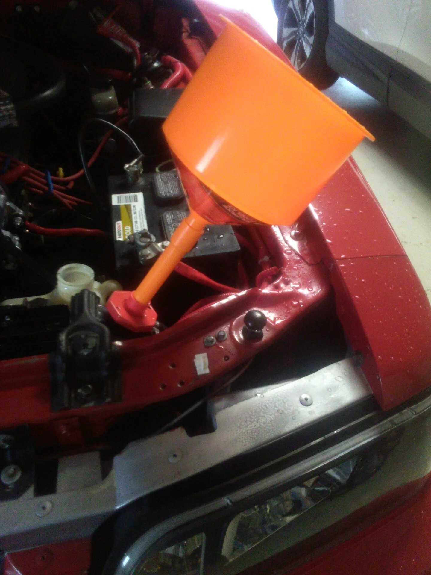

Amazon sent the funnel set next day. Seals tight and works good for sixteen bucks. I believe its fixed it took lots of fooling around I dont know whats going on. Never had this much air in the system. Florida sunrise at six thirty am on my way to Ft. Myers

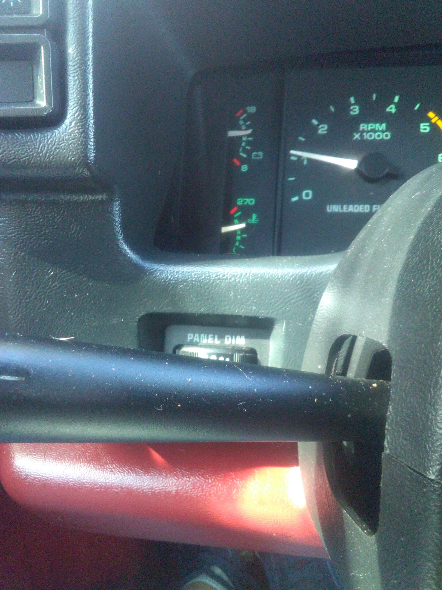

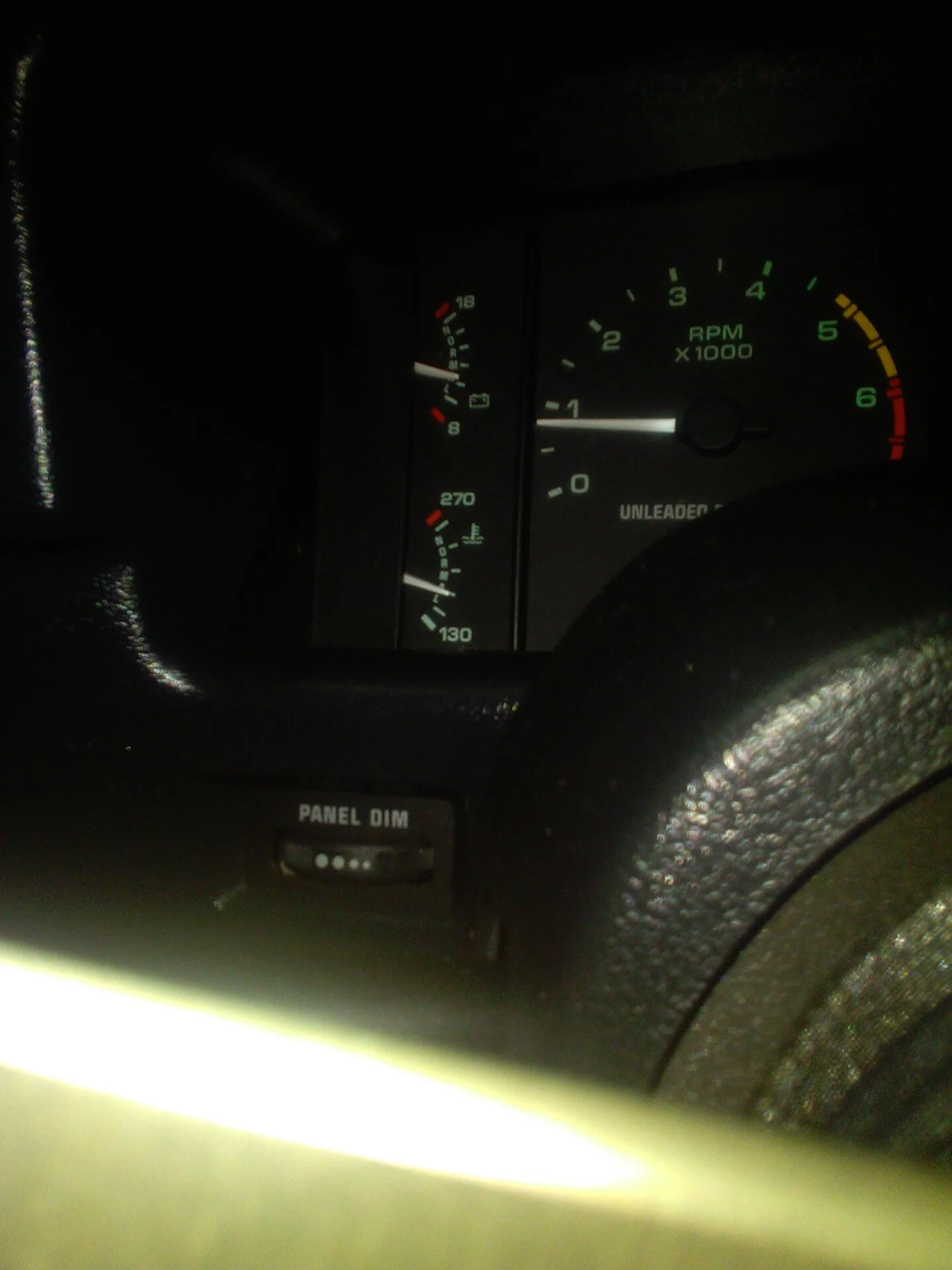

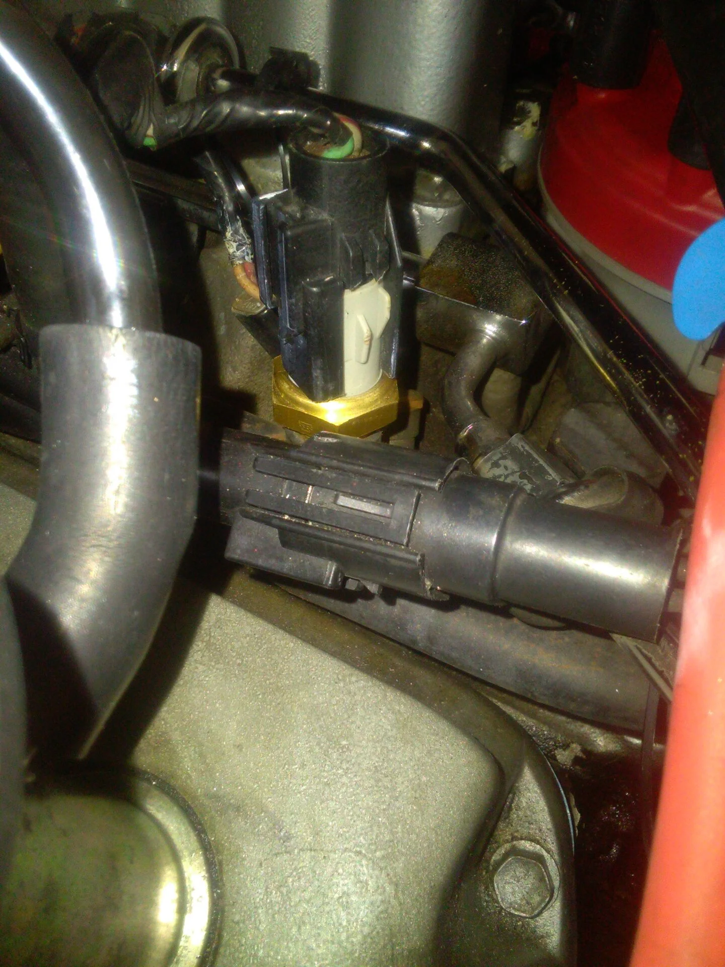

Just went out to get my wife a few things and see how this car runs- It runs smooth and fast. Still shows hot although it doesnt seem hot. No smells or pinging it stays at the same temp and never goes above where it is on the gauge. I replaced both temp gauges but this one was the culprit of the change. Just put about ten miles on it havnt done that in a few months. Merry Christmas to all pretty soon off to my bi-yearly church visit.

You might want to look into getting a auxiliary coolant temp gauge. The stock one notoriously sucks.
why’d you switch the temp sender to begin with? If the old one is good you could reinstall it and see what it reads.
Yo, Pete, I'm confused (should not surprise anyone here), you talk about the reading on your temp gauge after you changed a broken temp sensor, you show a pic of the ect sensor, it has two wires and is mounted to the heater tubes, it communicates with the computer not the temp gauge. The temp sender communicates with the gauge and has one wire.
Which one did you change?
