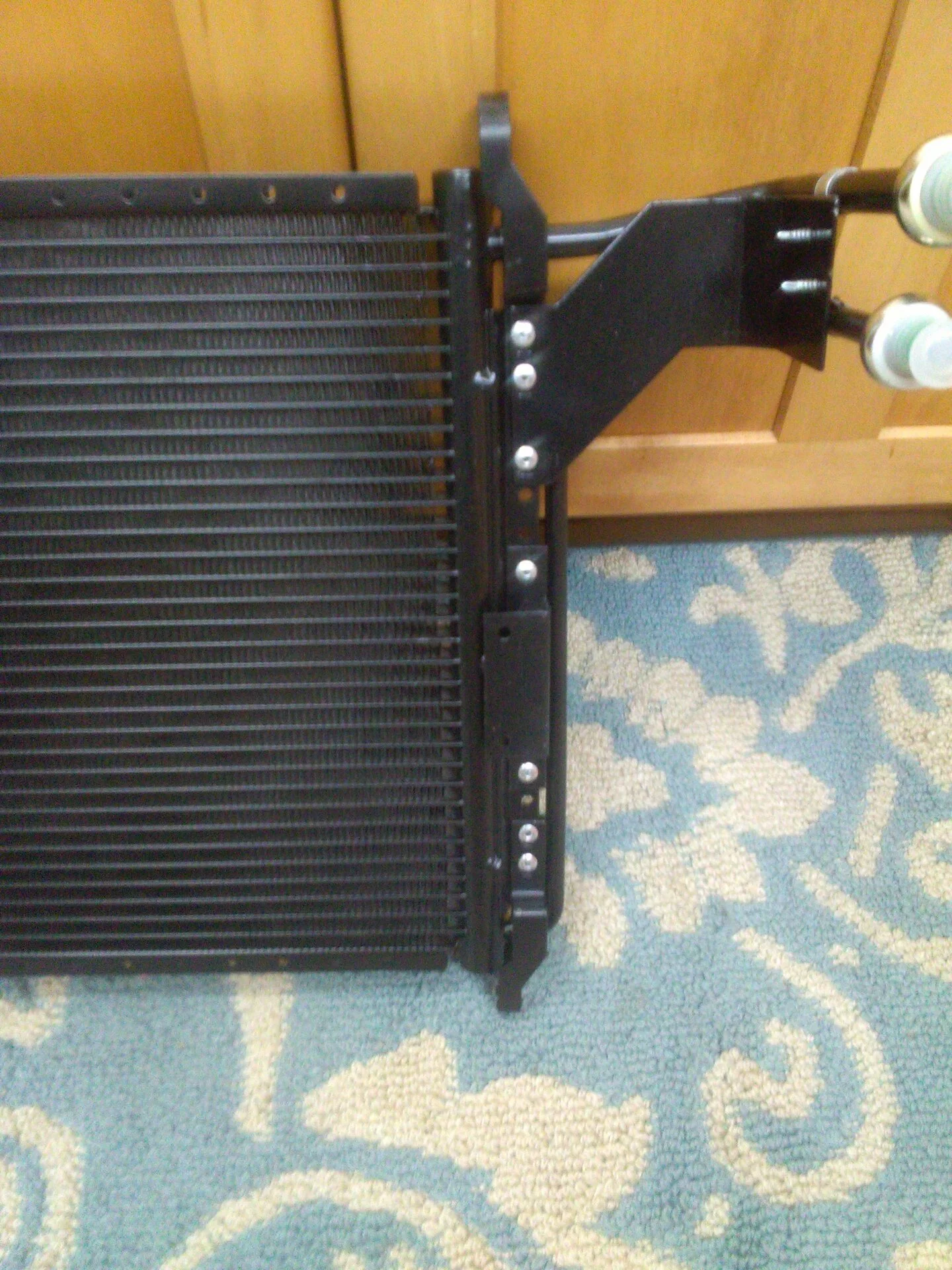

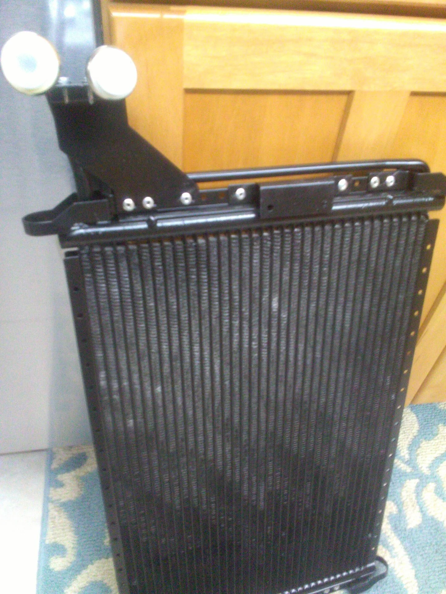

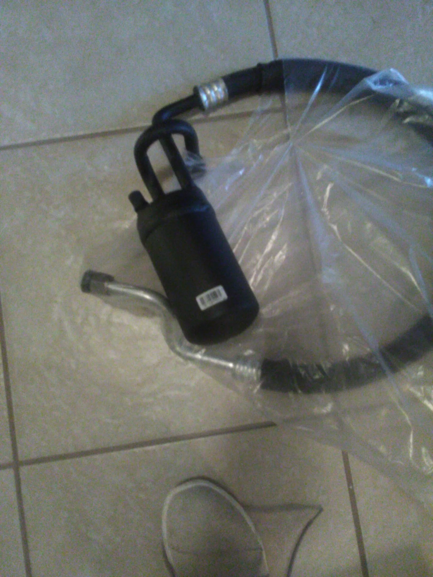

Got home to RockAuto on a Sunday. Three day delivery , and all well of coarse. The condensor is really nice quality with thick powder coat. Dryer is just a dryer. The one in the picture was shiny. This one not. I did not like $23 delivery $12 tax you get spoiled with Amazon and LMR. I need to check in with Monkeybutt he got a Ac 134 redo and his works. Now need a complete clean and try again....Hope all is well with you guys

Pete,since you are going to flush the a.c. ,you should look into ES12a.I've been using it for years now, it's colder then 134a and you use less and there is less head pressure on the compressor. It's compatible with both oils and doesn't need to be introduced into vaccumm.It has been a win win for me in my stang and friends cars.
But don't take my word for it or anyone else's , do your own research like I did,dig deep and you'll see the truth.
I use ACpro from advance and Esther oil for the compressor. Blows cold enough to send vapor out the vents in the hot summer days. No vacuum...no issues. Your compressor is different though.
I am going to use ac pro.....Last time I used H F generic I think. Thats all the had Johnsons is supposed to be good they didnt have it. Hope it works last time I think I had a lot of old oil and leak sealer of the old variety. Fingers crossed I got about $700 in this mess so far. The only thing I need to clean other than lines is the thing in the dash. Im going to work that thing like crazy
