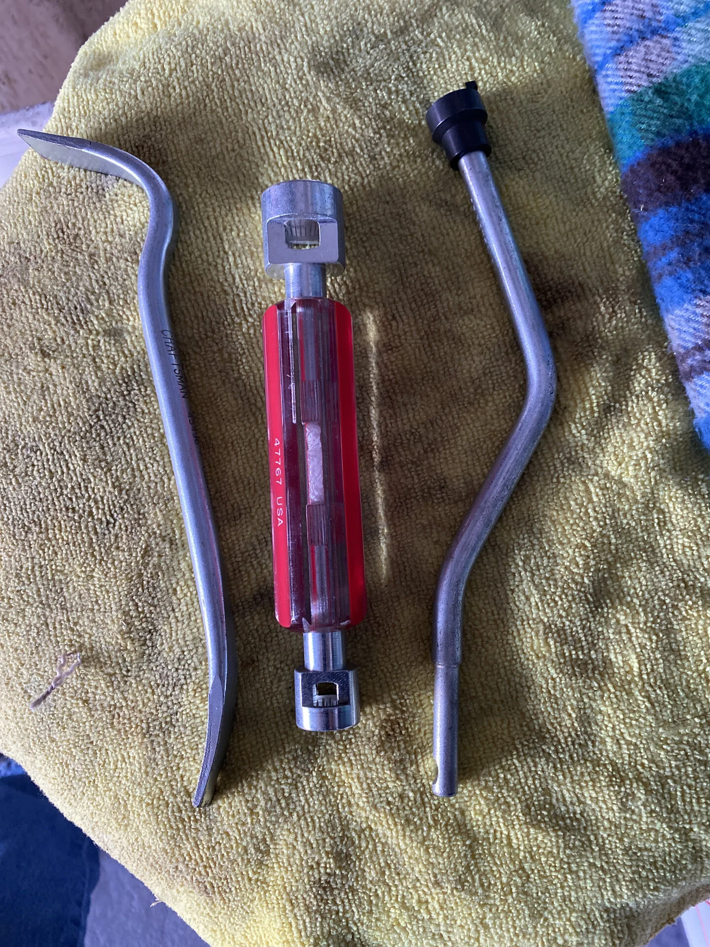

Rdub6
So while I wait to figure out my rear end issues
5 Year Member
Dec 29, 2017
3,958
2,939
153
Long Island, NY
Mar 21, 2021
#514
  • Mar 21, 2021
  • #514
Potomus Pete said:
I am going to do the rears soon. Just checking how bad, or what I need. I have not done these before so I got to get reading. Going to do four or five things at once. Just like you Dub in the next two weeks with pictures
If you’re going to do the rear shoes, pick yourself up a kit like this. It will save you from a lot of busted knuckles and curse words!!
Reactions: General karthief and Potomus Pete
