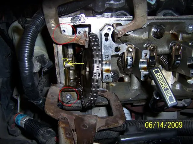

So I finally got around to swapping in some PI cams in my 98 gt. Started on the passenger side, got frustrated a few times, then finally got it in; no big deal. Moved on to the drivers side, and after some persuasion, got the old cam out. Began putting the new one in, and ran into a problem that I wasn't quite prepared for. I can't seem to be able to move the cam sprocket far enough towards the front of the motor to allow it to go onto the camshaft. There are two little metal pieces, one on the top and one on the bottom, of the timing cover that just aren't allowing the sprocket to slide forward enough. Here's a pic of what I'm talking about.
When I move the sprocket as far to the front as I can, and then sit the camshaft down into position, the end of the camshaft begins to bind on the sprocket. And I obviously can't get the sprocket onto the cam if they are binding before the cam is even into place.

i had the same problem, you just have to tweak it on, it will eventually go on..........

same problem here....this is what i did and it worked great. take out a couple of the top bolts that hold on the timing cover. then have a buddy gently pry the timing cover away with a screwdriver and the cam pulley will slip right over. really it may sound bad but the amount of "pryage" is very little. give it a shot. it worked great for my car and the half dozen or so i have done after.
