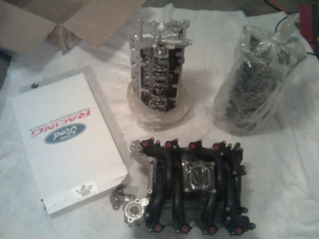

i have a nice set of pi cams in awsome shape from an 02gt w/32k miles on them i'll sell them for $100. i bought the complete set of 02 headsand had them redone with comp cams 270's and bee hive springs and they are romeo heads. when i had sent the heads out to be done the guy told me that the pi cams were in great shape. if your interested let me know.
