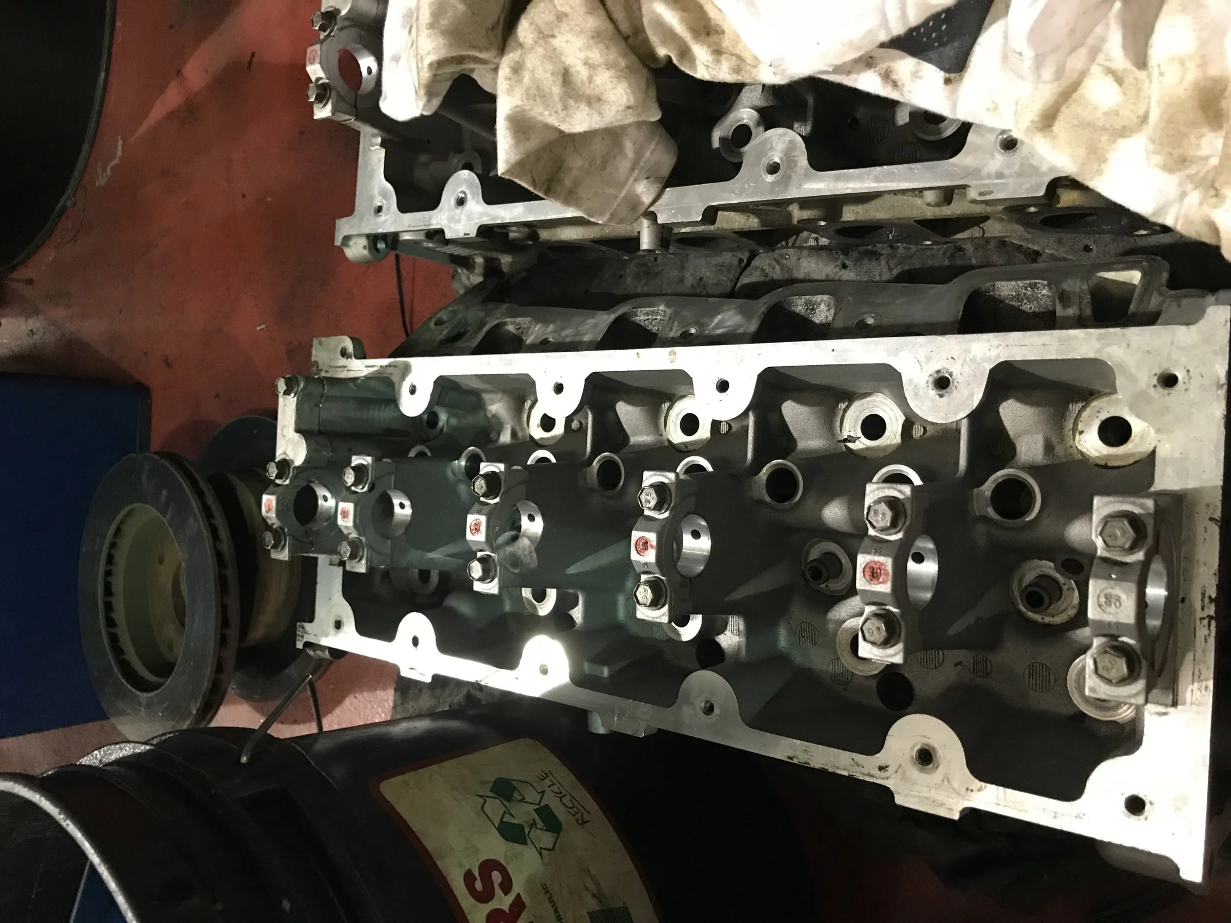

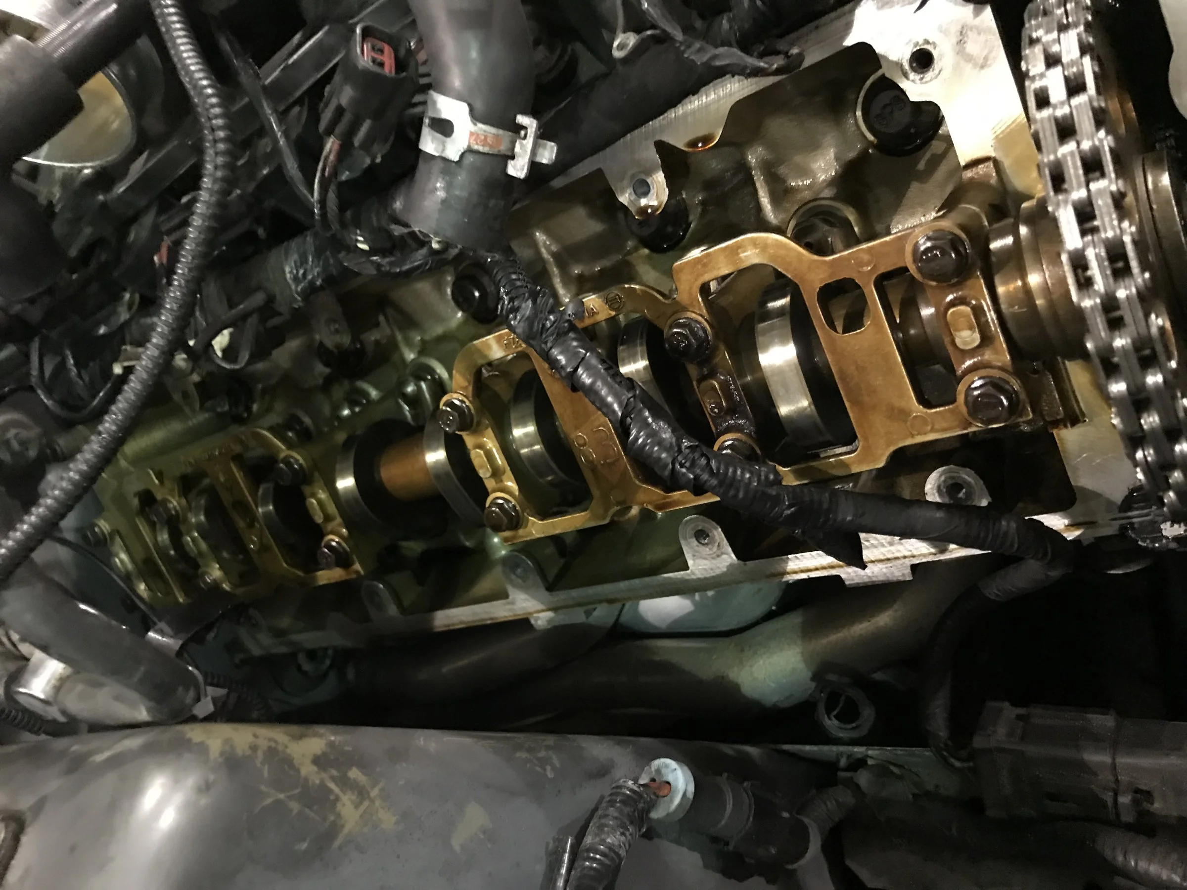

IMG_0077.webp IMG_0078.webp hi guys! i recent bought a set of pi heads off an 03 mustang and i compared them to the ones in my car right now and i noticed that the cam caps were different, the ones on my car right now have braces on the caps and the one that i bought doesnt? is that a problem or would i still be able to use those heads?
This is what I was told:The Windsor PI head has separate cam journal caps. The Romeo PI head has the bridge-style caps. So no problem I believe, but I am still learning so someone with more knowledge will chime in.
