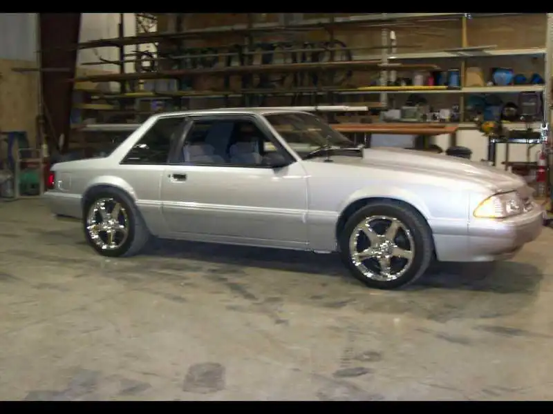

you make good points but your broad statements are just not true. of course if you are building an a race car and money isnt an option then you would want to go with a built shortblock with lower CR. nobody is arguing that point. but you can put the blower with low boost and timing on a headswap car and have success if you do not get greedy! i replied to your comments b/c of your condescending attitude and instant flame of other people. if you have all this knowledge, why not share it in a more reasonable manner? i am not going to get into the my d i c k is bigger than yours argument, but i am a bit more knowledgeable than you think...or was that comment an attempt to make you look good at my expense? :rolleyes: i do all of my own work as well as help others local to me do theirs as i know quite a bit about how these engines work. head swaps, tranny swaps, LT install, lash adjustment, you name it. i am very meticulous and do things right. i believe that is why i have MD after my name! my current project is an 89coupe with built 347 stroker (by me) with hogged out canfield heads and TFS stg 2 cam. ported gt40 lower with downs upper. procharger D1SC making 15psi. i have had my hands dirty a time or two! :) so lets end this BS bickering and move on.
here is a pic of the coupe it is going in. :nice: have a nice day.
pic...
