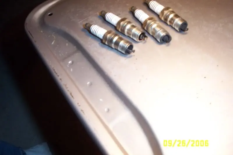

The plugs:

Did you install the rockers and then torque the cam caps? You really should have torqued the caps first then installed the rockers. Did you torque to 71-106 in-lbs.? If the plugs are black on one side you have ignition/fuel problems. You don't need new plugs since these are tough and can go 50k+ miles. Just wipe them off and re-install. DO NOT attempt to re-gap them. Make sure you torque the plugs correctly to 7-15 ft-lbs or whatever the manufacturer specs. I think you need to re-check your firing order and distributors. Also check your injectors sequence and test them. It sounds like you have a minor glitch that is holding everything up.
