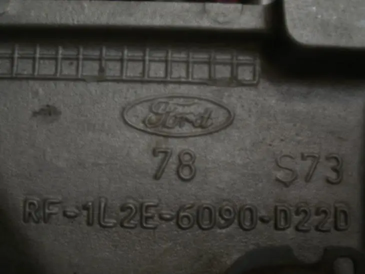

First of all, I should have been more specific. I'm not sure if it's a 2000. It might be an '01 or '02. But what markings would be on the head to indicate whether or not they're PI? I never saw the car this motor came out of so that's out of the question... Thanks.
should look like this on the head:
or starting with a PI if it's a Windsor head
