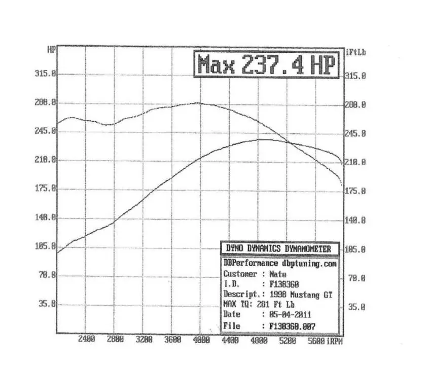

With a catted midpipe, catback, PI intake, 3.73's, MHS stage 2 NPI N/A cams, stock plenum and throttle body, and stock intake tube I made 237 RWHP and 281 RWTQ on a Dyno Dynamics dyno.
I've since installed an o/r h-pipe and a CAI, so these numbers may be a little higher now. FWIW, my car would likely put down around 265 RWHP on a dynojet as Dyno Dynamics tend to read 10% lower than Dynojets.
With a PI head swap you're looking at around 270 RWHP (on a Dynojet), but you'll lose some low end torque w/o the advantage of being able to run a more aggressive intake centerline cam with NPI heads. NPI heads offer much greater PTV clearance and this allows you to run an aggressive intake profile.
NPI heads + cams typically provide 15 lb/ft more torque in the lower RPM's than a PI swapped car. However, the PI swapped car will continue to pull all the way to 6000 RPM's and will give you 5-10 more RWHP (notice how quickly the power falls when my car gets above 5200 RPM on the graph below).
