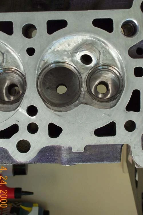

Hey...just port and polish your own heads! Not that big of a deal. Here's a pic of my roughed in PI heads (obviously not finished). :flag:
