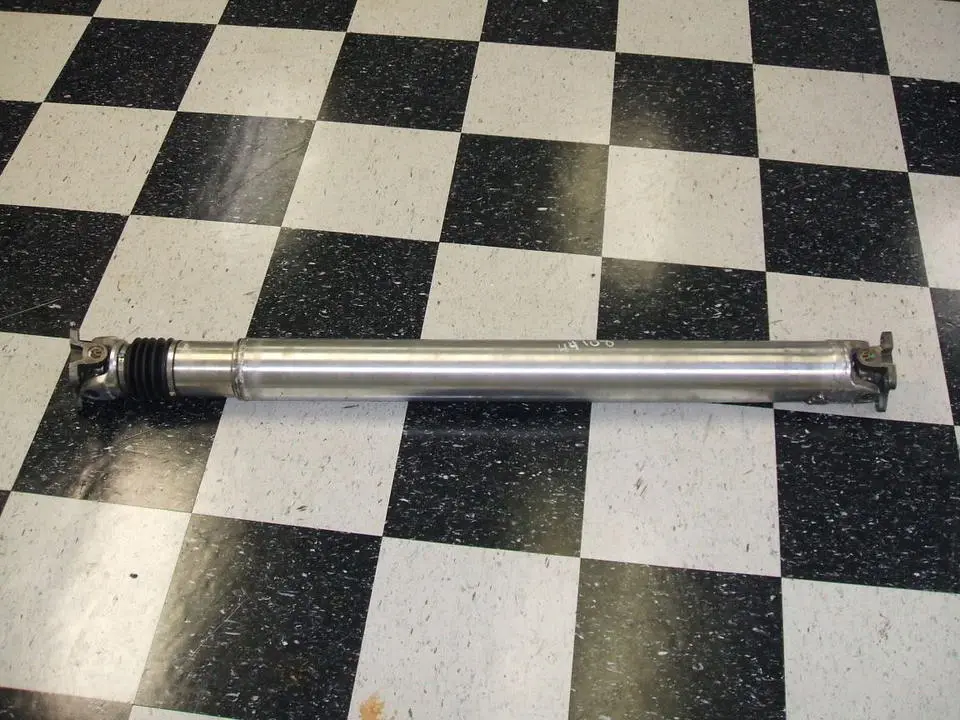

this is the aluminum driveshaft i got for my car from a local shop.
they sell it for 549.00 and it has held up to 538 rwhp and slicks so far without issue.
i have it out because im now putting in a aluminum flywheel and stronger clutch as i finaly toasted the stock unit.
