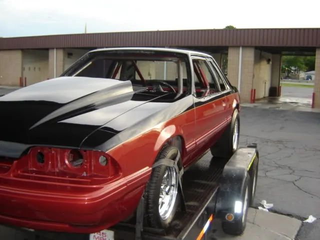

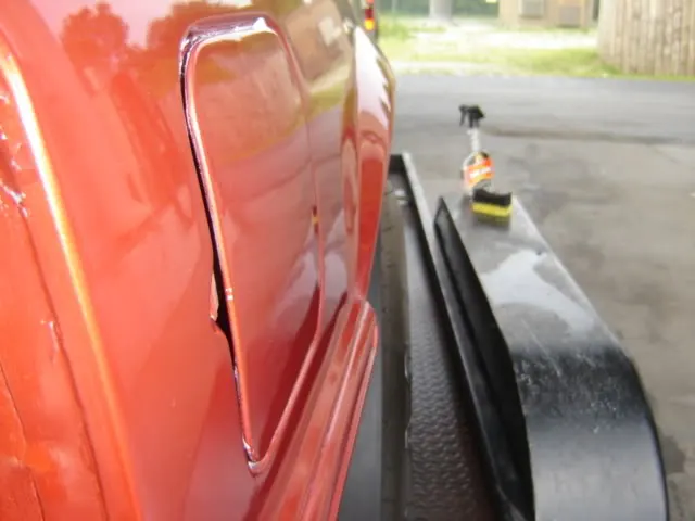

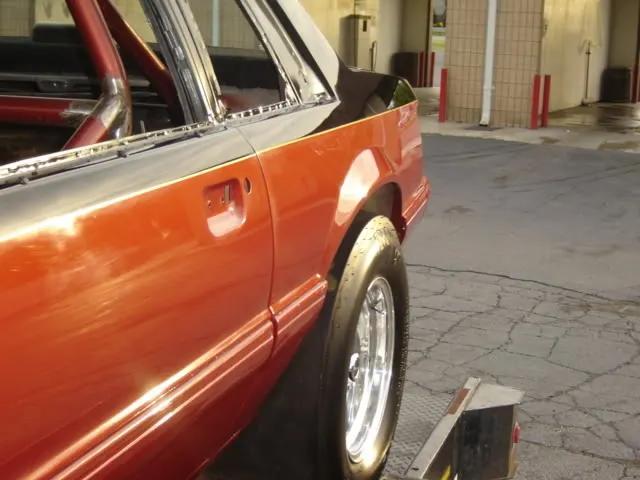

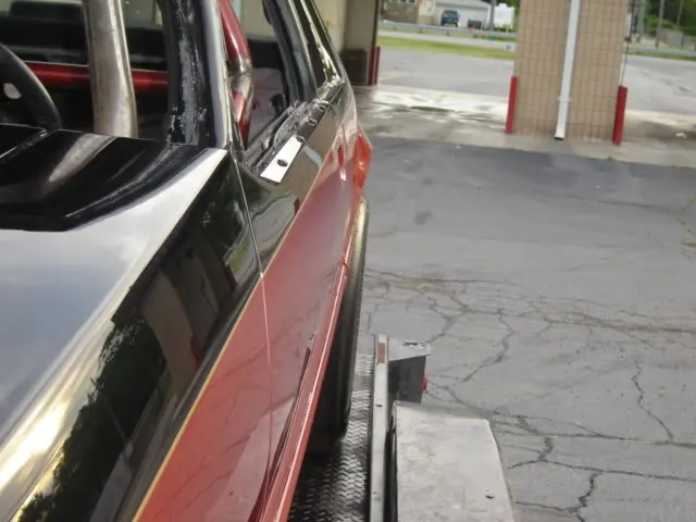

Thats funny mine fit with alittle massaging 15x10 with 6.5 backspacing & with real 28x10.5 et drag slicks..:shrug:
are you running quadshocks?
in my first post i was thinking of my car that has quads. i think it could work with quads. thats why i was checking if u had them. sorry for the confusion, and if you have quads then i am stumped because it sure dont look like i could fit that combo on my car without removing the quads ;o
