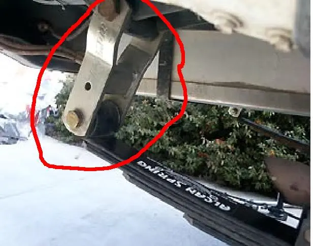

another route would be to make a pair of brackets to lower the rear of you leaf springs. HOWEVER they then stick out below the bumber and i dont think it looks as good, but if your tight on cash, this is the way to go. see the attachment fo this.

as most would tell you, they are an eye sore. as far as i know, most guys just made em out of somethin like 1/8-1/4 inch sheet metal. or some 1/4 ince strip metal. i'm sure you could find some that are already made and fitted, but whats the fun in that ??? :) im sure you wouldn't have a hard time finding some 1/4 inch strip metal at your local metal shop. happy pounding!

Shackles are the rice of yesteryear. They're not terrible, but they're not the right way of doing things.
