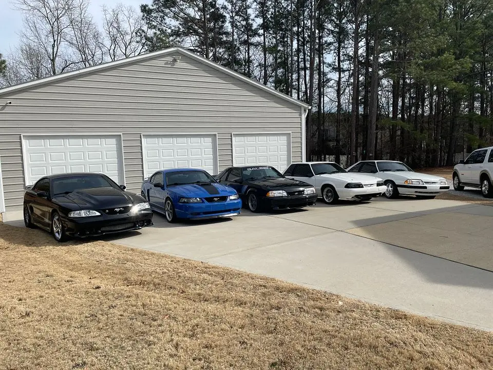

Got the windows tinted today (5%) and it looks so much better!
Grabbed a pic with all the cars together.

Nice collection!

5%, hot damn!

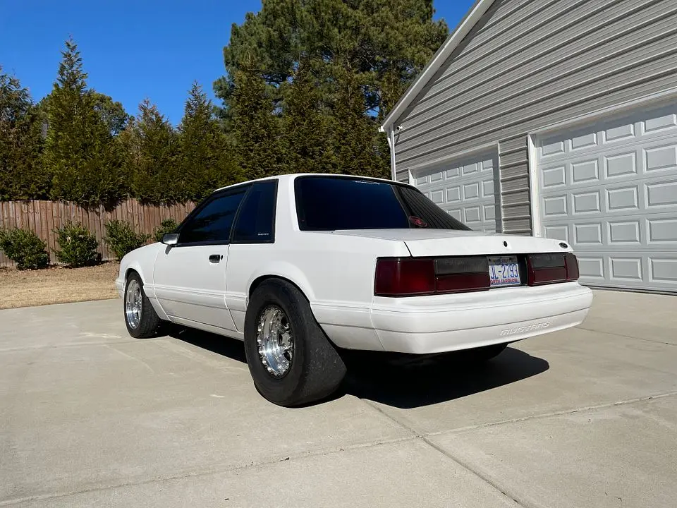

Bogart 15x10" wheels with 275-60 M/T pro radial.

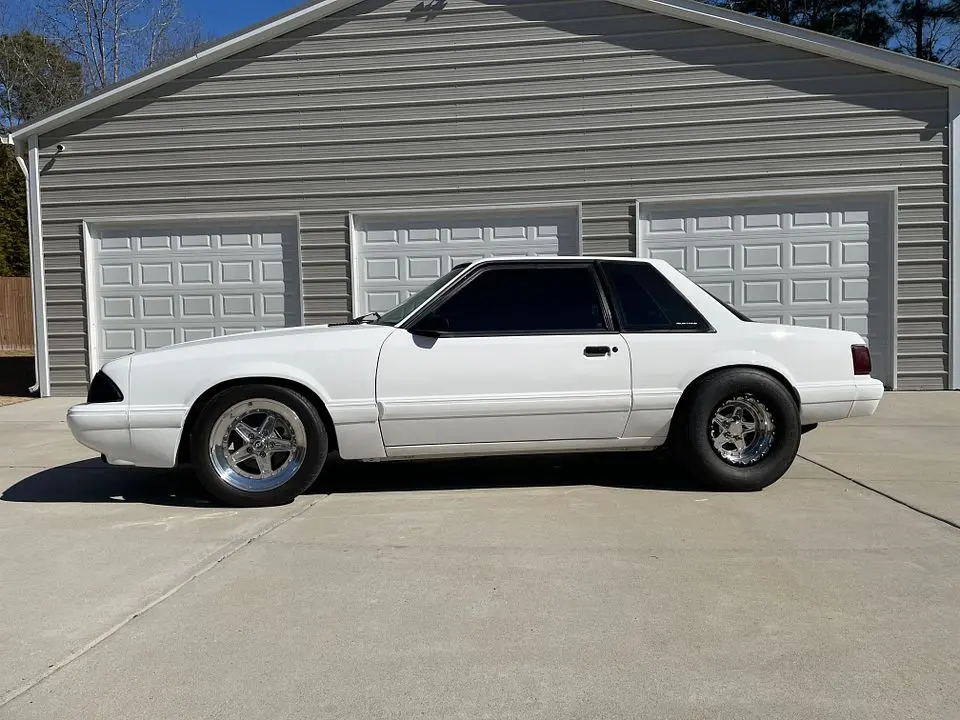

Did some suspension changes and also changed the wheels.
Trying to dial the car in and prepare it for the track.

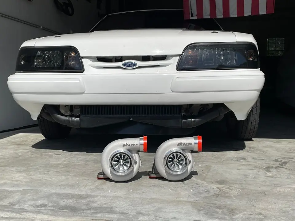

Picked these up for my 93 coupe turbo project.
Richard Holdener RHP800s comparable to GTX3584RS.
67mm, .82 a/r with billet wheels.
