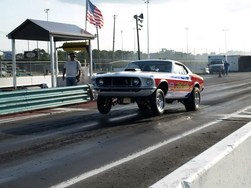

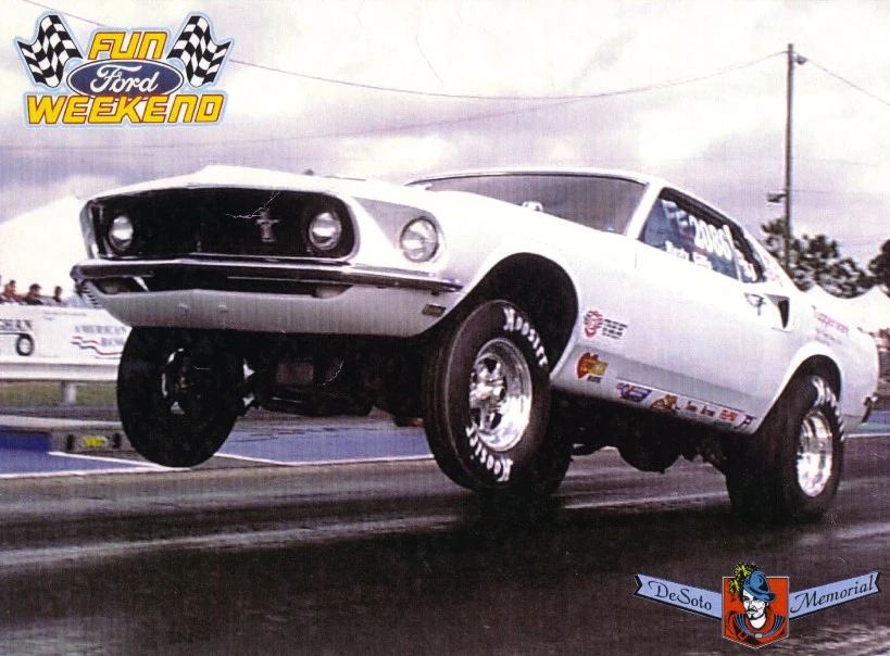

You can hook up and be consistent with CalTracks. I have them on my Mustang.
After the car was painted and on a bad track no transbrake and leaving from idle.

wow, thats a mess of rubber on the line.
