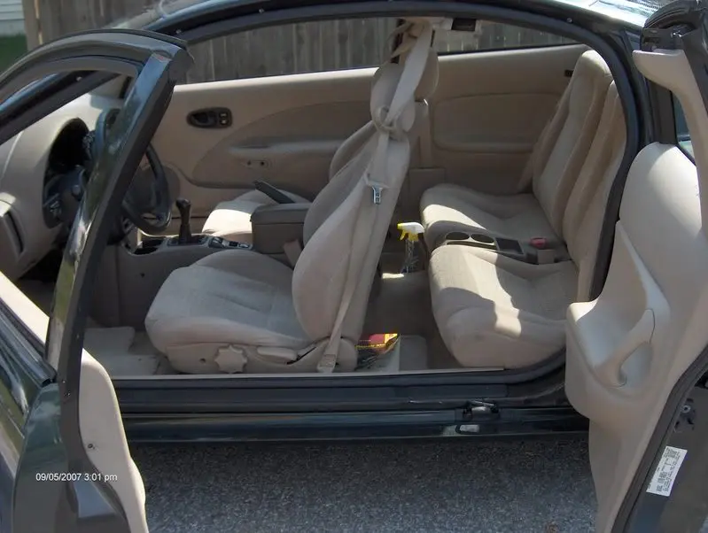

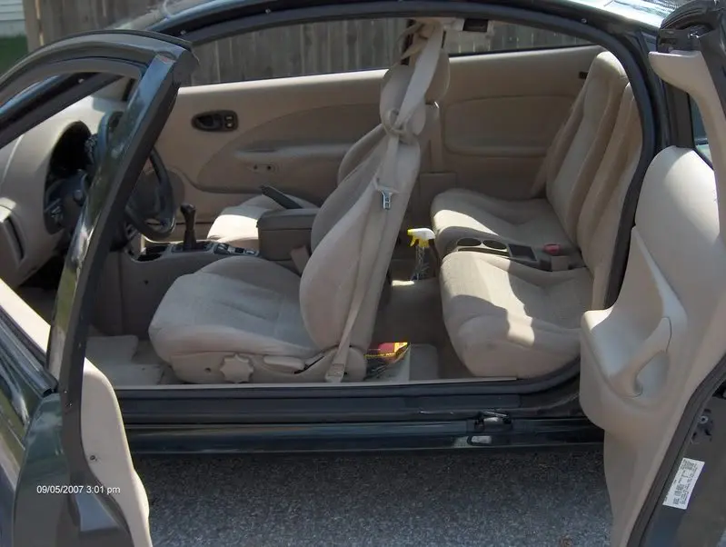

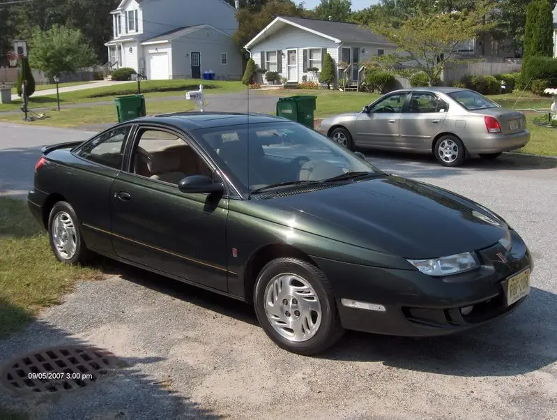

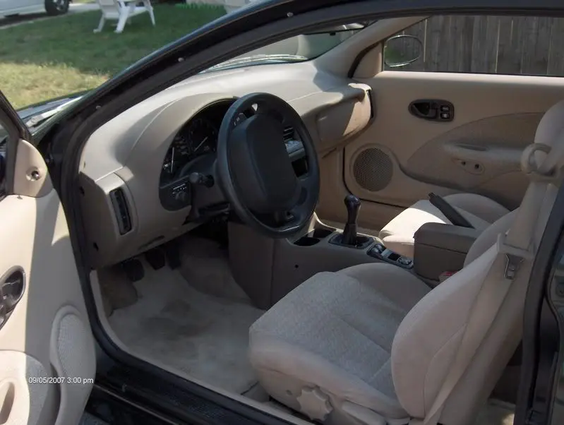

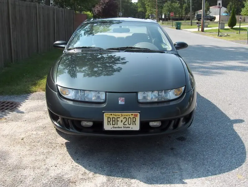

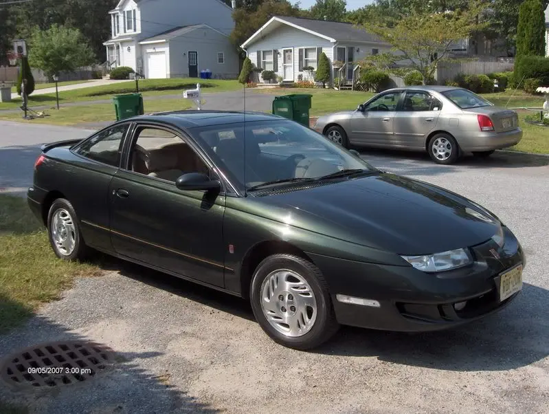

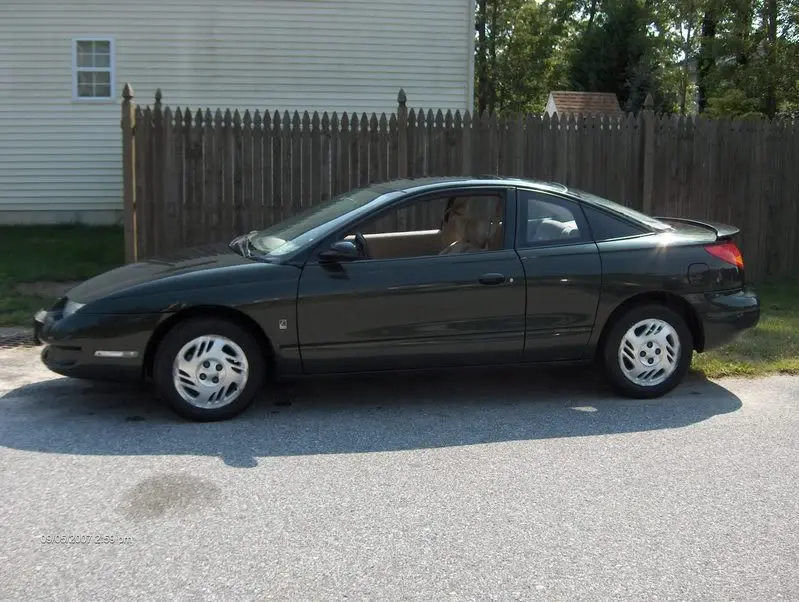

Hey guys... here is the saturn i picked up... it still looks decent its the SC2 1999 im the second owner aparently it looks good but shakes bad at idle other then that its a great car.... i havent noticed any smoke maybe just a tiny bit after its been sitting... but thats about it.... here is some pics and videos of the car and problems... I got it for only $1250 though.... talked the owner down from $2100 lets hope its an easy fix
So far i think it may either be iac or the EGR.... maybe a mount... it runs 2 nice to be a head problem and the coolant looks clean... in the second video when i slow down to turn you can hear a knocking sound... that isnt the engine... thats the muffler shaking...
