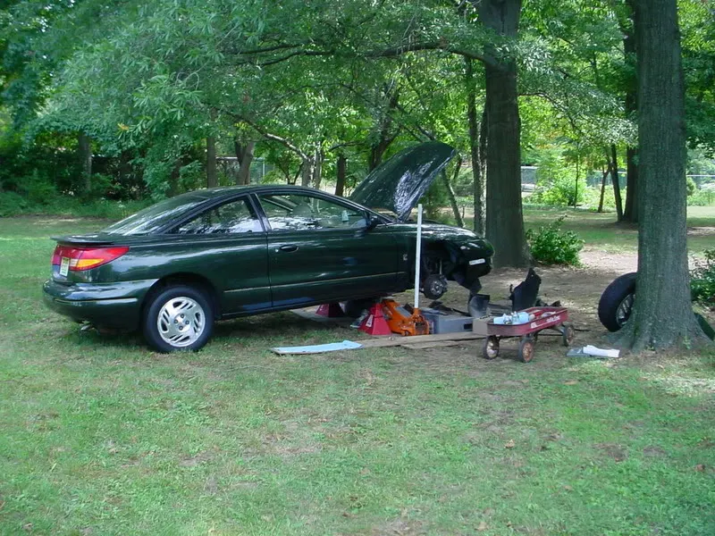

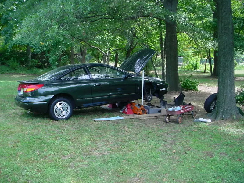

Well i put it out in a field under some treed and started pulling off the header and the intake manifold. I also pulled the battery out and the intake... i think im going to pull the head and check for a cracked head gasket... if i get over whelmed... im just gonna put a new engine in it i found one for $800 and another for $900 this way im still under $2000 for a good running car...

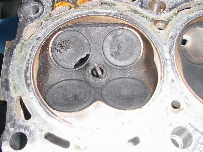

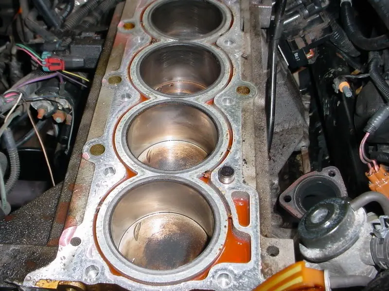

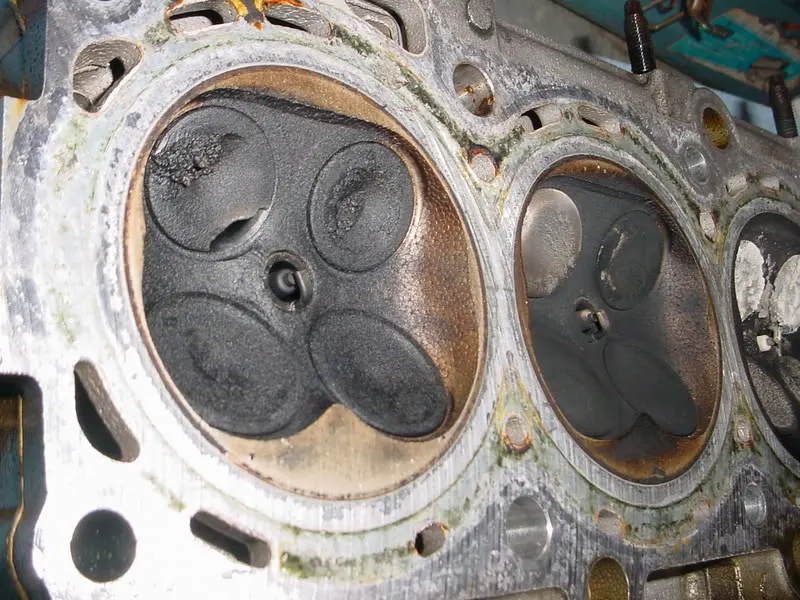

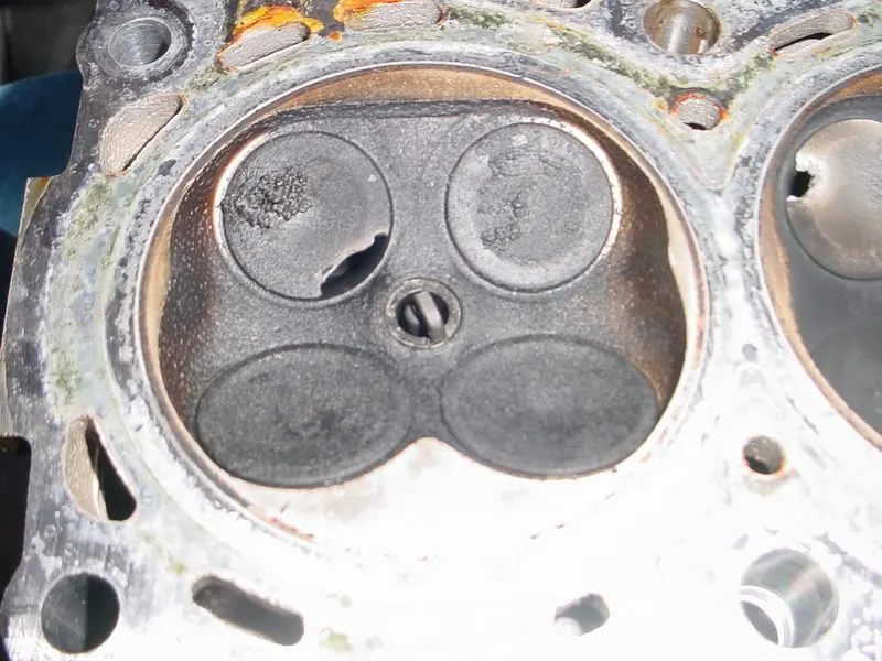

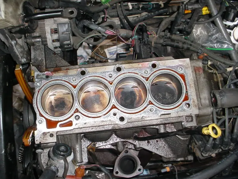

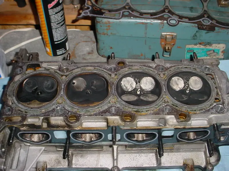

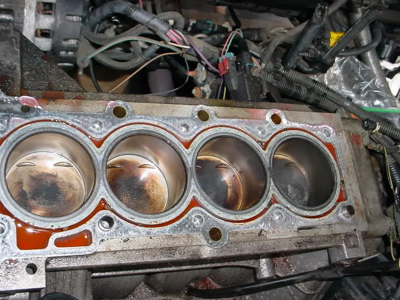

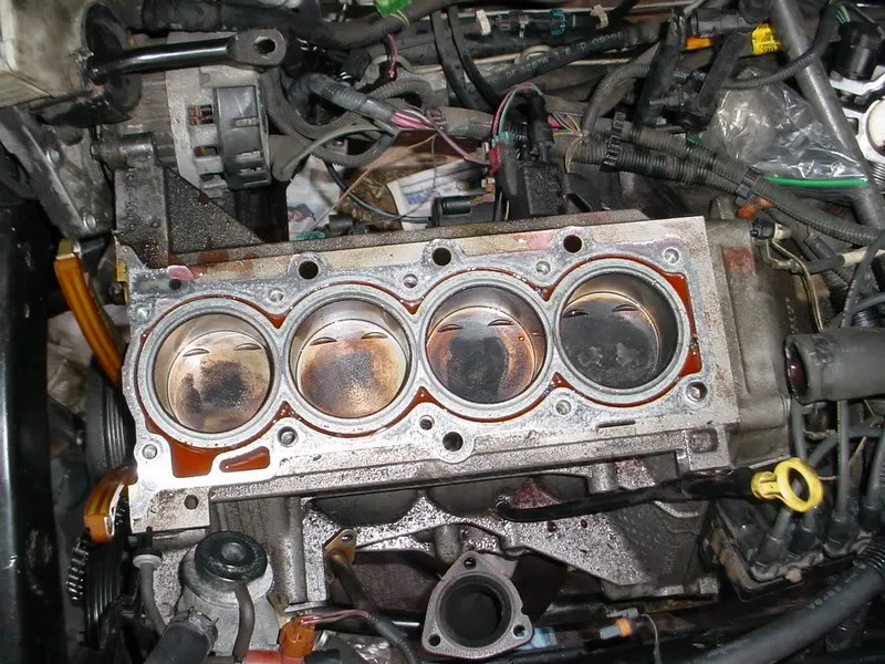

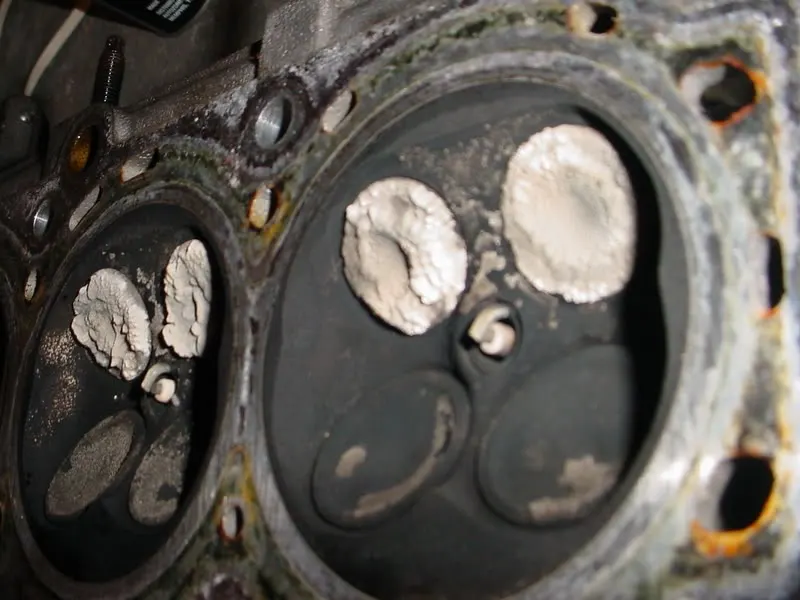

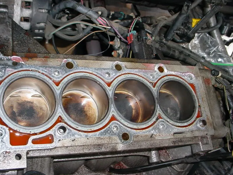

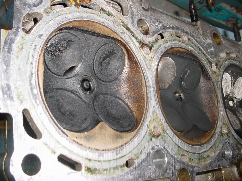

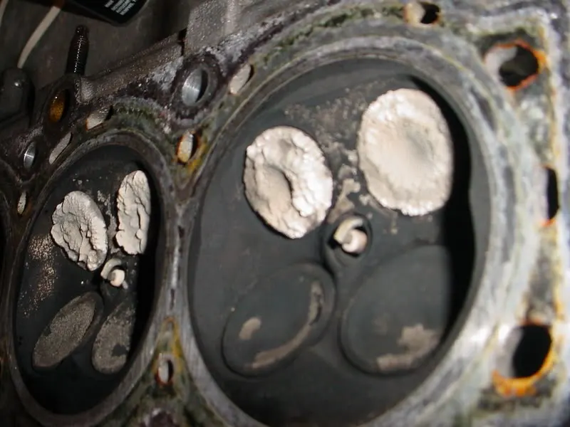

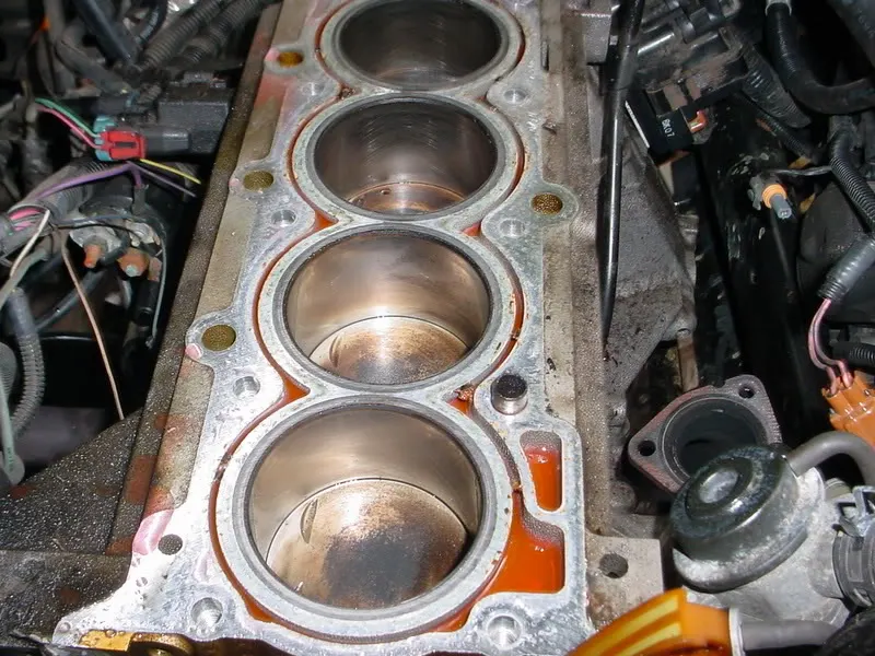

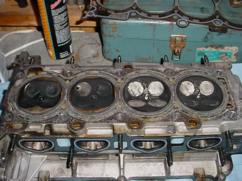

Problem Found... i took off the head and found 2 burnt valves... check it out... there is also a few scrape marks in the cyls of the engine where the valves were broke not really deep but i can feel them... other then that there is alot of cross hatching on the cyls and they look good... here are some pics... $250 to get the heads redone with new valves and preasure check and everything.... think i should do it?
CC #1
G]
CC #2
CC 3,4
Block
My garage

:banana: for the little red wagon in the last pic! :D
For $250 to get your head redone ... why not? Still way cheaper than you were previously expecting when you thought it might be the entire motor. Get the head reconditioned, maybe milled down, slap that puppy back together, and you got yourself a solid ride again. :nice:
