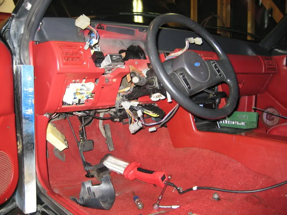

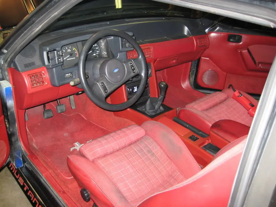

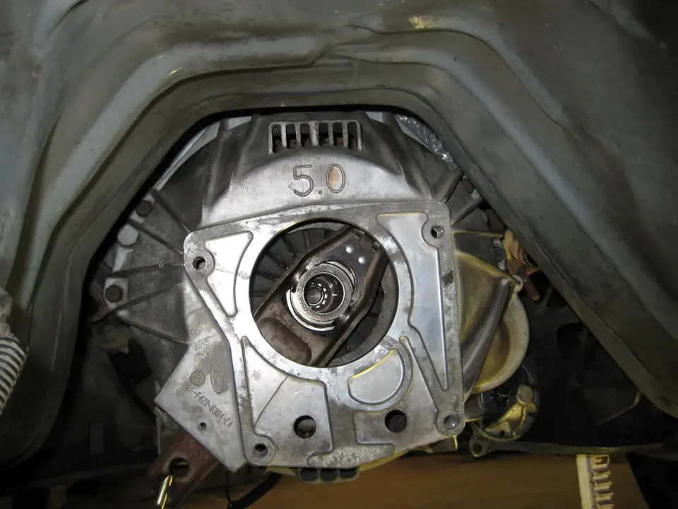

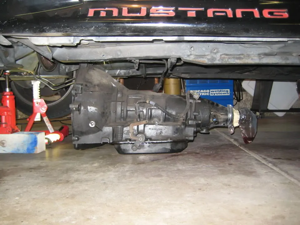

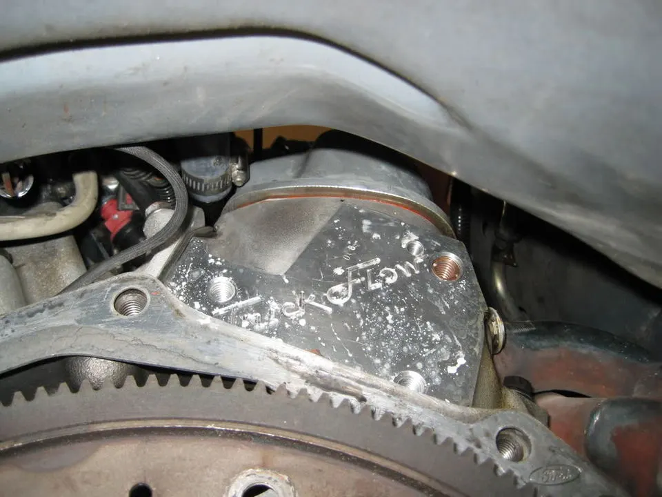

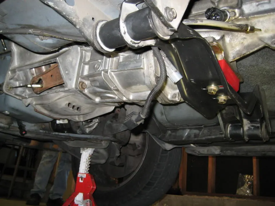

Just thought i'd upload a few pics from my swap. Best thing i've done for this car

sweet, i bet it made a huge difference. it did when i swapped my car over.

man that is way too clean of a floor for having just pulled an aod. mine ended up looking like we just pulled a dead body out from under the car, kinda like this:

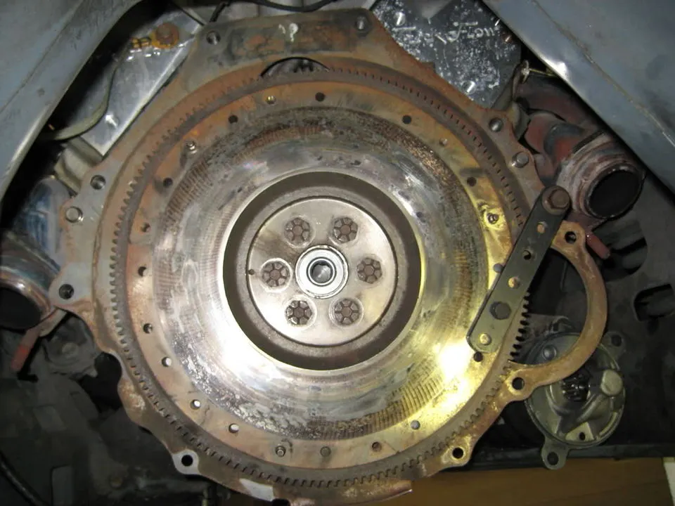

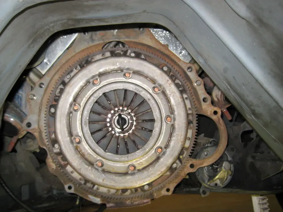

did you use a used clutch and flywheel? that flywheel looks like it needed a resurfacing very badly. I would not have put that into my car.

my brother totaled his ranger splash that had a 95 gt driveline in it. The clutch and pressure plate only have maybe 10,000 miles on them when we put it in his truck. We did resurface the fly wheel at that time, but he's obviously scorched the **** out of it. We weren't concerned because this set up was just so i can sell the aod and purchase my tremec with my tax return. Basically testing to see how much of a difference it would make. Its only going to be in the car about another month or two and its not daily driven. What do you guys think? TKO 500 or 600?

sounds good , as long as you plan on changing it soon, then i dont see a problem I would go with the 500, or find a used t56.
