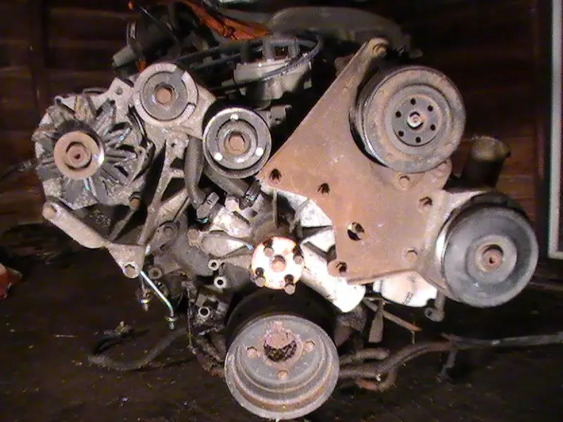

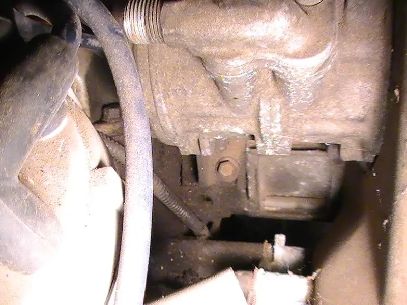

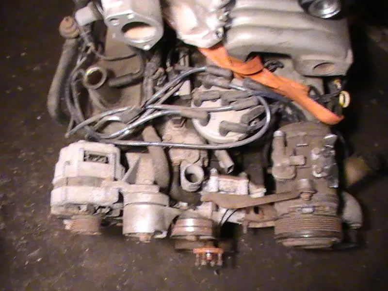

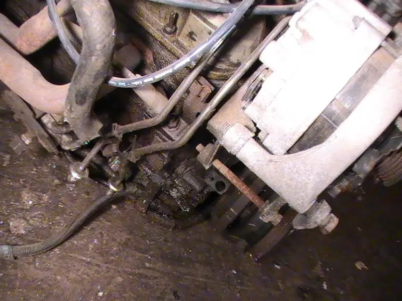

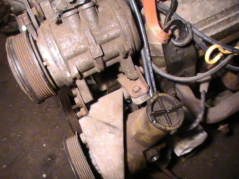

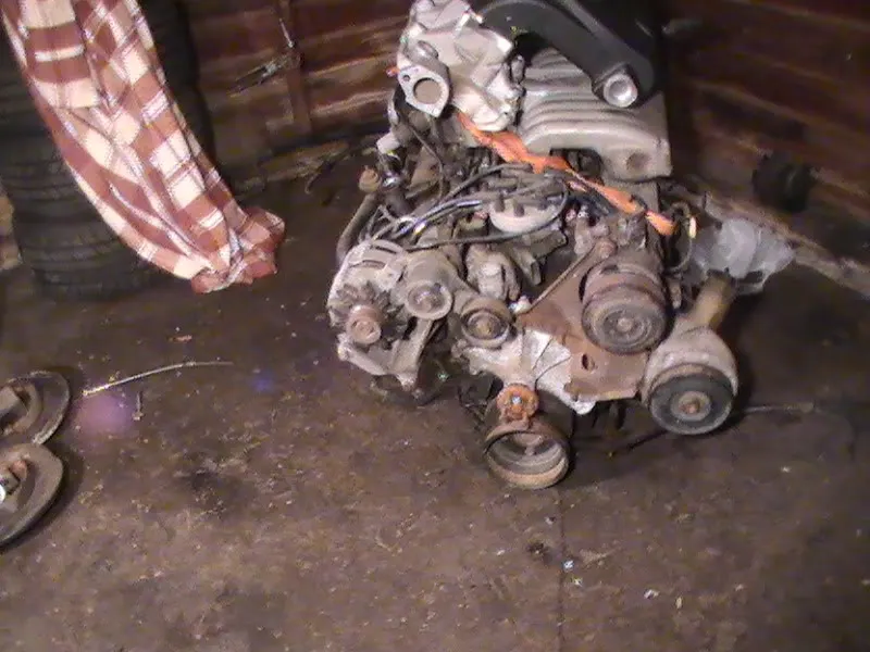

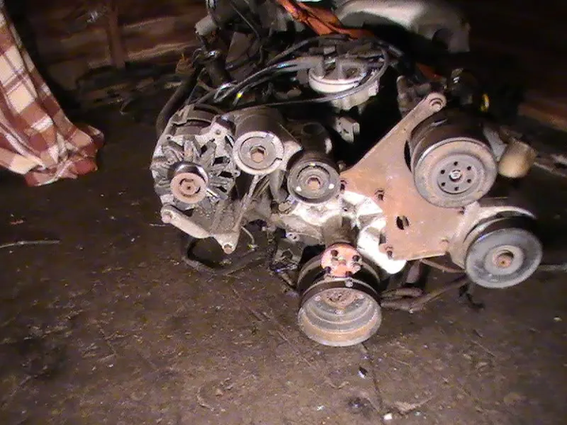

I need a few pics of a 5.0 out of the car with all accessories on it. Does anyone have that or know where i can find??
Just really need to see how all of the brackets go on etc...
also, does anyhing connect to the bolt/studs that come off the timing pointer?
Thanks

Well I don't have pics like that but I live in Dallas GA but work in the woodstock/acworth border. You are more than welcome to come take a look just let me know when you want to swing by and I'll try to find my other timing pointer bracket thingy and you can have it.
Oh.. you just need to know if anything attaches to it... let me go look. OK, the bottom bracket/bar of the smog pump attaches to that. However, you do not need to have that on there to install that piece because it installs on top of the timing pointer.

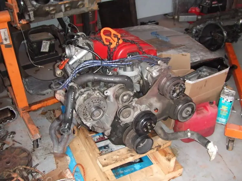

hold on.... I have one in the garage.... give me 5 minutes or so....

If you need something more specific I will see what I can do....
90, so i can use an aftermarket pointer without the studs and still have the smog pump?
thanks all for the pics..
