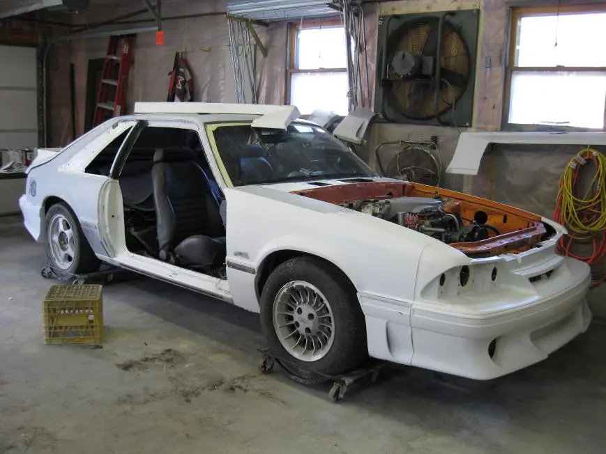

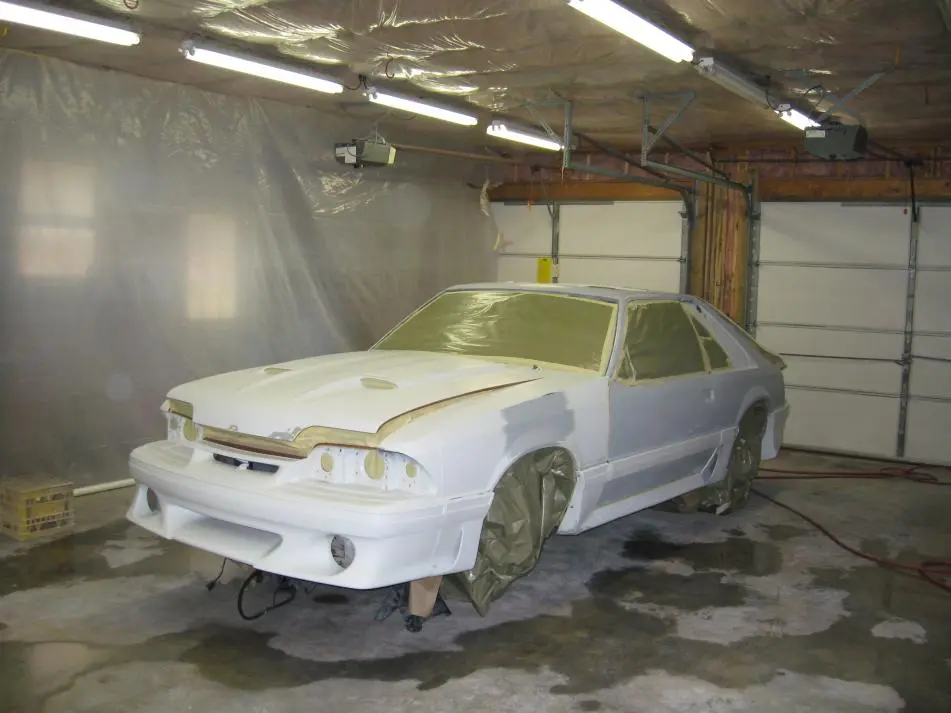

pics of my car getting ready for paint

If i were you, I would pull the ground effects and bumper off and paint them seperately. You may have a delaminating issue where they meet up with the body.
Just my $.02.
Actually bad idea. Painting parts off the car (believe it or not) can result in color mismatch, especially if you're using a pearl or metallic in your paint.
