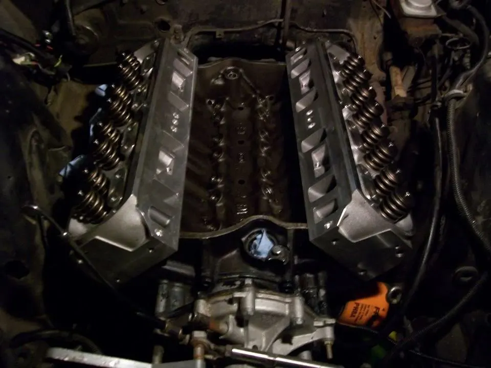

I started my heads/cam swap. Just waiting for a few more parts to come in now.
Snapped these.

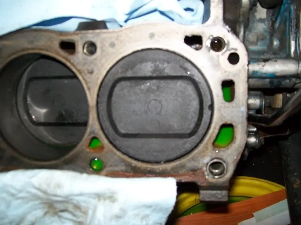

Now for the question. Is this thing going to be a dog with these stupid pistons??
I wanted to :barf: when I pulled the heads off and saw that.
The dish is huge, it's almost a 1/4 deep, I think I mic'd it at like .23" or something like that. I'm thinking the compression could be as low as 8.8 or 9:1. Almost makes me want to put stock stuff back on.:mad:

Same pistons I have in my mach. I have stock 69 heads that I ported a bit when I was really young. Small solid flat tappet. perf rpm intake with 1 5/8 headers. It runs mid to high 12's. Runs great. Leave it alone, it'll run great with the new parts. BUT, AT LEAST run the xe cam or go custom for a few more $'s.

Look at it this way, you'll be able to use pump regular.
Even the stock 351 4V had flat tops, but I'd be surprised if you're losing more than 15-20 hp.
If it really bothers you, spend a couple hundred on flat-tops.
Of course you're still going to measure PTV clearance, and check your valve train geometry, right?? Installed spring height, etc, etc.....
Nah I'm not going to worry about it, I'm going to put it together and enjoy whatever it gives me. At least it will be faster than it was.

If pulling the engine and installing new slugs is not in the cards, then just leave it alone. It's still going to be a strong runner. Besides, you can't miss power that you never had, right? ;)
You're right, that's what I'm doing.

Oh and for Brianj5600, I stuck in a cam I had laying around with the same duration, but with .512/.513 lift as opposed to my cam's .541/.544 lift, and clayed the piston to valve clearance, and with the clay at .6 thick the valves never even touched the clay, so .......... I don't know if you caught it but in my first post I stated that the dish is about a 1/4 inch deep..
I was not trying to insult you. I was short on time. The pistons I have seen that have reliefs for TW and inline valves look like it would put the valve where it hit the top of the piston and not the dish area. I am sure you will check again once all the parts come in.
Sorry, I misunderstood you.
I actually thought that also, with the valve being relocated like it is, so that's one of the reasons I checked it. I think the dish is just so big that the valve is still coming down over it anyway. My friend was trying to get me to not check it but I'd rather be safe than sorry, and I'll check again when the actual cam I'm using comes in.

The deep dish in your pistons is in the center, where the valve reliefs would be.

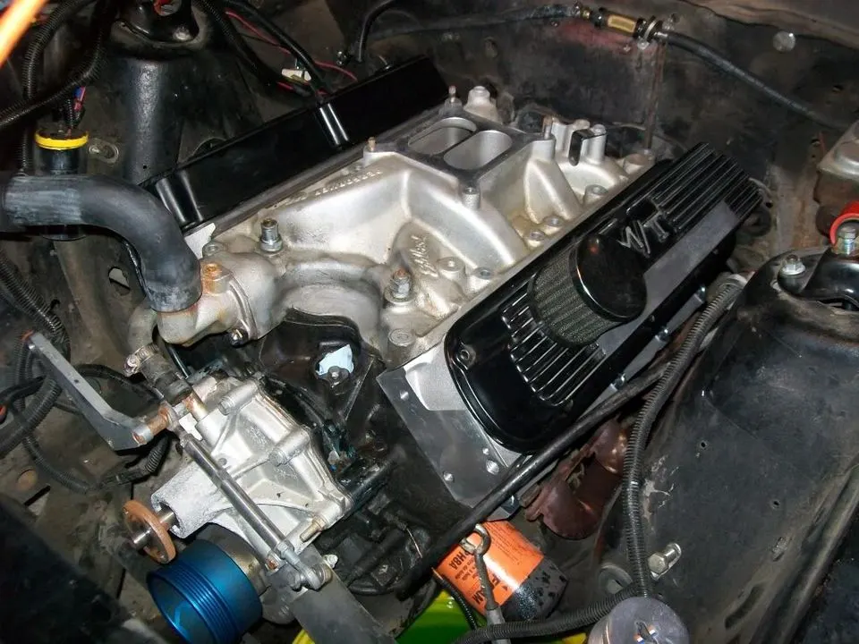

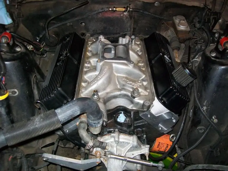

I've got the heads torqued down, cam and lifters in with the timing set on, timing cover, water pump, balancer, alt, pullies, brackets, radiator, back on. It's starting to look like an engine again.
Tomorrow while I'm waiting for my pushrods to come in, I'm going to put on the headers, intake, carb, and distributor, and change the oil. Then it's just putting in the pushrods and adjusting rockers.
