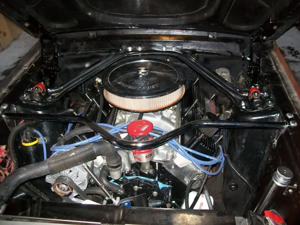

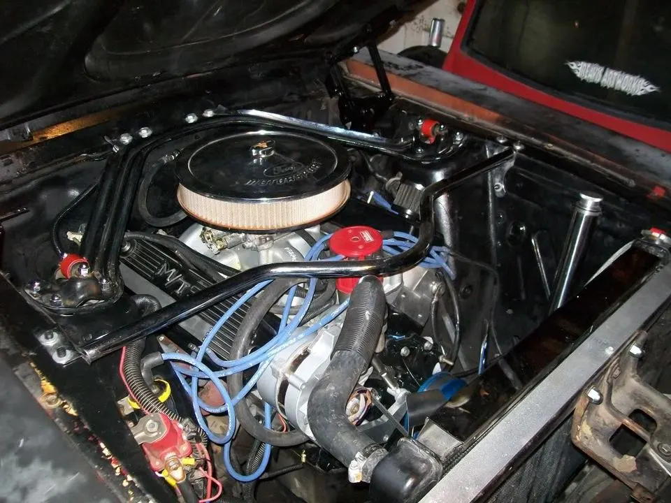

It's coming! I'm waiting on photobucket. I've got some pics and vids, though vids are from my digital camera so the sound just doesn't do it justice.
Here's a couple of pics.

I thought I was the only one with M/T valve covers these days.
