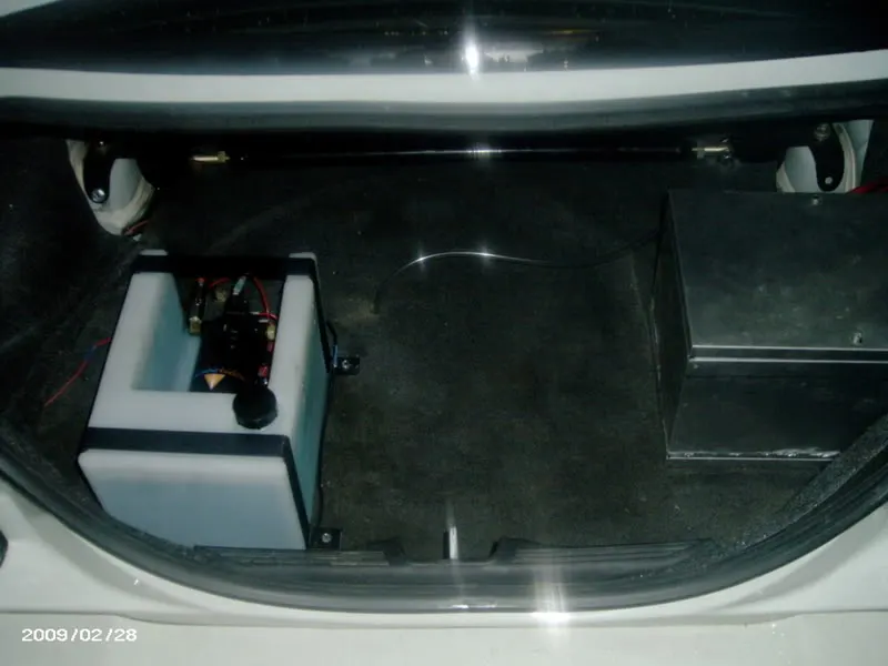

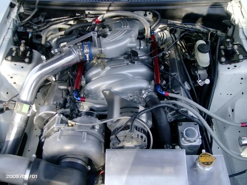

Here is the mod list
Engine
18cc manley pistons .020 over
Modmax 4340 H beam rods
Kellogg cobra crank
ARP main studs
ARP head studs
Felpro performance gaskets.
Stage 3 Patriot heads
CMS stage 3 blower cams
MMR cobra oil pump
Canton 7qt oil pan
TFS Trackheat intake
Solid motor mounts
Exhaust
Mac longtubes
Cam o/r H pipe
Slp loudmouth 2 catback
Poweradder
Paxton Novi 2000 race version
3in RR pulley
Innovators west 10% OD crank pulley
Ebay 4in intercooler
3in custom welded intercooler piping
ProM MAF
Mondo bypass valve
AIS meth system
Ignition
weaponX COP
3 step colder ngk plugs
Fuel
Custom sumped tank
A1000 fuel pump
100 micron filter
10 micron filter
-10 feed line (to Y block)
-8 feed line (from Y block to rails)
Aeromotive fuel rails
60lbs injectors
A1000 bypass regulator
-6 return line
Cooling
Meziere electric water pump
180* Tstat
Mishimoto aluminum radiator (fabricated to fit)
Brakes
Linelock

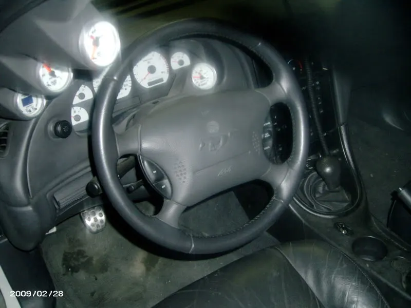

Gauges
Autometer C2 wideband
Autometer C2 fuel pressure
Autometer C2 oil pressure
Autometer C2 boost
A pillar triple pod
Steering column single pod
Front suspension
QA1 kmember
QA1 coilovers
QA1 adj struts
Steeda bump steer kit
4 bolt cc plates
Rear suspension
Megabite jr. lower control arms
Baseline suspension pro launch upper control arms
Baseline suspension antiroll bar
QA1 adj shocks
QA1 coilovers
CHE shock tower brace
Welded torque boxes
Rear end
33 spline moser axles
Spool
4.10 gears
C clip eliminators
Welded tubes
CHE axle brace
Wheels
17x9 black chrome 03 cobra (front)
17x10.5 black chrome 03 cobra (rear)
Exterior
01 cobra front bumper
Paint matched mirrors
03 cobra rear bumper (waiting to be installed)
Drivetrain
Spec stage 1 clutch
Aluminum driveshaft

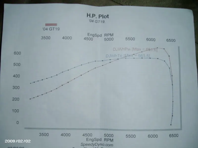

That car is freakin awesome!! :rock: :nice: Killer power numbers too, really like how she takes off. And the sound is :drool:
